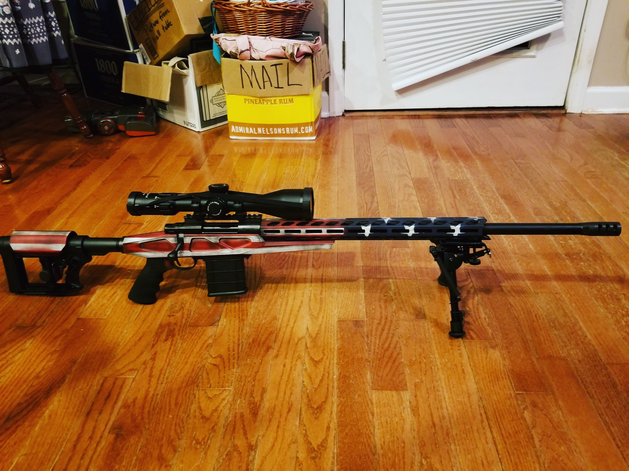

So after some cost running I ditched my build and picked up a Howa APC package painted like an American flag, ill post pics soon as I get home. But now I have questions before I shoot it. All of my cleaning rods are brass as I have rarely cleaned down the bore of a rifle before, most of my guns are hunting guns and they work just fine without a bore clean. So for the 6.5 I am going to pick up a tipton rod and guide for it. What else will I need? Especially for the break in? Or should I even break it in? Whats your favorite cleaning gear for your rifles? Thanks in advance

Do i NEED ammonia? I ordered some Hoppes number 9 bench rest copper solvent because I heard ammonia can eat at the barrel too and this was more gentle. Would it work for the break in? Anywho here she is
