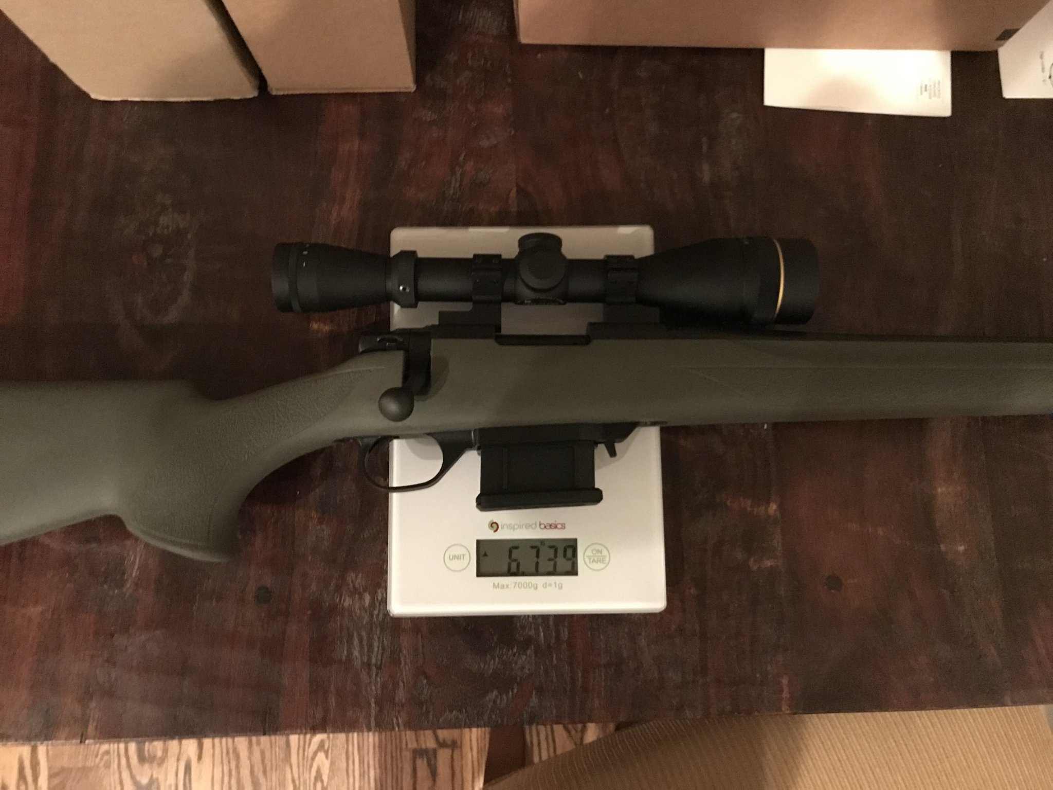

Here’s my Mini in 6.5 Grendel. Ultralight 20” pencil barrel, trigger tuned down to ~2.5lbs, Tally lw rings and a light Leupy 4-12x40 on top.
It’s my mountain/hiking rifle (or was before I moved from CO to the Midwest, ha). Under 6.5lbs with a loaded mag.

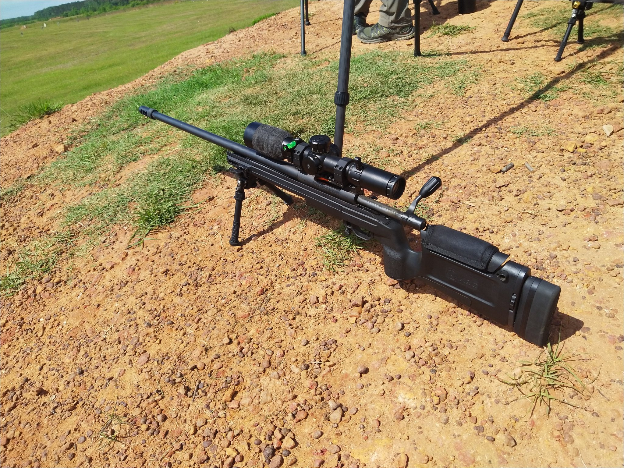

Here's my 6mm creedmoor Howa bravo at last weekend's guardian match at arena training facility in Blakley, GA. It's got a area 419 hellfire break, Talley 20moa rail, seekins rings, and a Bushnell hdmr 2 scope. Thing is a hammer, I on the other hand am a work in progress.

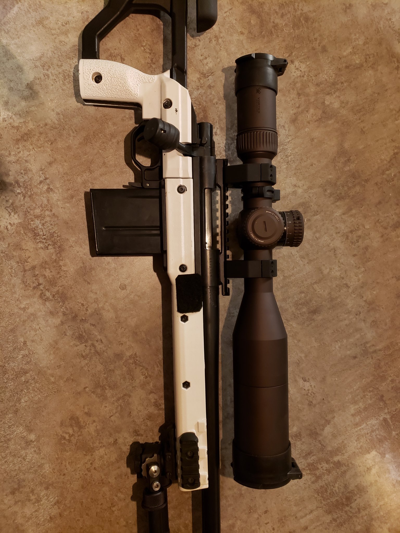

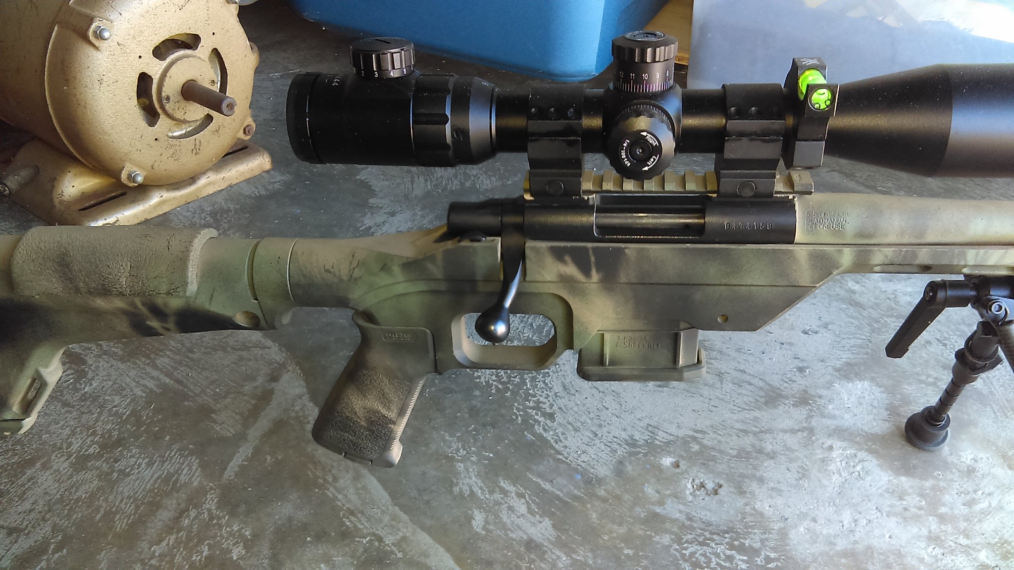

I have HOWA 300wm barreled action in a MDT chassis. I like the action very smooth would like to change the trigger out to a flat one. haven't shot it yet, no glass yet

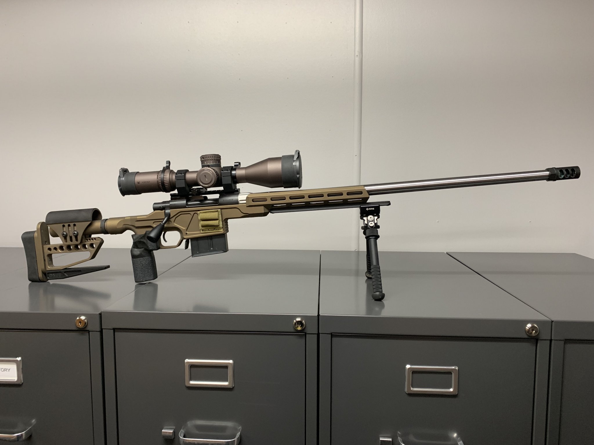

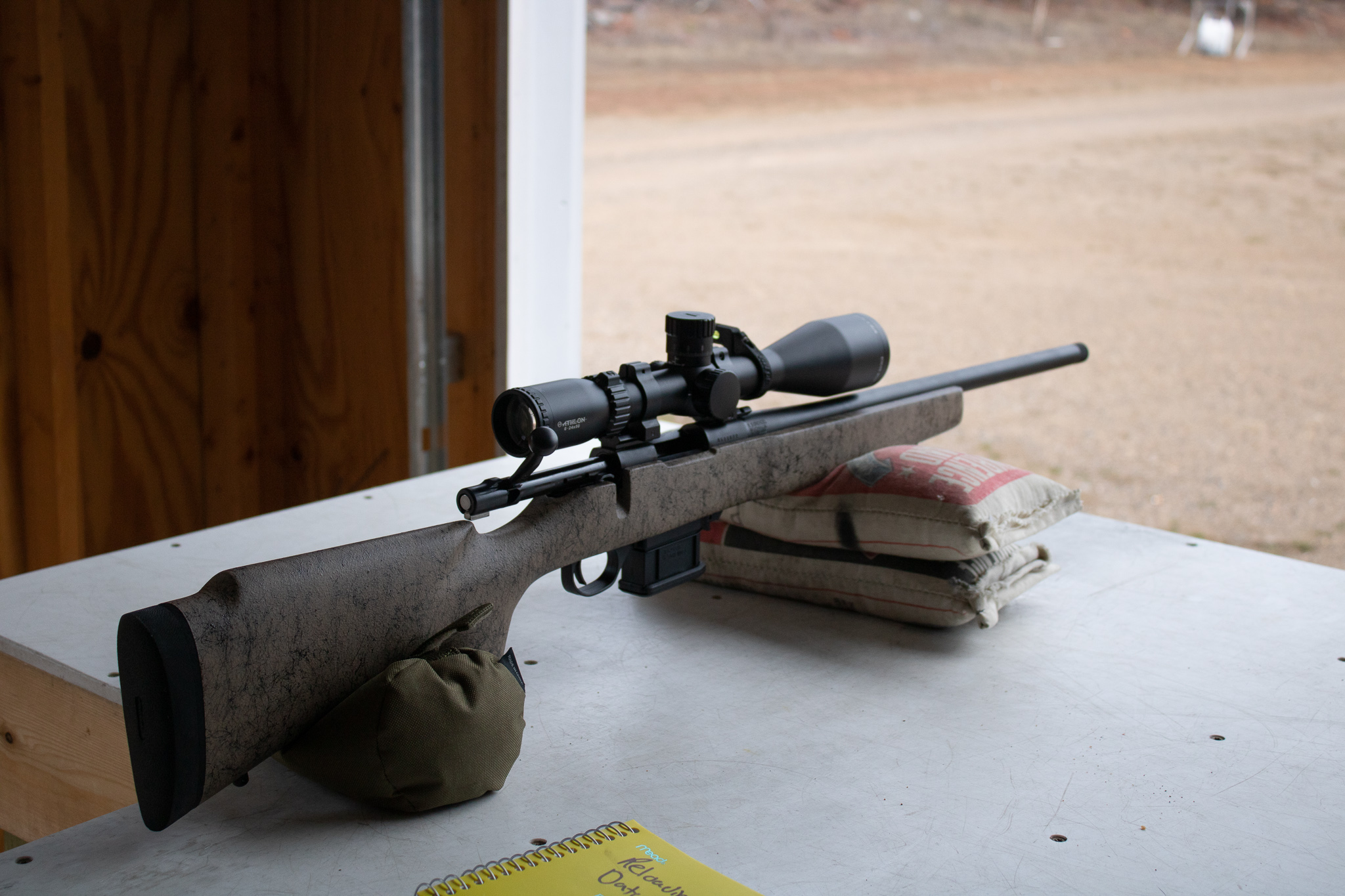

Time to update my post from above! New burnt bronze cerakote!
6mm Creedmoor, Criterion barrel, HCR/Accurate Mag chassis, XLR tactical buttstock w/ bag rider, Henderson Precision Arca rail, Timney trigger, Razor 2, Seekins rings, MPA grip, Badger bolt knob. .5 moa groups with 115 DTACS and H4350

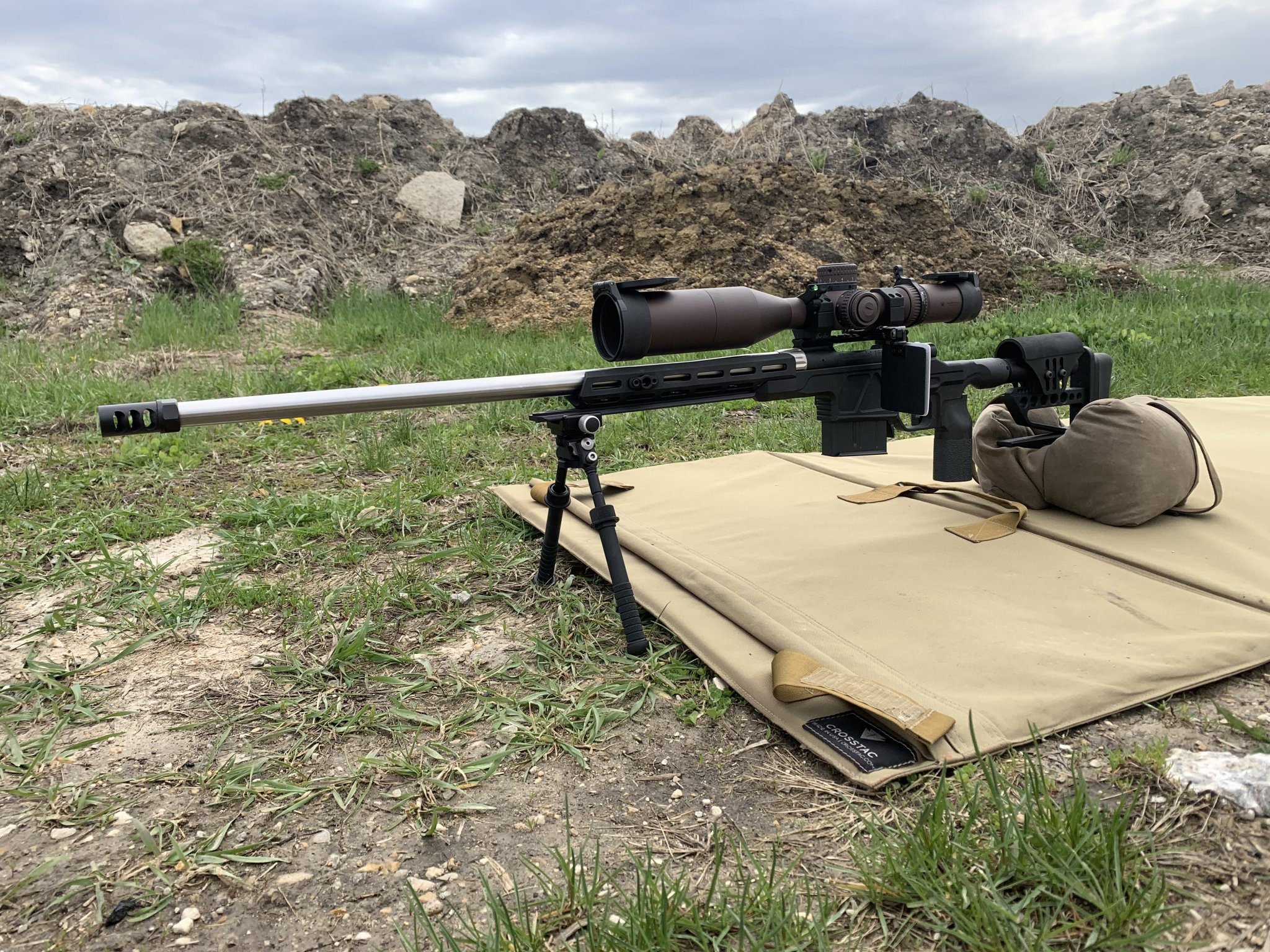

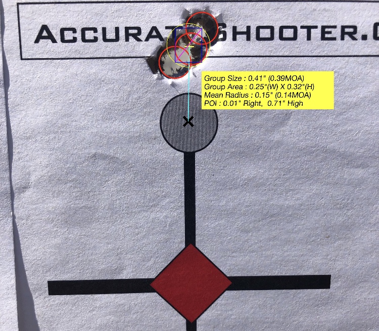

Finally got my new build to the range. Shot 0.6 MOA at 100 yards with factory 147 grain Hornady Eld M. Very happy. Can’t wait to see what I can get hand loads down to.
Howa 26” 6.5 CM
KRG Bravo
Timmey Trigger set to 2 lbs
Seekins Rings
EGW Steel Base
Athalon Eres ETR Scope
APA Muzzle Break

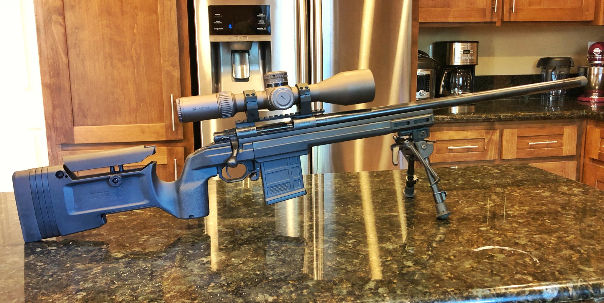

I just picked up a new Howa 1500 308 for $350 from a local gun shop and found a used KRG Bravo for $350. As long as it can shoot FGMM under 1” I’ll be a happy camper.
Took the HACT trigger down to 1-1.5 pounds and scope base and rings are in the mail.
Once I get it all put together I’ll post some pics and range photos.
- KRG Bravo
- Burris XTR 25 MOA Rail (bedded)
- HACT Trigger Job - 1.5 coils cut
- Vortex Razor G2 4.5-27x56mm
- Vortex PMR 34mm 1.26" Rings
I have Vortex Defender caps in the mail and will be sending the bolt to Short Action Customs for their bolt knob modification.
The action feels great and is very smooth. I'll be doing some load testing next range day and am hoping the groups tighten up.

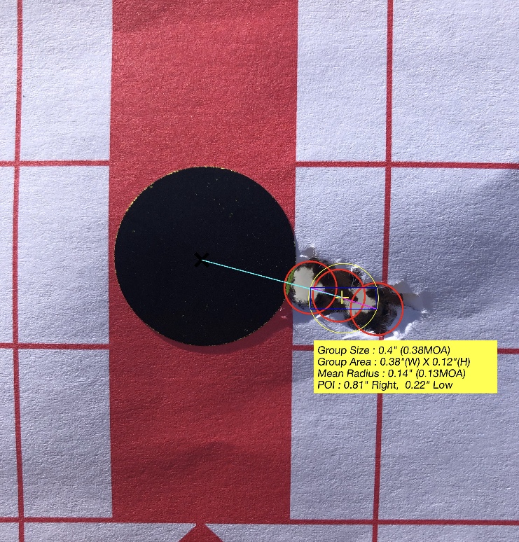

First round of hand loads last week with Howa 1500 rig posted above. 42.6 gr H4350 Hornady 147 gr ELD Match loaded magazine length (2.212 ogive), 26” barrel shot 0.4 MOA 5 shot group. Fine tuning and moving out to 300 tomorrow if the weather holds up

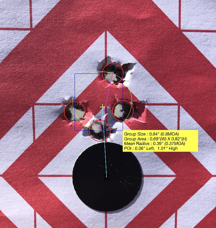

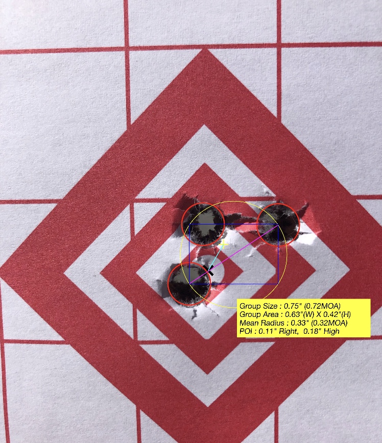

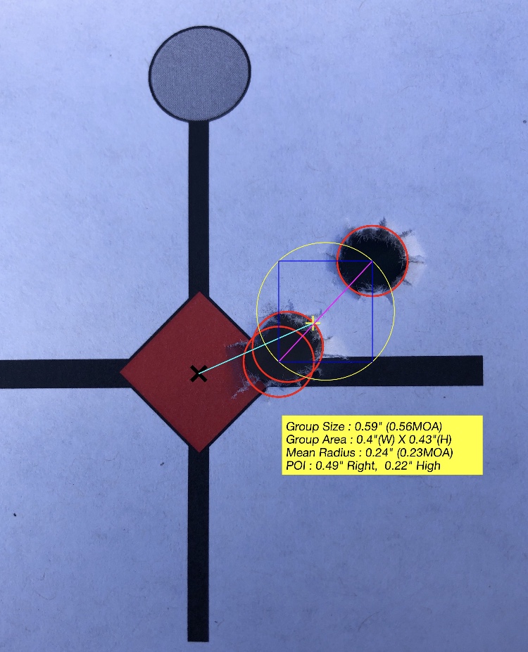

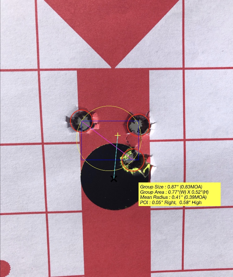

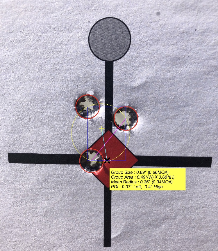

Went out for this morning for the second range session. The barrel has finally settled in after 60 rounds and is now grouping consistently.
All below groups were Federal GMM 168gr.
Prvi 308 Match was inconsistent and went from 1/2” to 2” with sporadic flyers.
Black Hills 168gr was around 1.5”.

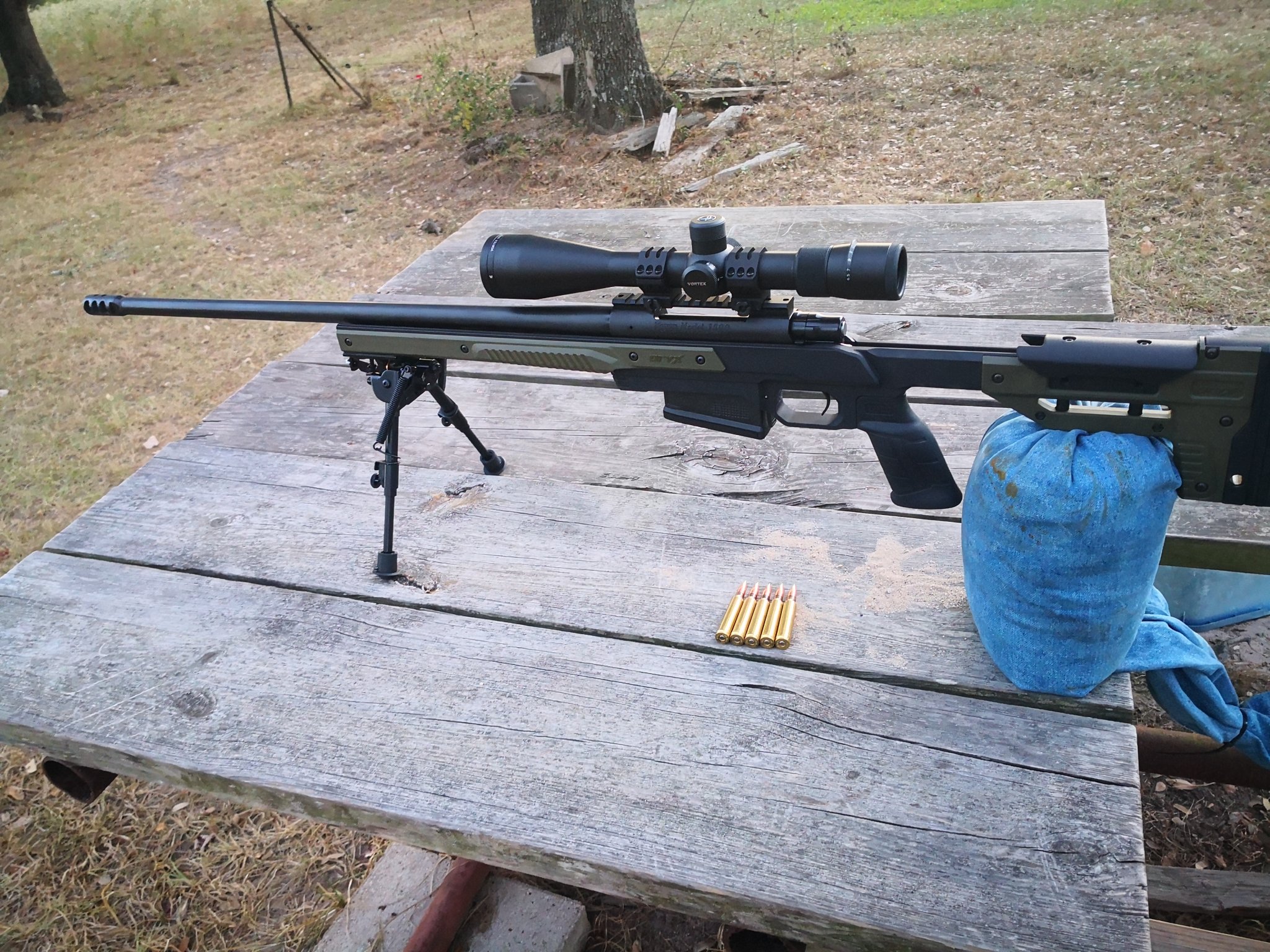

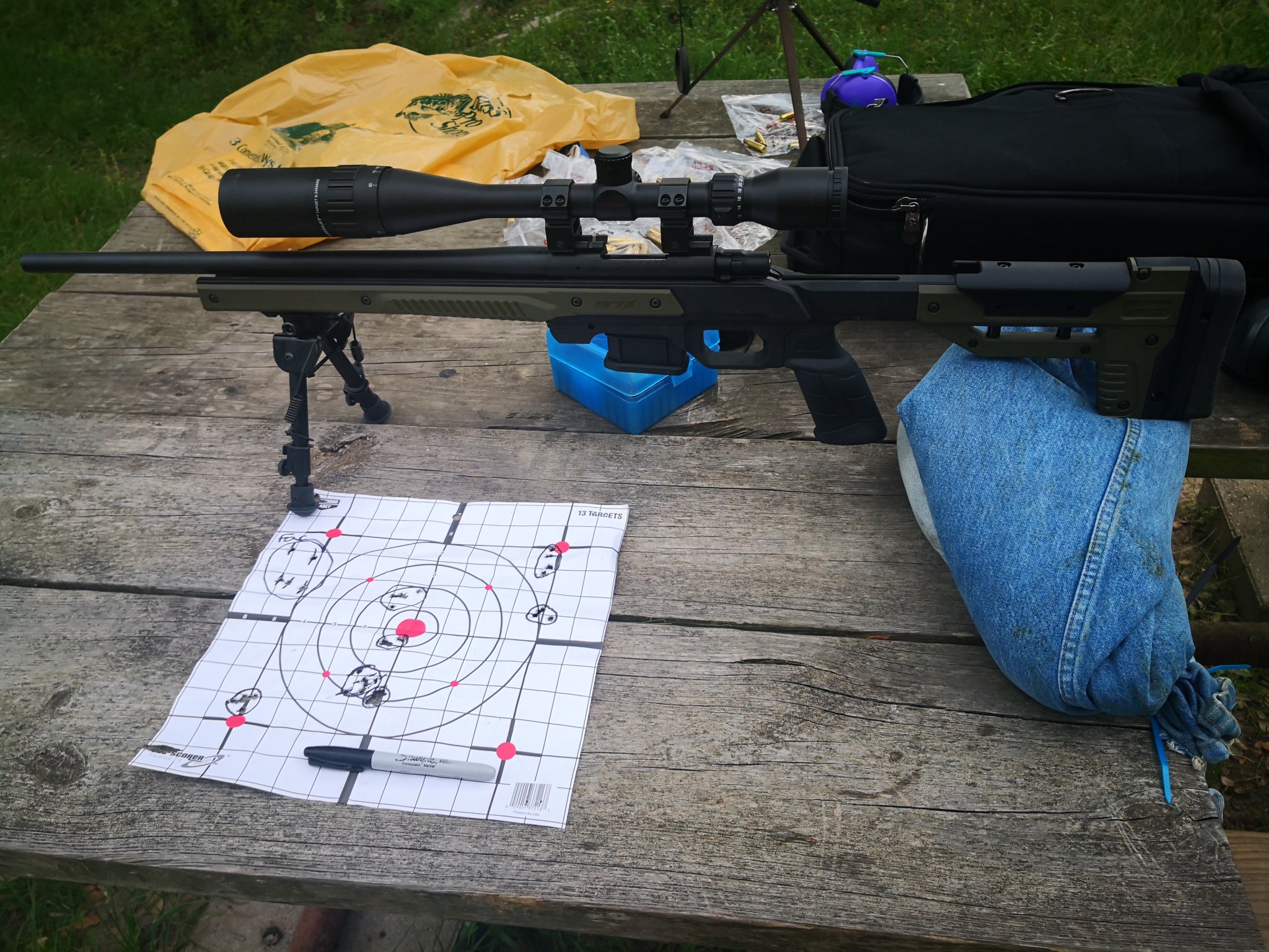

I know I'm late to the party ty but here's my howa miniaction 222 Remington and 300 win mag
Both have oryx chassis, the 300 has a 26" factory barrel and vortex viper 6.5-20x50, and the 222 has a 20" heavy factory barrel with bass pro pursuit-x1 6-24x44 scope.
