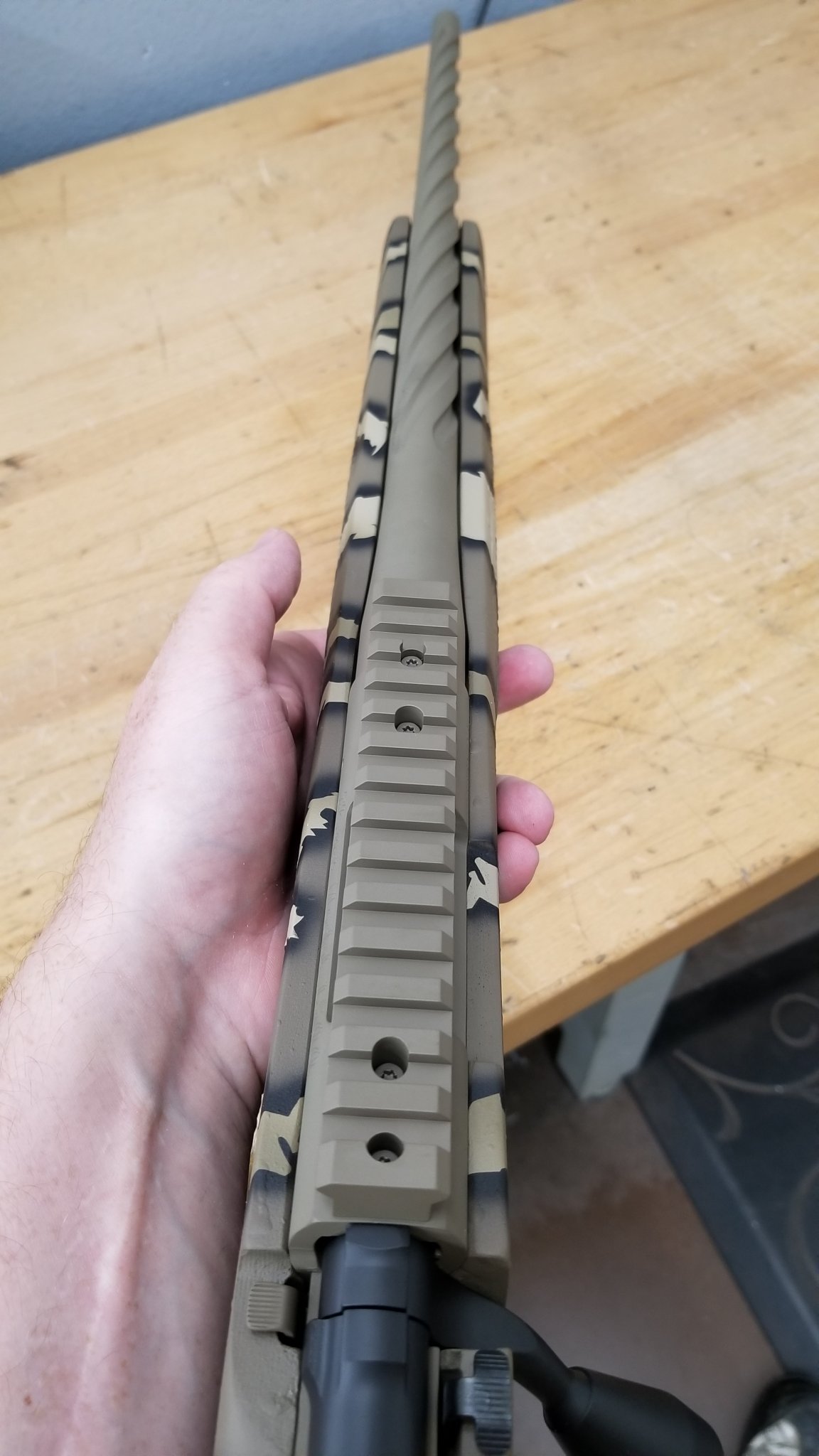

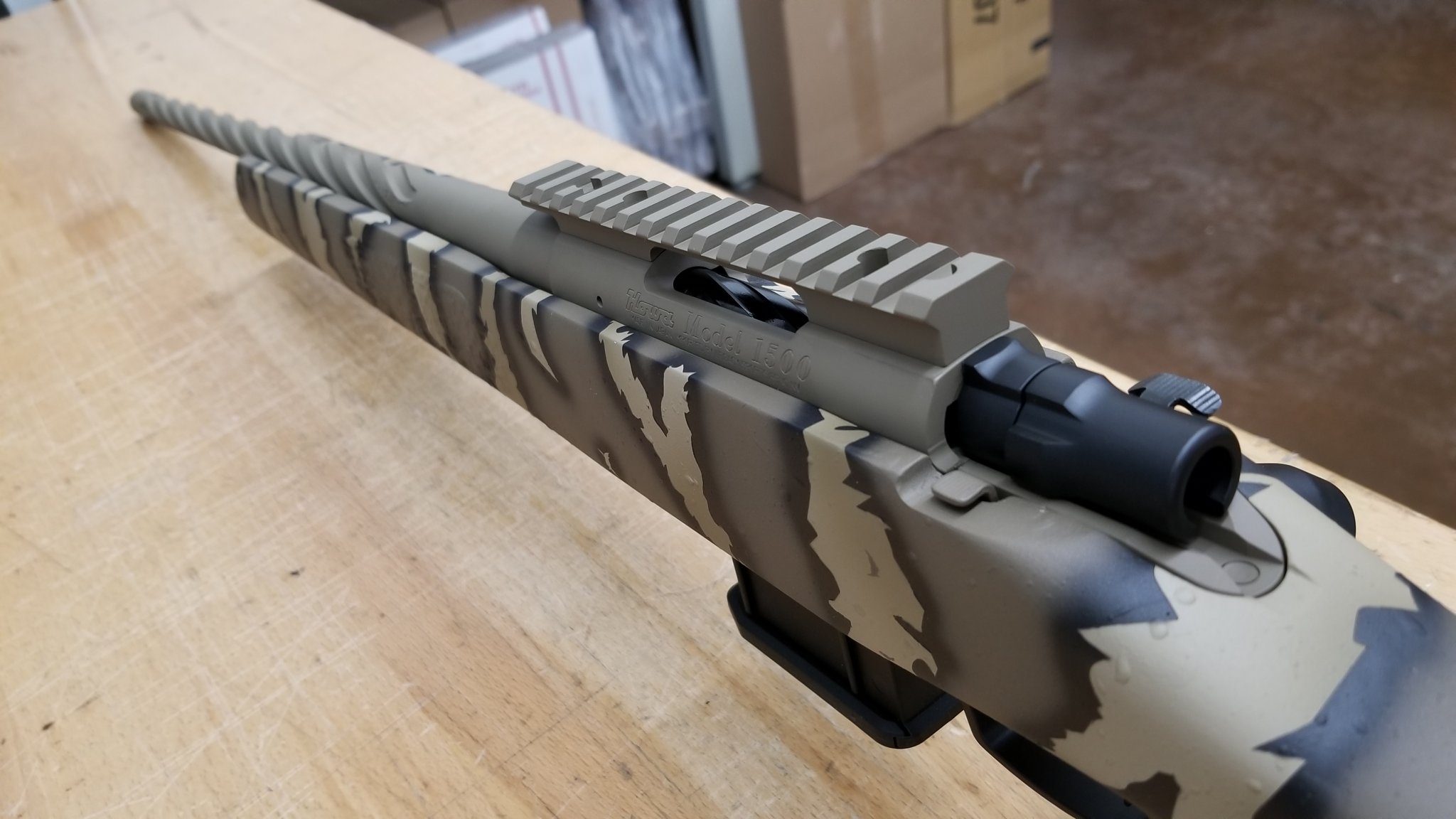

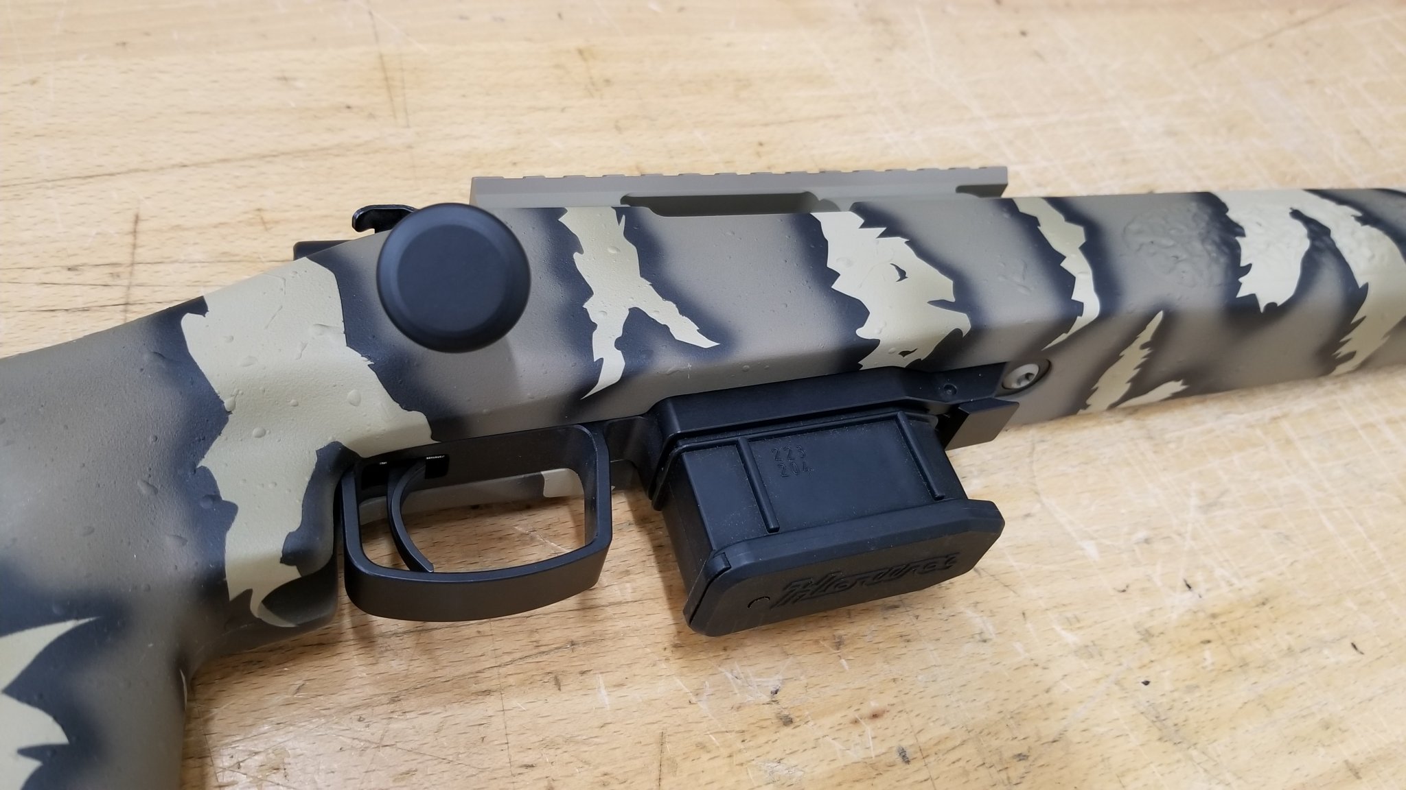

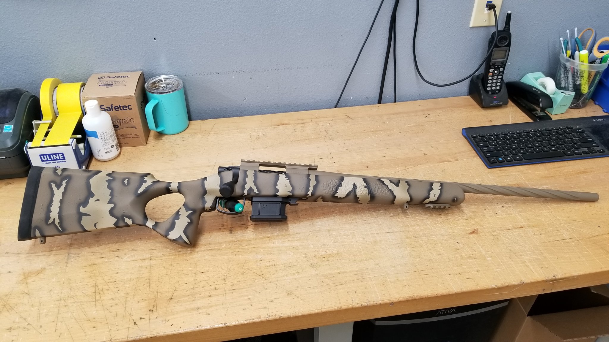

    The word I get is that the more popular aftermarket composite stock companies have elected to avoid the Howa Mini 1500 action. My suspicion is that doing so would require some significant costs with retooling molds as the tang geometry is a fairly large departure from what is typical these days.
    So, smelling fertile soil, we dove in headfirst to see what it takes to make it run. Our little FB LRI "Clip of the Day" vid covers the cliff notes on what we have going on and how we got there. As mentioned, the tang took a little work to get right. Fortunately working with composite materials is a low-risk thing for us.
    The stock hasn't gone to finishing yet, but the heavy lifting is all done now. Kinda cool. We'll be adding this to our lineup from here out.
    Thanks for looking.
    C.

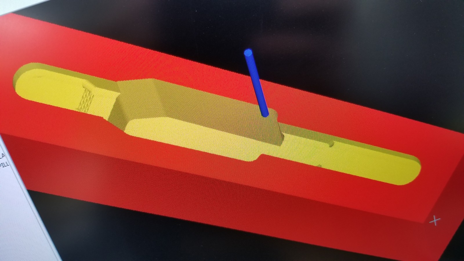

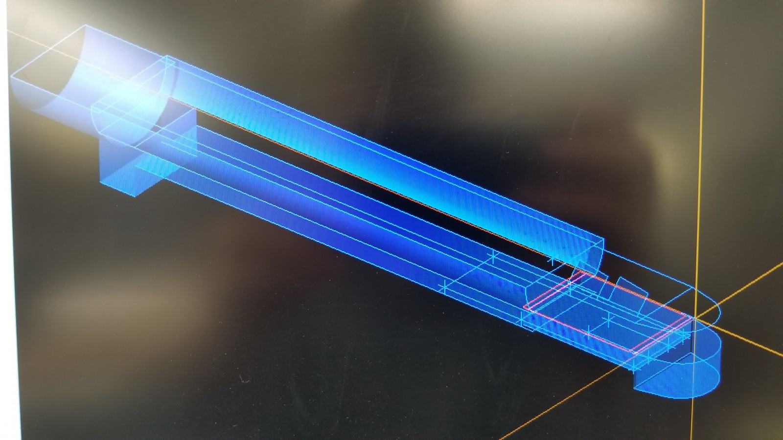

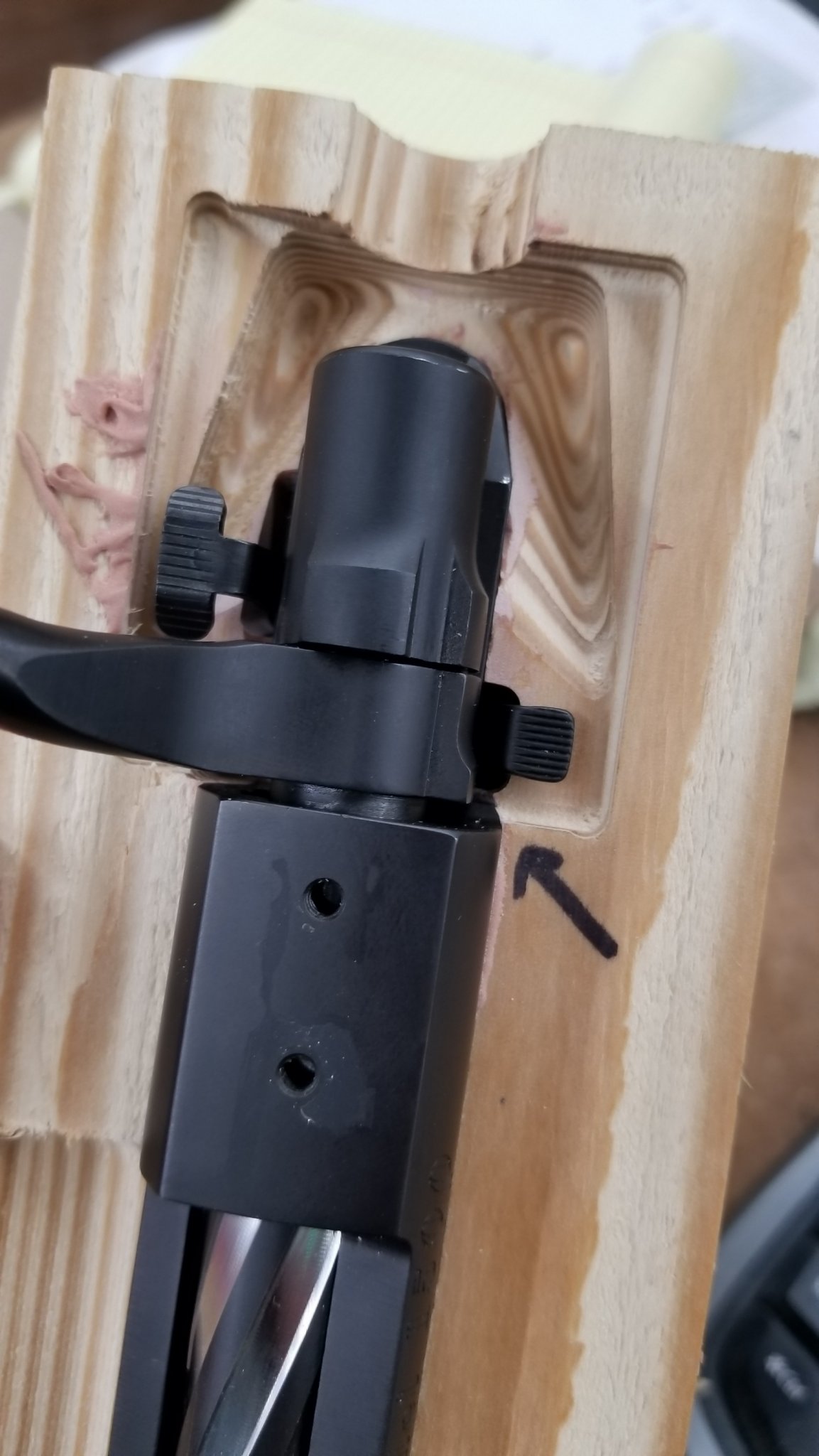

    Step one: Getting everything modeled up so that we have some idea of how the toolpaths need to be applied.

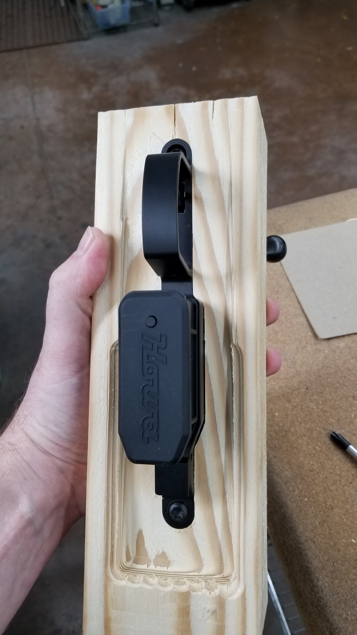

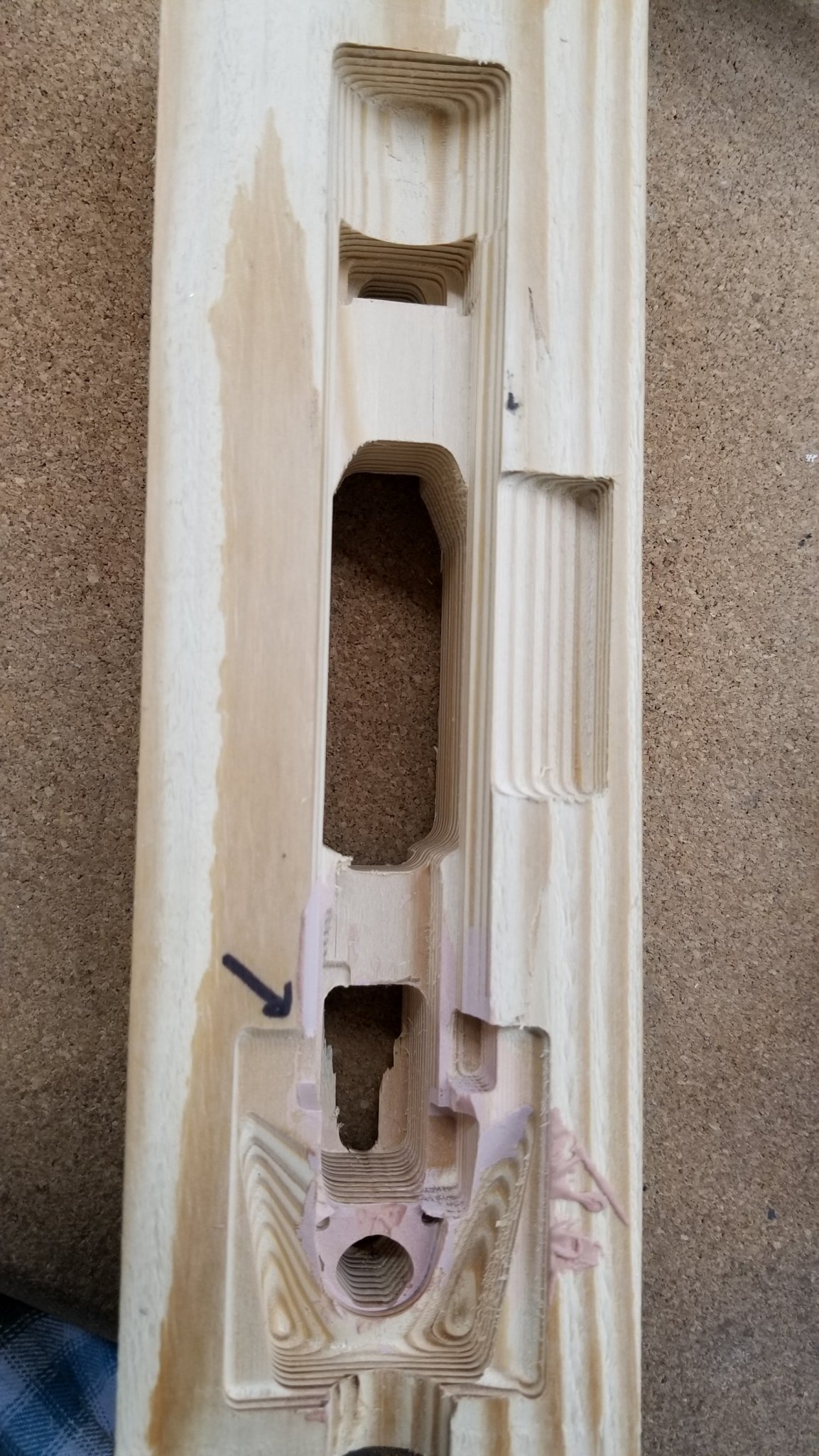

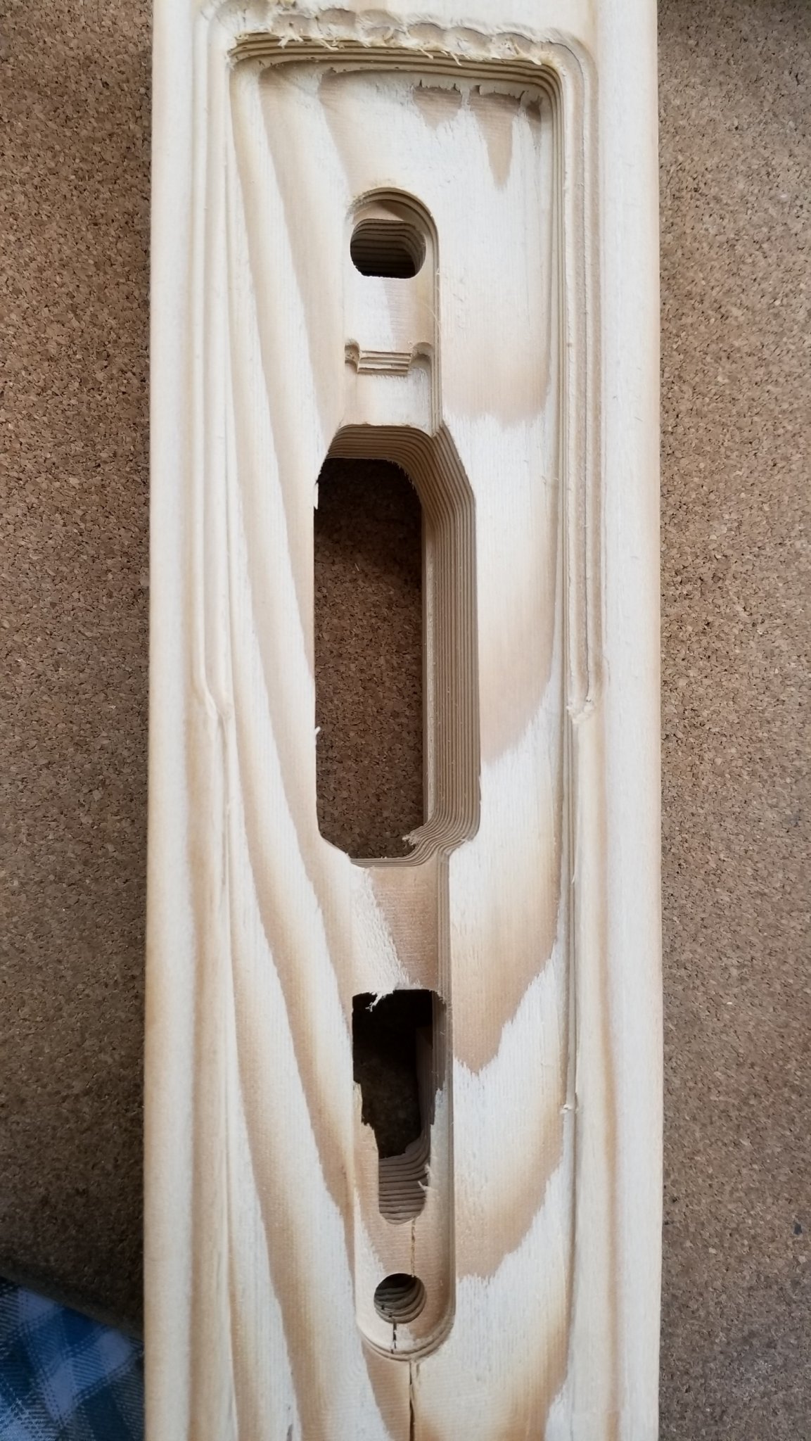

    Two: Test pieces. New jobs like this are always vetted with lumber. We kill quite a few trees here... Top and bottom
    2.1: Test fitting and killing more trees.

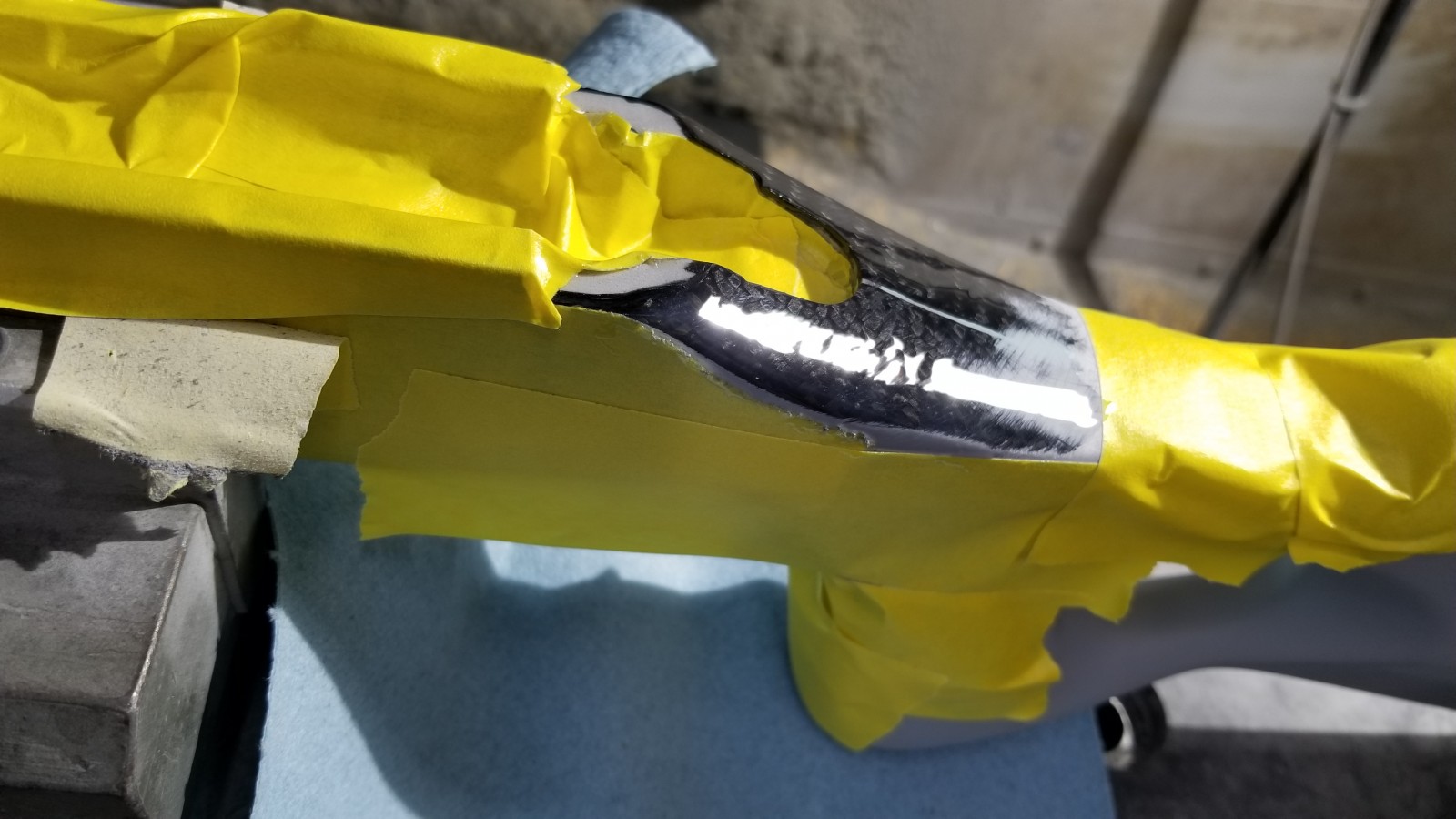

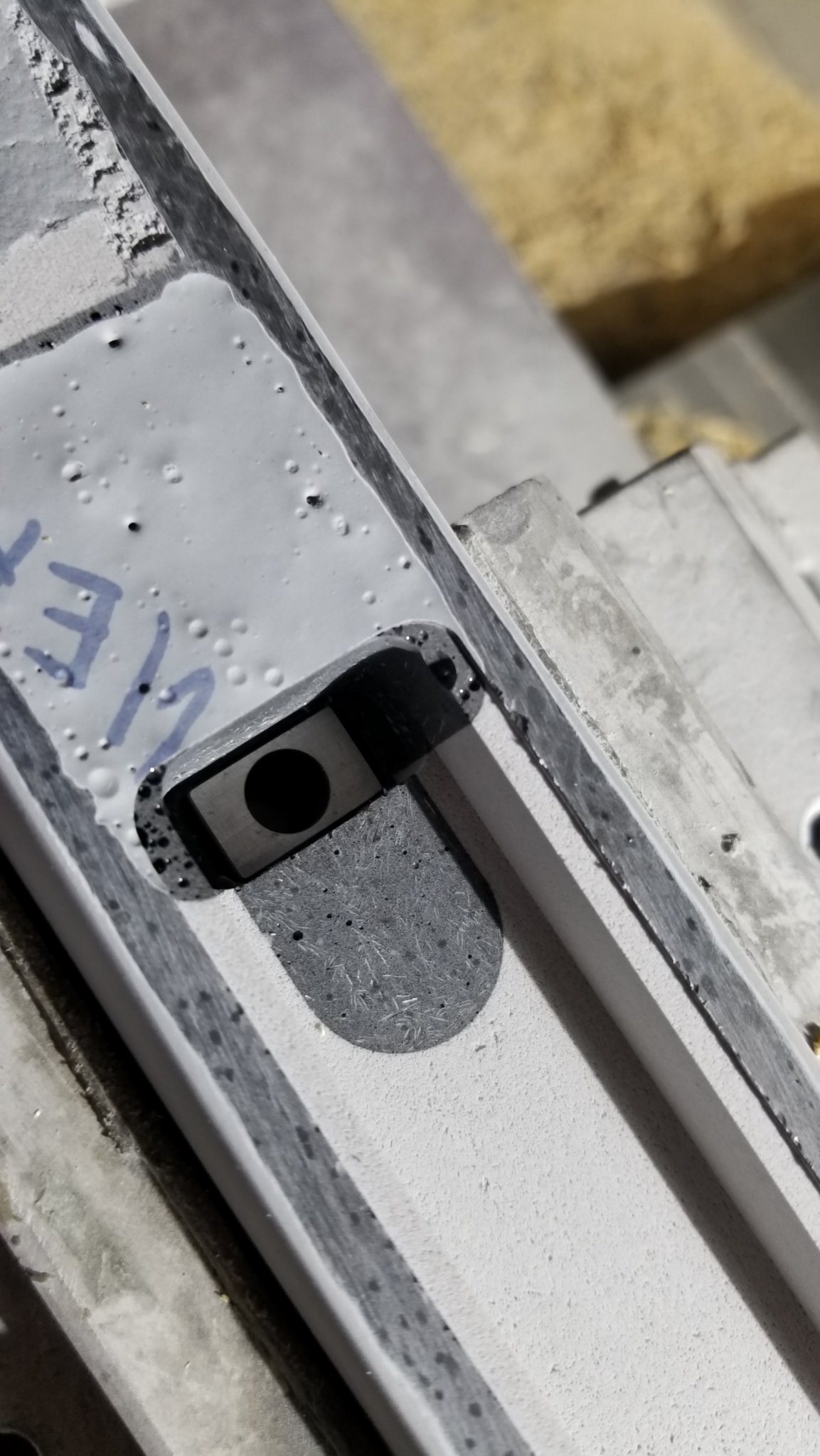

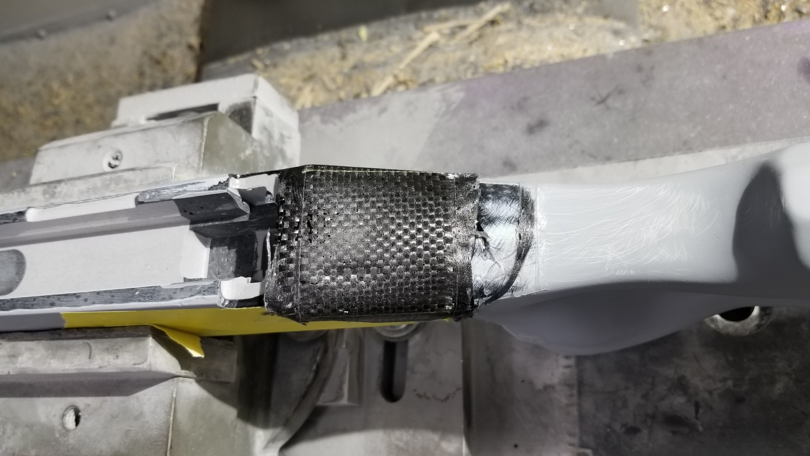

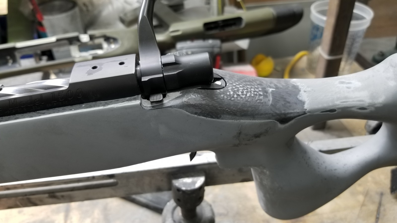

    Four: Inlet and make a "skin graft" to cover up the scab on the tang.

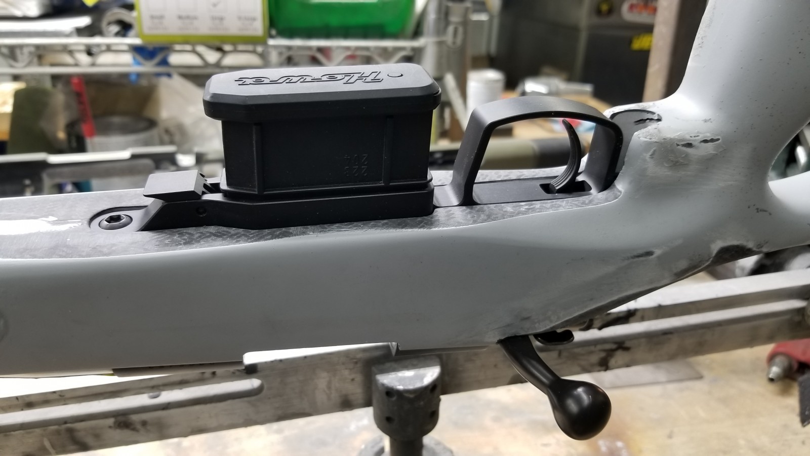

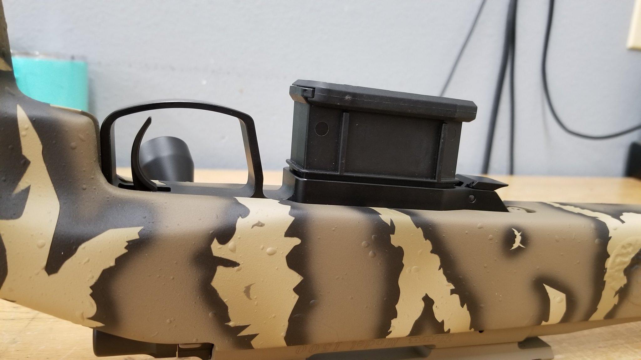

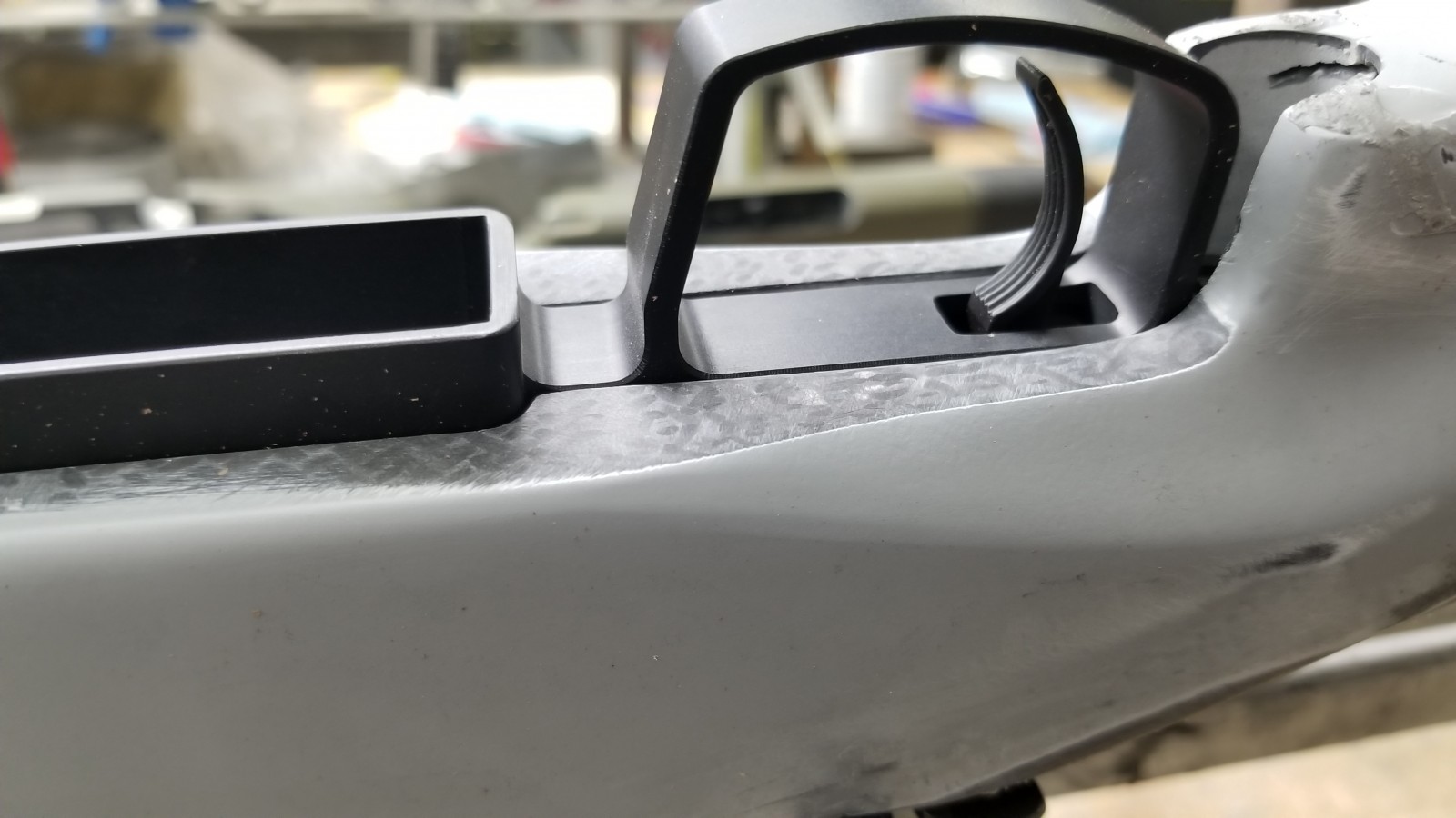

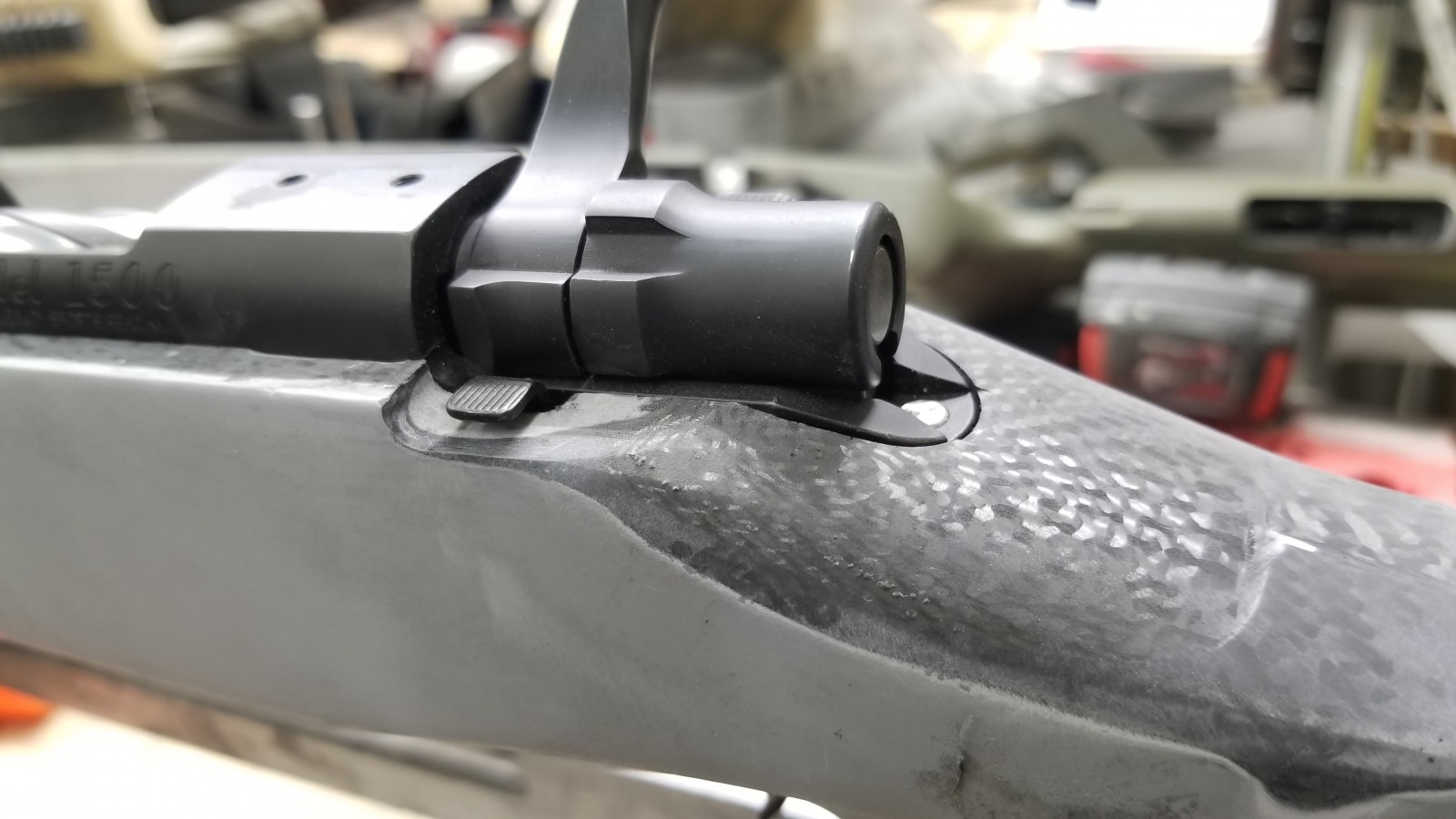

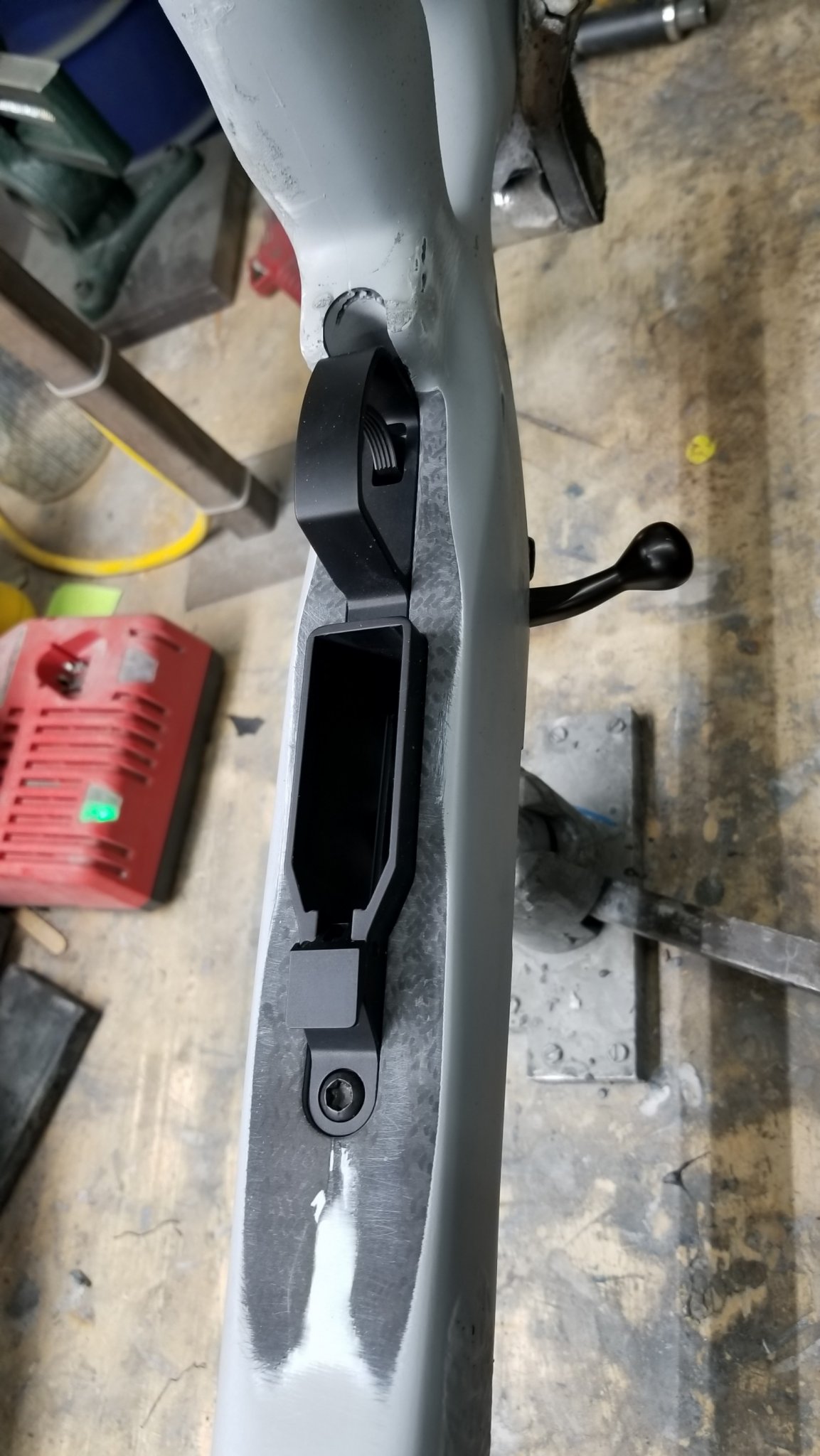

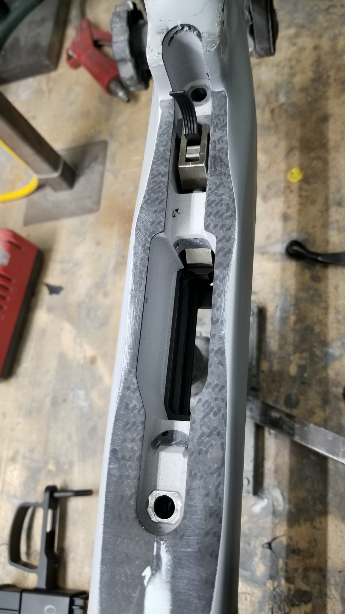

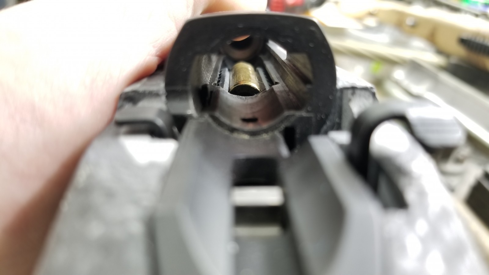

    Five: Post machine work mockup. Its all pointless if it doesn't function to standard. When feeding issue topics with DBM's pop up here I like to try and help by describing the methods we use. The whittled down rule I try to follow is the "figure 8". An "8" is basically a pair of tangent arcs sitting on top of one another. When a center-fed magazine works properly it almost always presents the cartridge to the bolt face in this manner. The primer will lie tangent to the receiver bore, thus exposing the proper amount of case rim to the bolt nose for peeling it off the magazine. So long as feed lips of the magazine don't drag on the bottom of the bolt, you really can't have too much of this overlap. More is always better because one must be respectful of the change in pitch as the cartridge travels up the feed ramp. That angle becomes even more aggressive with short/fat cartridges featuring a steep shoulder angle. (BR's, Dashers, etc)
    The general theme I've come to follow is that in a center feed magazine, the magazine should hang onto the case a bit longer in the feed stroke than with a control round feed. Doing so gets the bullet up the ramp and into the breech ring. This is why the overlap with the bolt nose/case rim is so important.
    The trick here is maintaining that height which is controlled by the floor metal. Very, very few floor metals have the ability to tailor the installed magazine height while also presenting the floormetal flush to the belly of the stock. Here is where a wood stock is much easier to work with. You simply file it down and blend with sandpaper. Composites don't allow for this convenience. It's not always possible to get it 1:1. What compounds this further is that the draft angles vary from manufacturer and with different stock models. 2.5 to 3 degrees is the norm. A half-degree difference may not sound like much, but over a 6.5 to 7-7/16 span it pencils out to a difference of as much as .07" of an inch. Good carpenters work inside that...
    thumb_9166_1600_0_0_0_crop.jpgthumb_9226_1600_0_0_0_crop.jpgthumb_9230_1600_0_0_0_crop (1).jpgthumb_9232_1600_0_0_0_crop.jpg

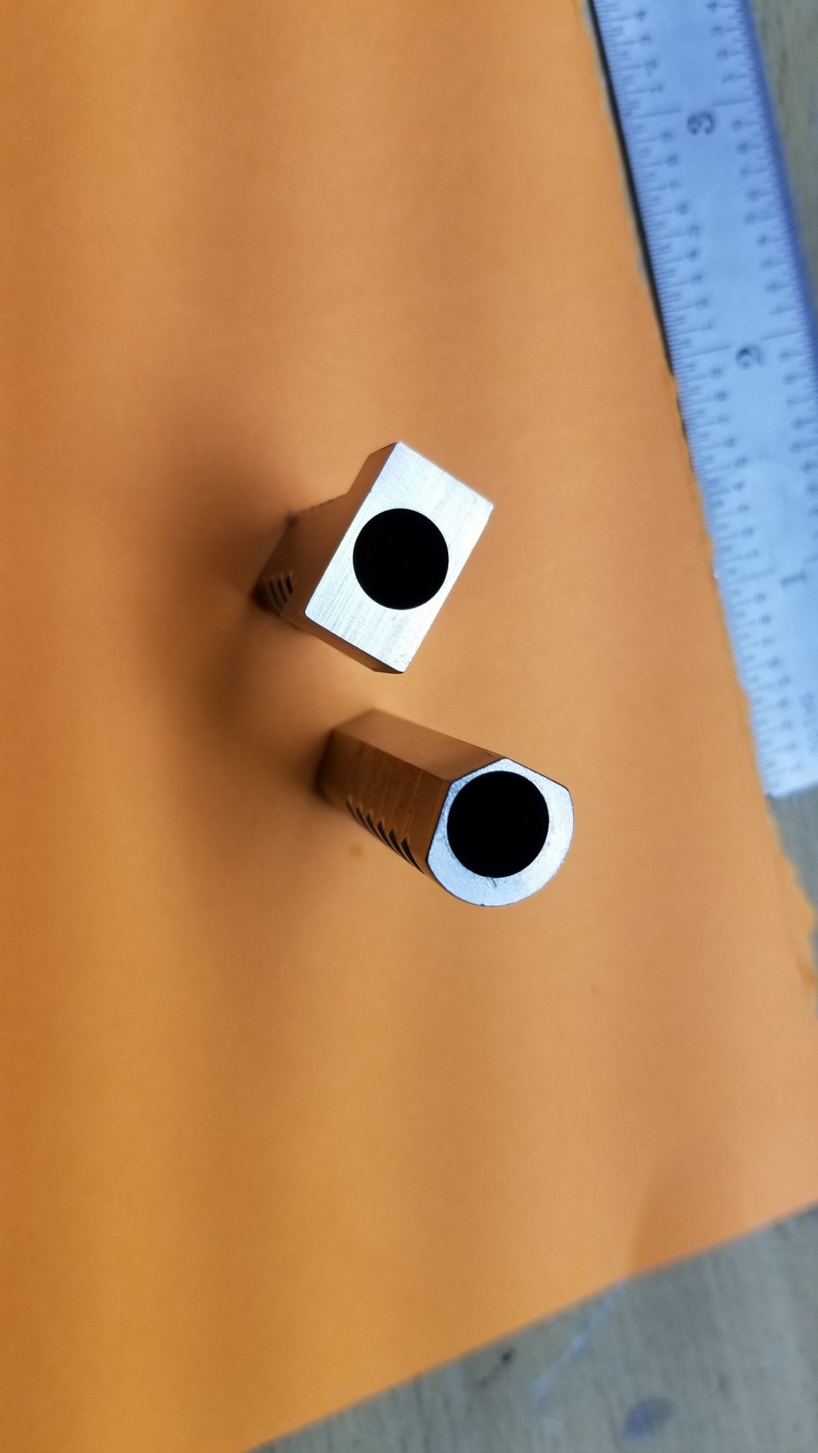

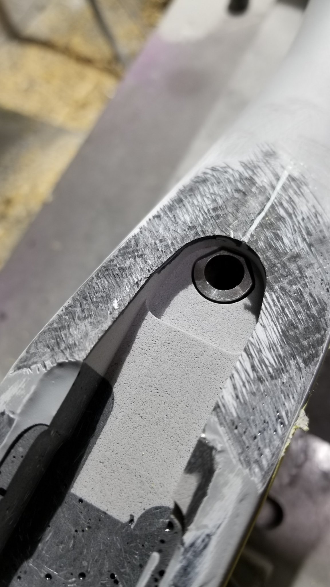

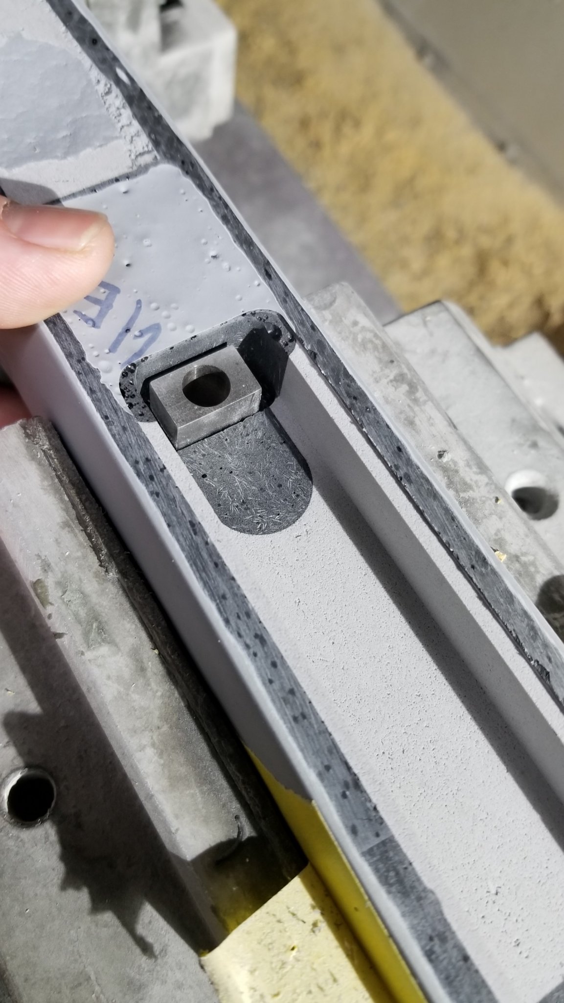

    Six: These actions require some unconventional thinking with regards to pillar construction. As always, we use stainless instead of aluminum.
    thumb_9162_1600_0_0_0_crop.jpgthumb_9201_1600_0_0_0_crop.jpgthumb_9202_1600_0_0_0_crop.jpgthumb_9203_1600_0_0_0_crop.jpgthumb_9204_1600_0_0_0_crop.jpg
    View attachment 7325879View attachment 7325880View attachment 7325881View attachment 7325883
    View attachment 7325884View attachment 7325885View attachment 7325886View attachment 7325887View attachment 7325888
