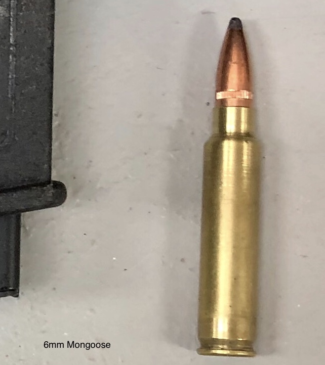

Were it me, I would probably turn the Howa mini into a 6mm Mongoose, MDWS has done the Mini Mauser 6 Mongoose conversion barrels in the past. Understand they make a very good small package that hits hard with light recoil. I have an AR-15 in a 18" 1-8 twist in the Mongoose. It uses LC military brass 223 cases shortened by .050 with shoulder and body blown out to give 31 grains of water capacity and to still fit 105s or 110s in the AR-15 mag and the 223 bolt face. The 80 grains will do 3k fps as will the 95s.
This s what the Mongoose looks like.

That's interesting. Never heard of it. If I go wildcat it will involve me starting down the path of reloading. If that's the case I've thought about 20vartarg or 6x45 also. I may keep it simple and do a 6arc but I already have a nice 6.5 Grendel
