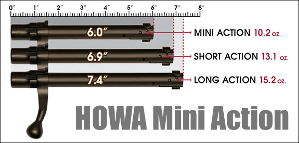

There is nearly an inch difference in the bolt lengths. The integral recoil lug/front action screw is going to dictate that it remains in place, so all of the work would be behind the action. If you had a competent tig welder, if feasible that you could cut the chassis and tig it back together. It would require that the action be used as a fixture.

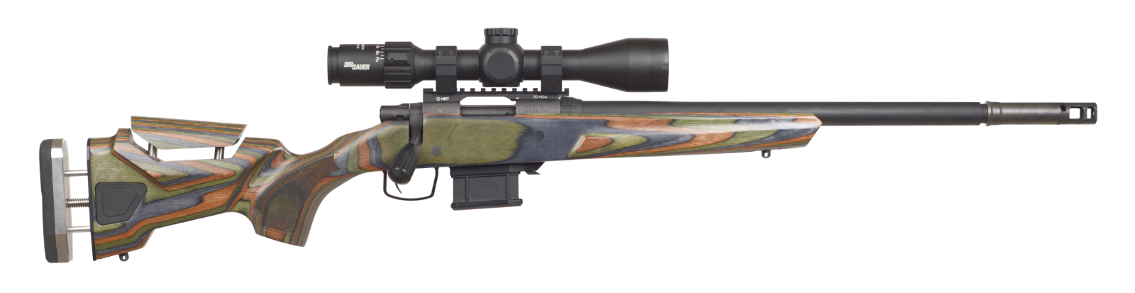

Stocky's has a few stocks for them. Mostly hunter style, but they do have a vertical grip stock.
Bell and Carlson does a couple.

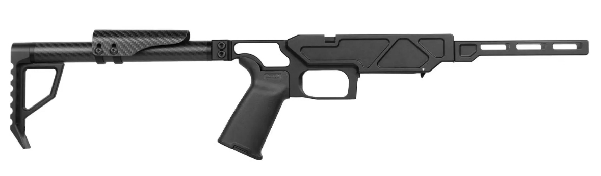

MDT Oryx.
And LRI can inlet a flat top to fit.
Thanks for some of the suggestions. Nothing really meets my needs. I don’t like chassis that use an ar15 style buffer tube and stock. The stockies stock looks nice but doesn’t have an adjustable cheek riser for the mini action. All of the light weight stuff does nothing for me, I want something heavier to help manage recoil easier.
The oryx seems to be the closest to what I need. I just thing they’re ugly and I’m not sure about quality.

Also, on the JTAC elf owl, you can use a picatinny mount instead of the AR tube.
I agree the Oryx is ugly, but they are made well. The only issue is the height of the cheek piece gets in the way of cleaning.
