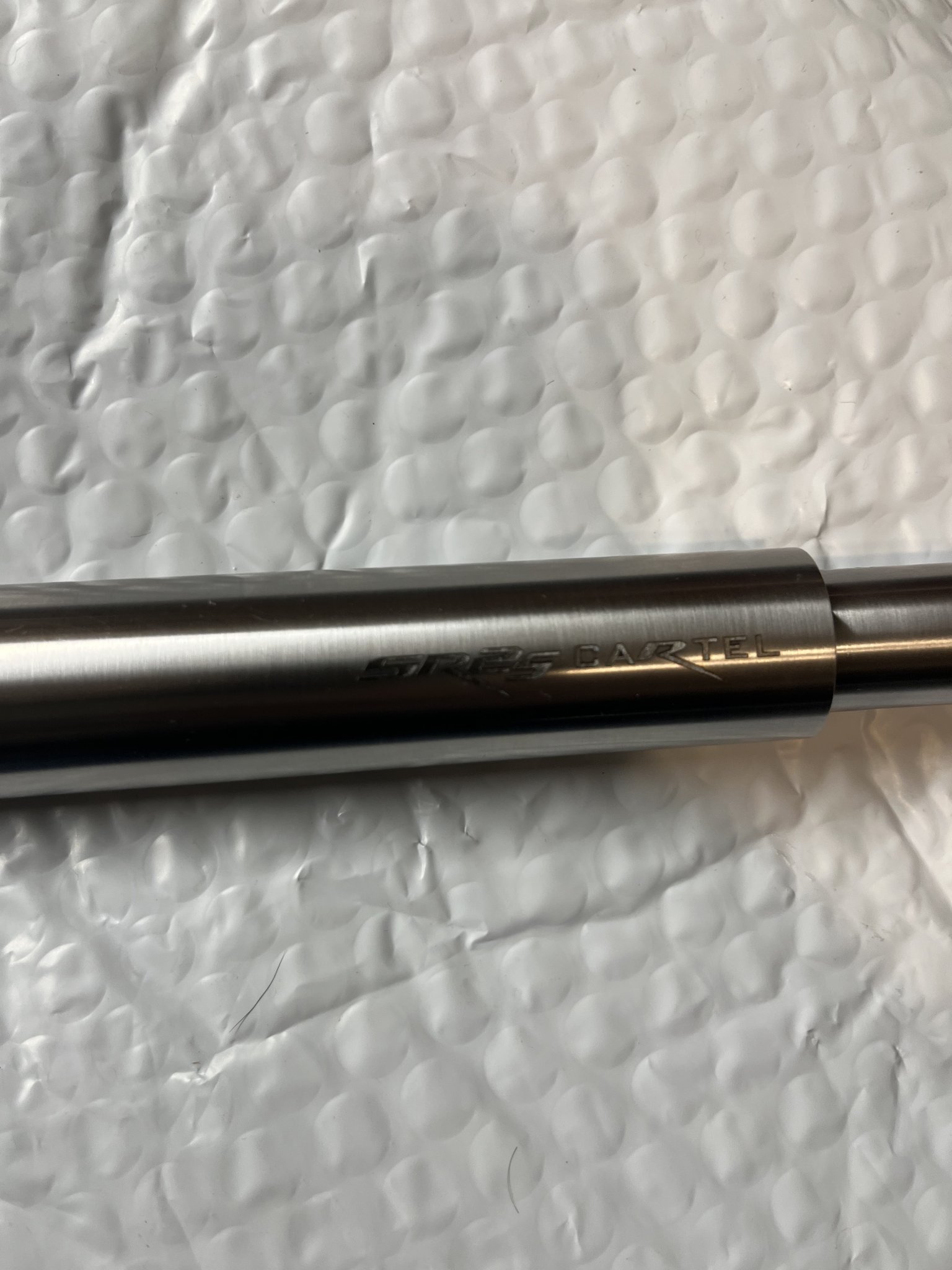

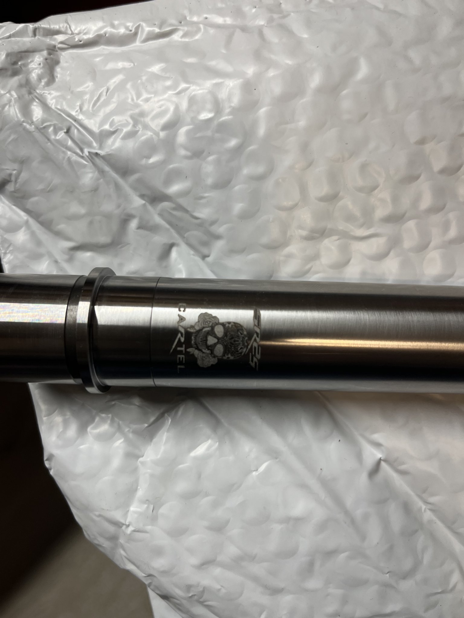

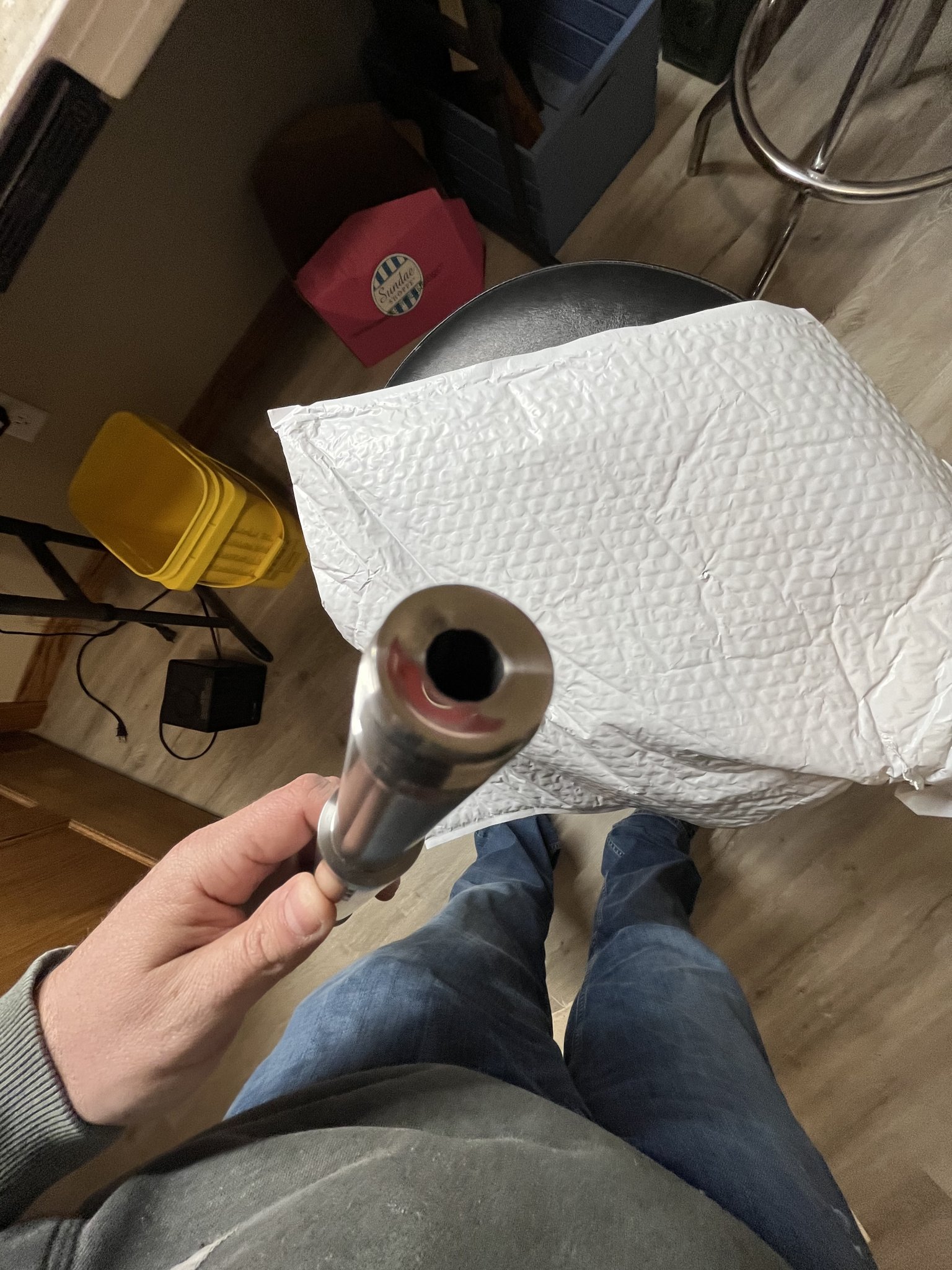

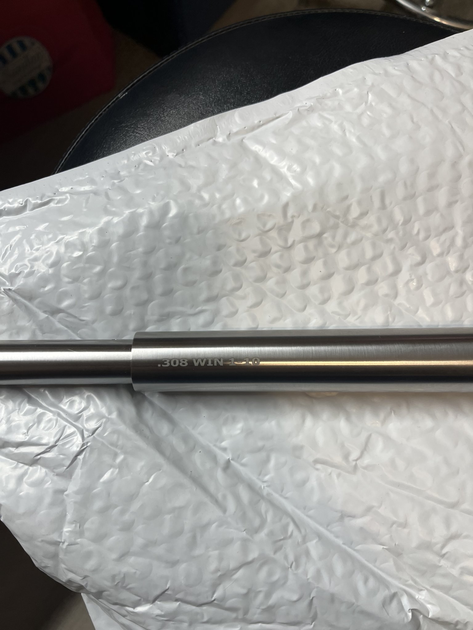

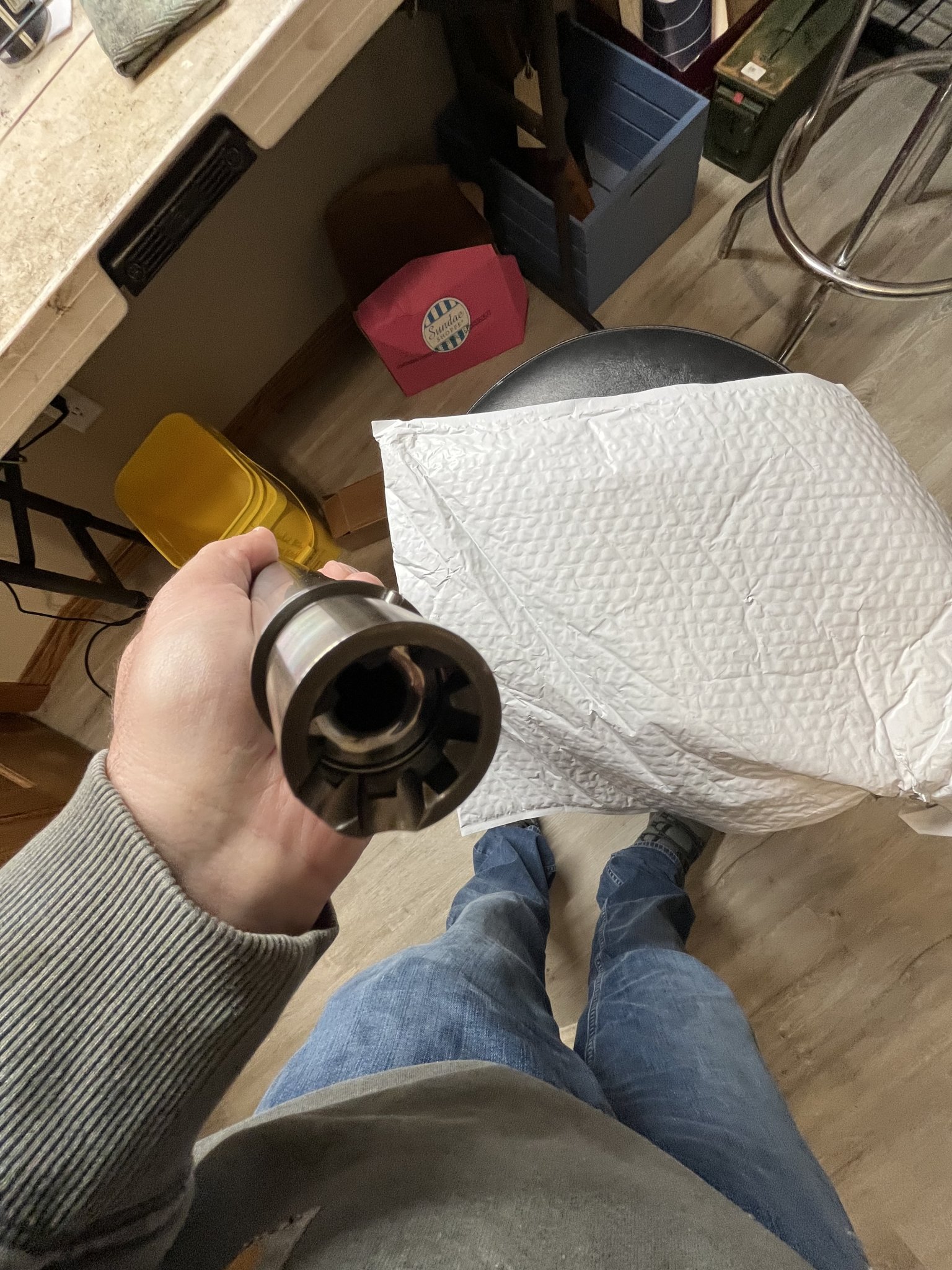

Got this in the mail a couple day ago but hadn’t got a chance to really look it over until today. Initial impressions; buy it. If you are on the fence about quality or workmanship don’t be.
The machining is excellent. No chatter marks inside or out. Their markings are tasteful and in no way over the top. It looks to be a cut rifled bore or a very well done broach cut. It truly is an exact copy of the KAC e-series barrels right down to the way the crown is cut. Except for being made from stainless and the twist rate.
Things I don’t like about it; the way the twist rate is marked, it’s way bigger than it needs to be and just behind the gb. It will be covered by the handguard but it could have easily been put near the breech. I also don’t like that it is dimpled for a GB, personal preference there. The only other minor gripe I have is the gas port is drilled right through a land. I personally have never had this cause a problem from the standpoint of precision but I know it’s something people concern themselves with.
I already have it on its way to d. Wilson to be converted to work with an LMT and have the gas block installed. I have little doubt it will shoot very well.
I likely will purchase a second to install on an actual sr25 and have Templar dimple it to replicate an ecc or ecm barrel.

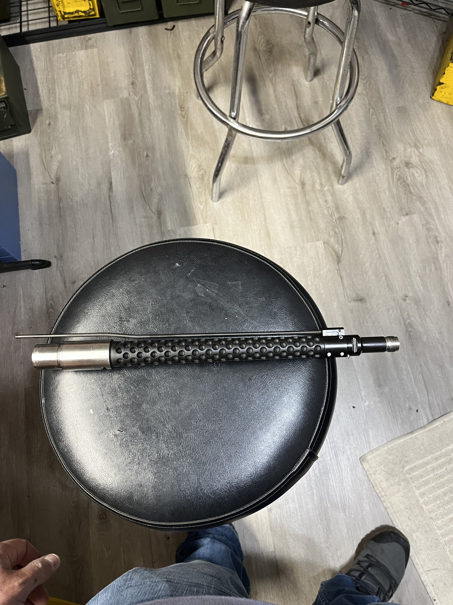

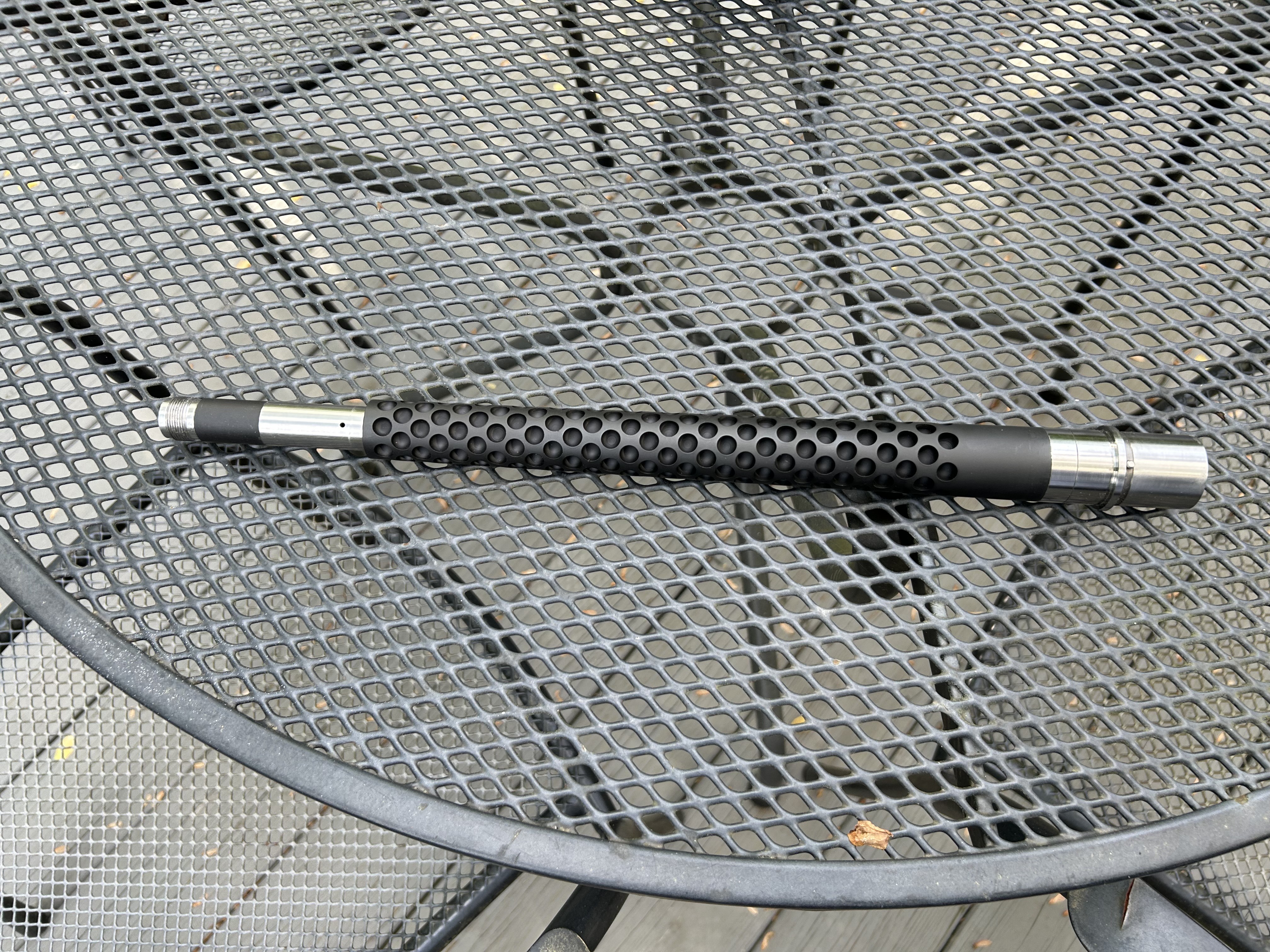

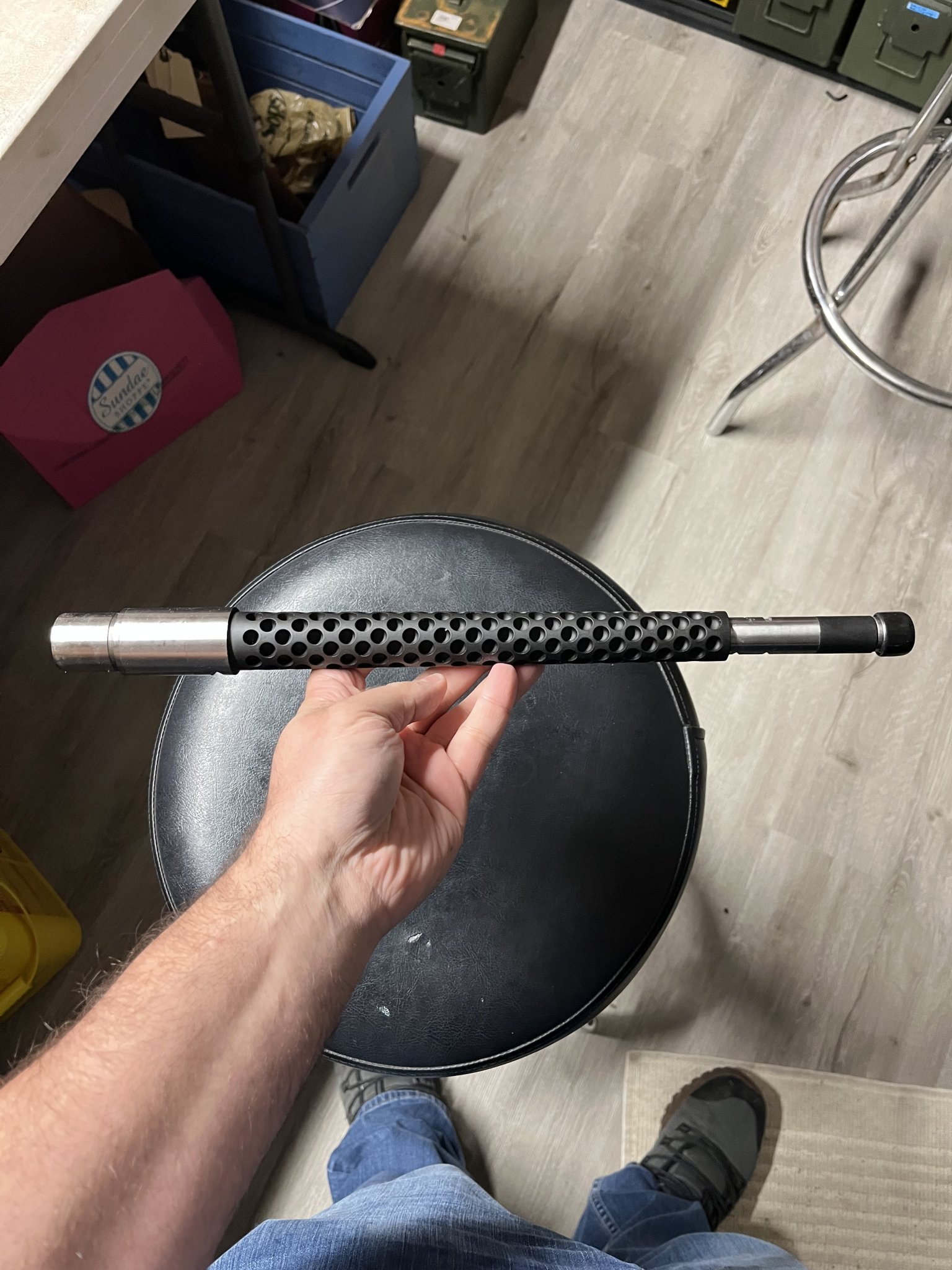

So, for anyone who is still interested in this project I have a couple of pictures of the work done so far. I got it back from d. Wilson, his work is excellent. I then sent it straight to Dana at Templar Precision for dimples. His work is also excellent.
I have an older SL8 upper that I do not intend to use for this barrels final place. I pulled the LMT barrel and slid the SR25 Cartel barrel in. It hangs up on the gas tube and will not fully seat with it. Confirmed by removing the gas tube and re-installing. Barrel slid in freely. This was with a standard rifle length gas tube. Not to say that it could not be made to work with some re-shaping of the tube, I decided to just order a NM rifle length tube. If you are not familiar with them the bend is more toward the gas block to clear the free float tube under the NM A2 hand guards.
Im fairly anxious to get it out and do some shooting but I'm still waiting on the upper, a quad railed version, to get back from cerakote. I will post results when it all comes together and the weather cooperates.

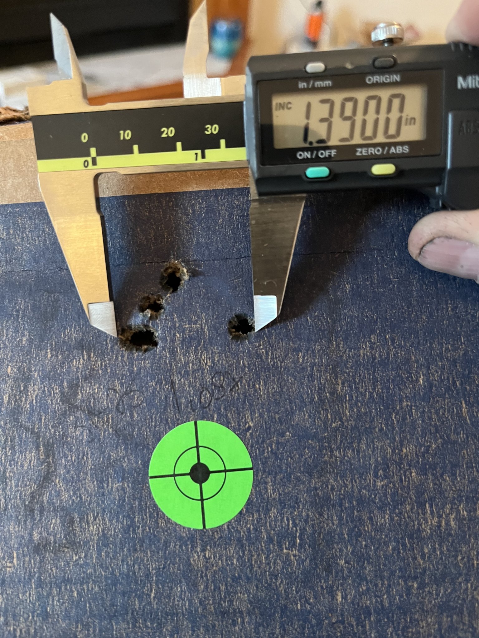

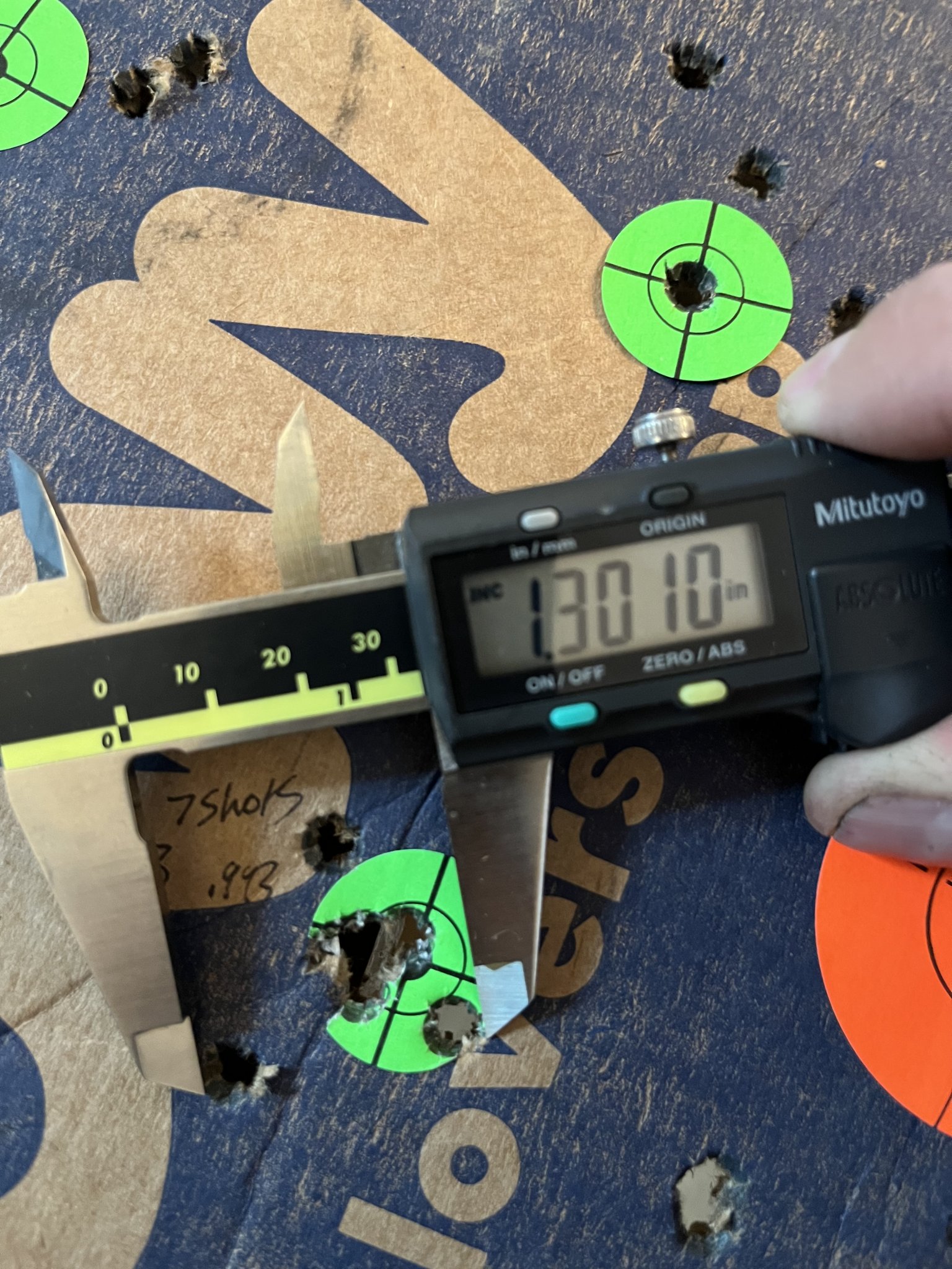

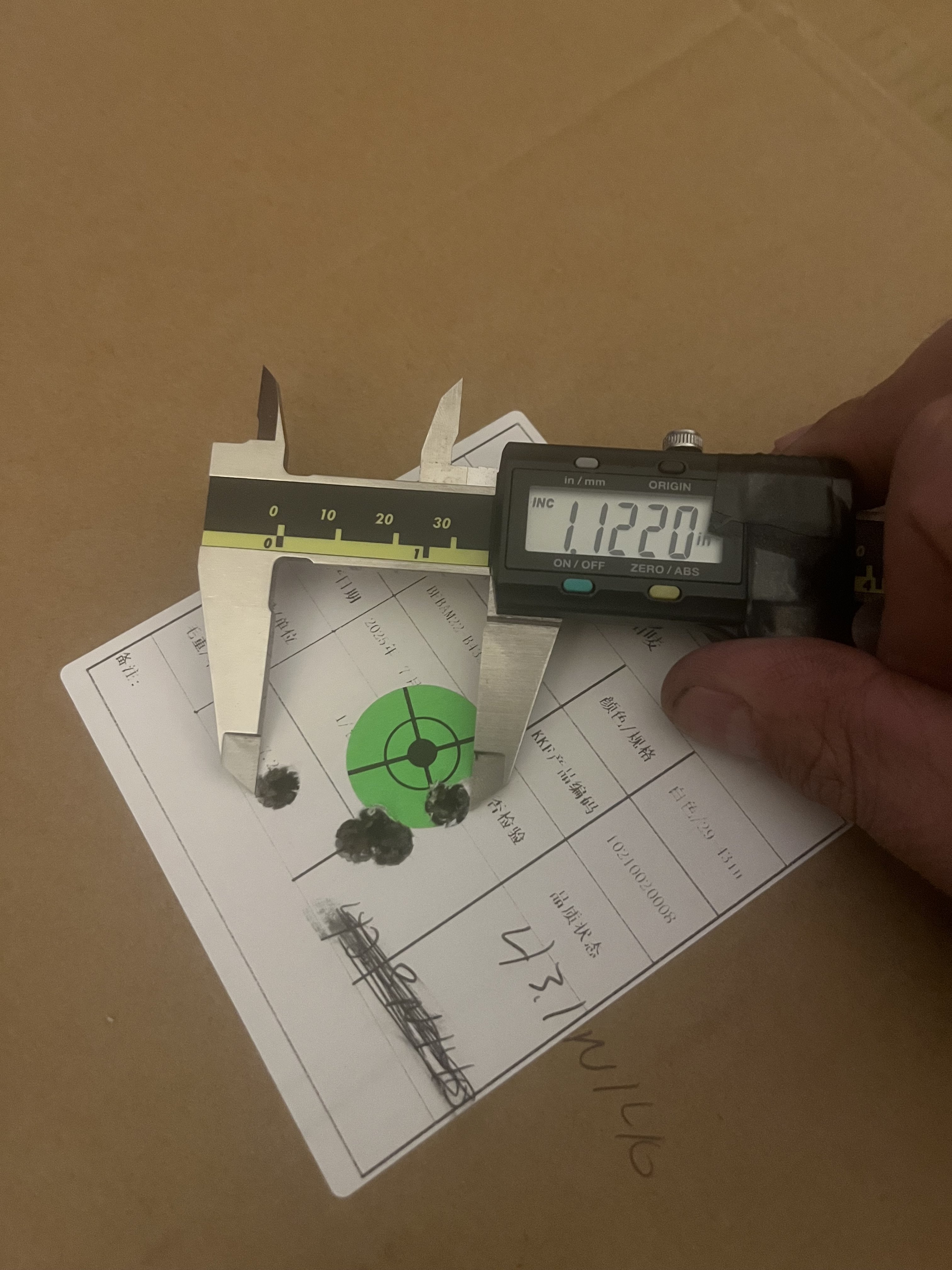

This pic is 7 rounds of gmm out of the LMT. That low left shot may have been me. Still a .993”.

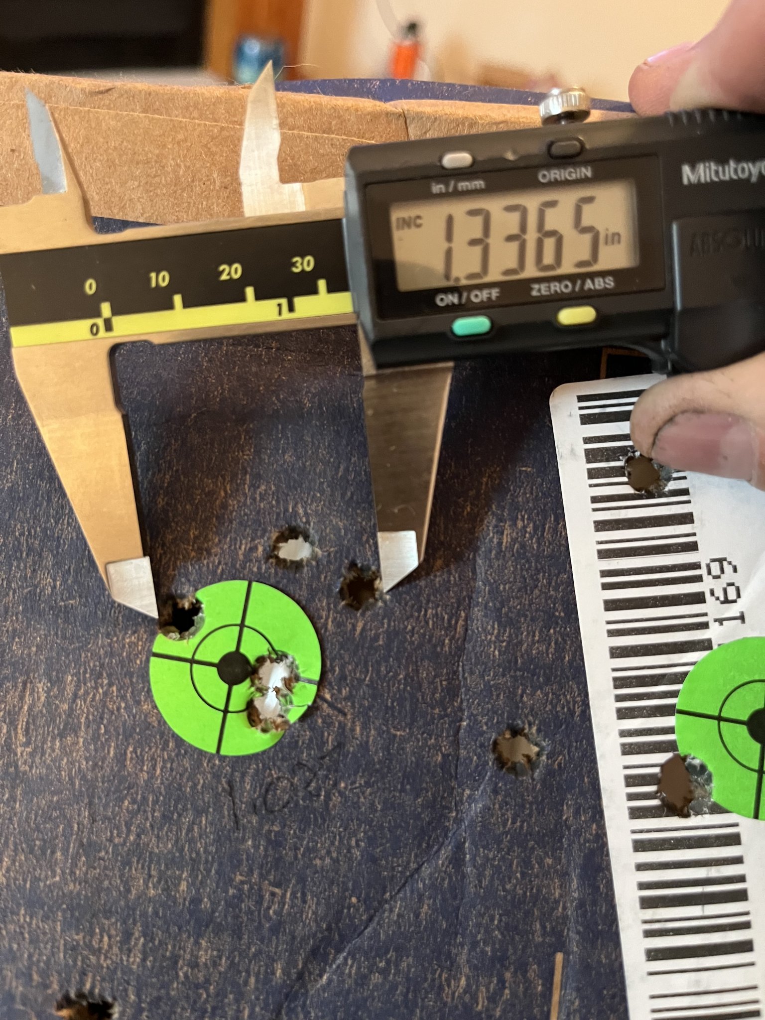

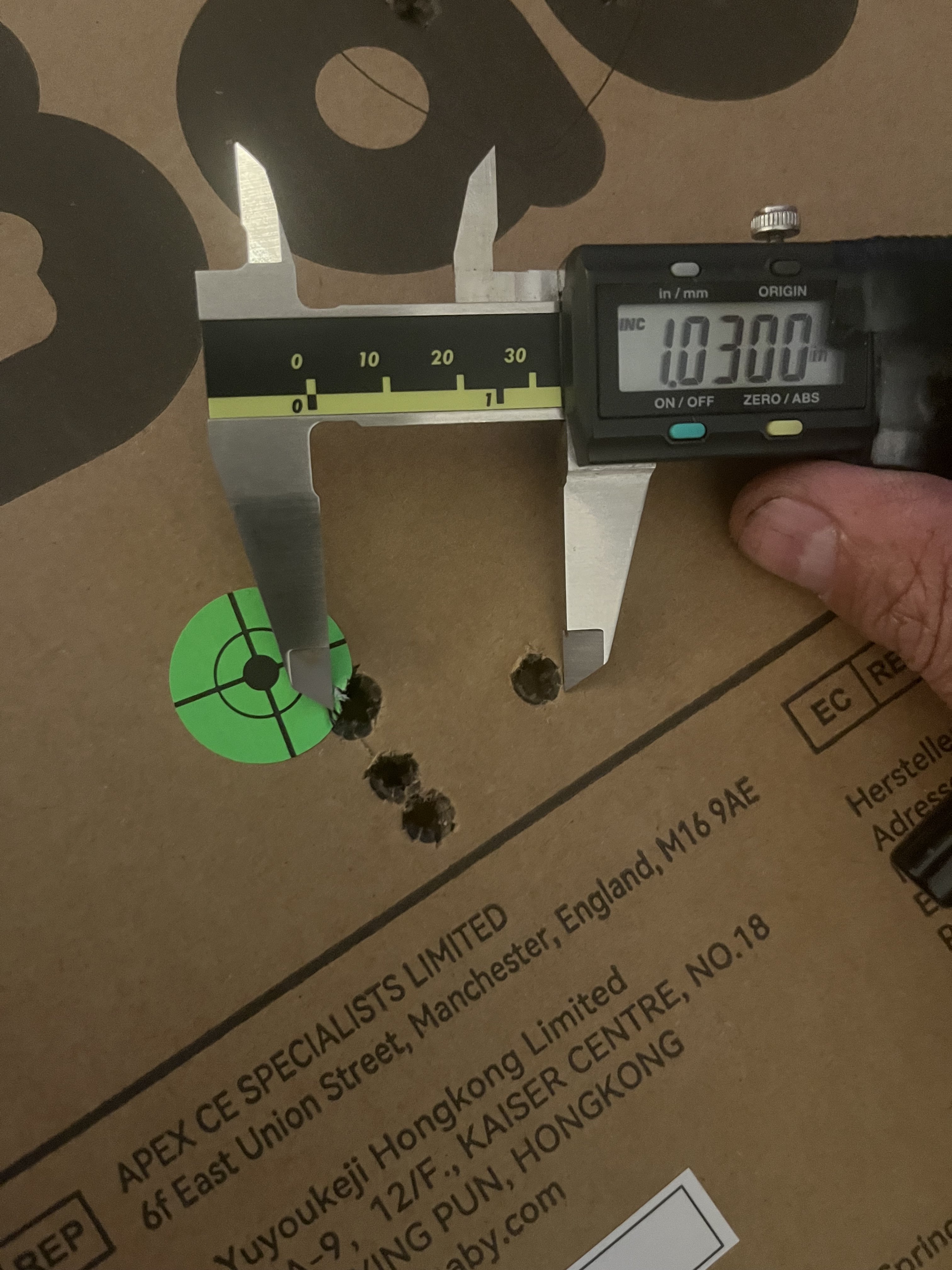

A 5 rounder of gmm measuring 1.025. The shots to the right are of the hand load that I did not bother to measure.

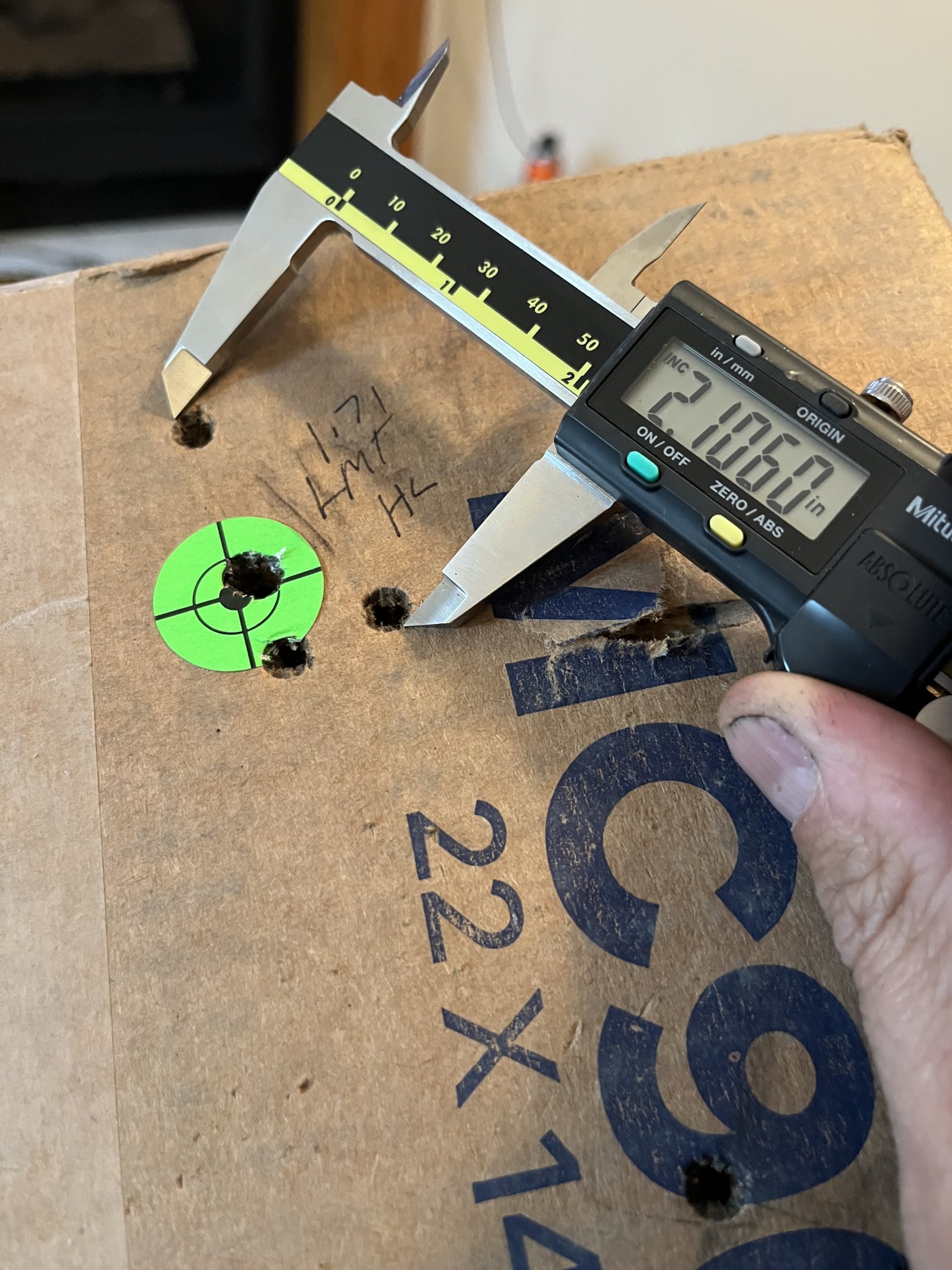

Here is my hand load,5 rounds in the LMT. Like I said, not great.

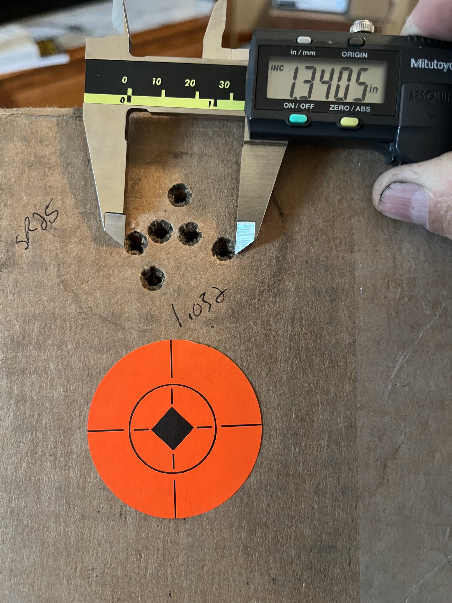

Another SR 25 hand load, 5 shots. 1.082”

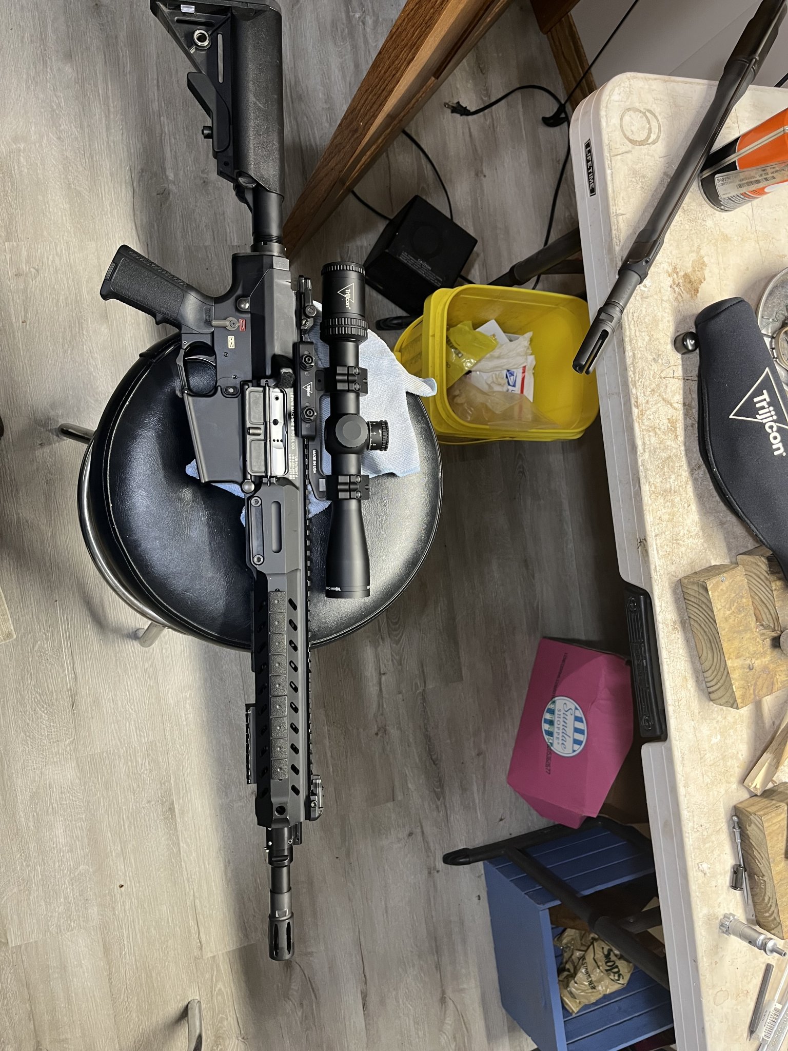

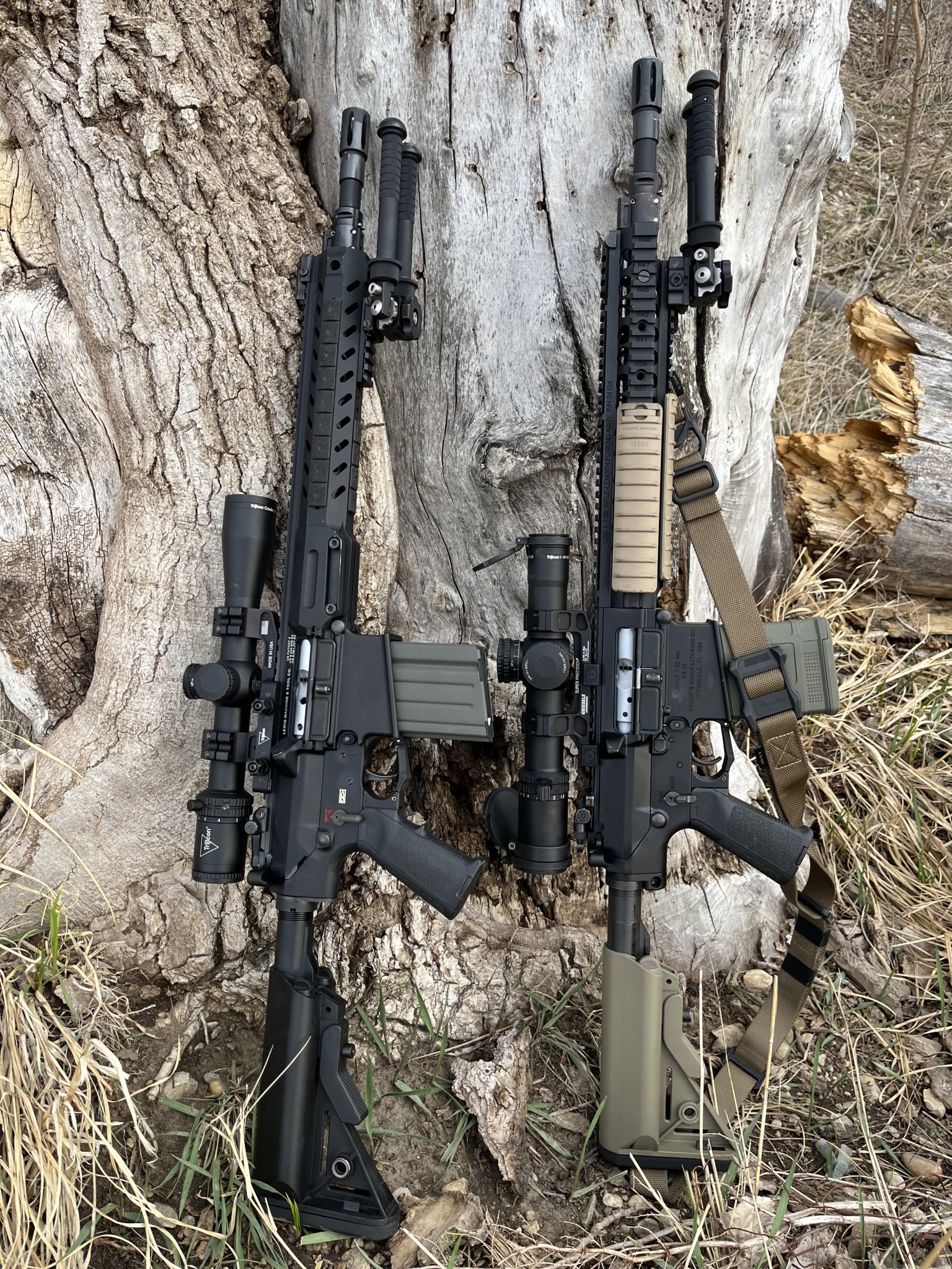

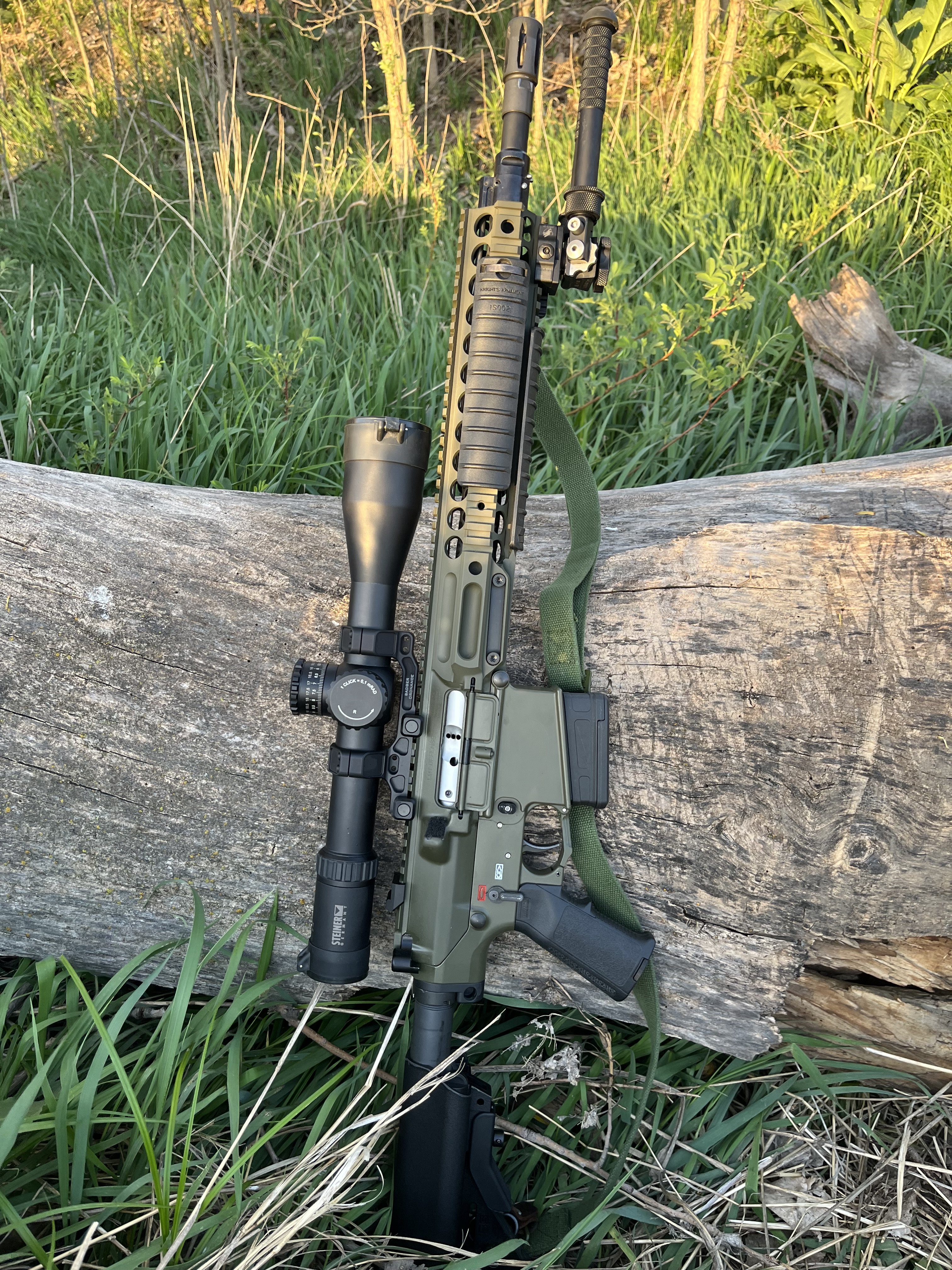

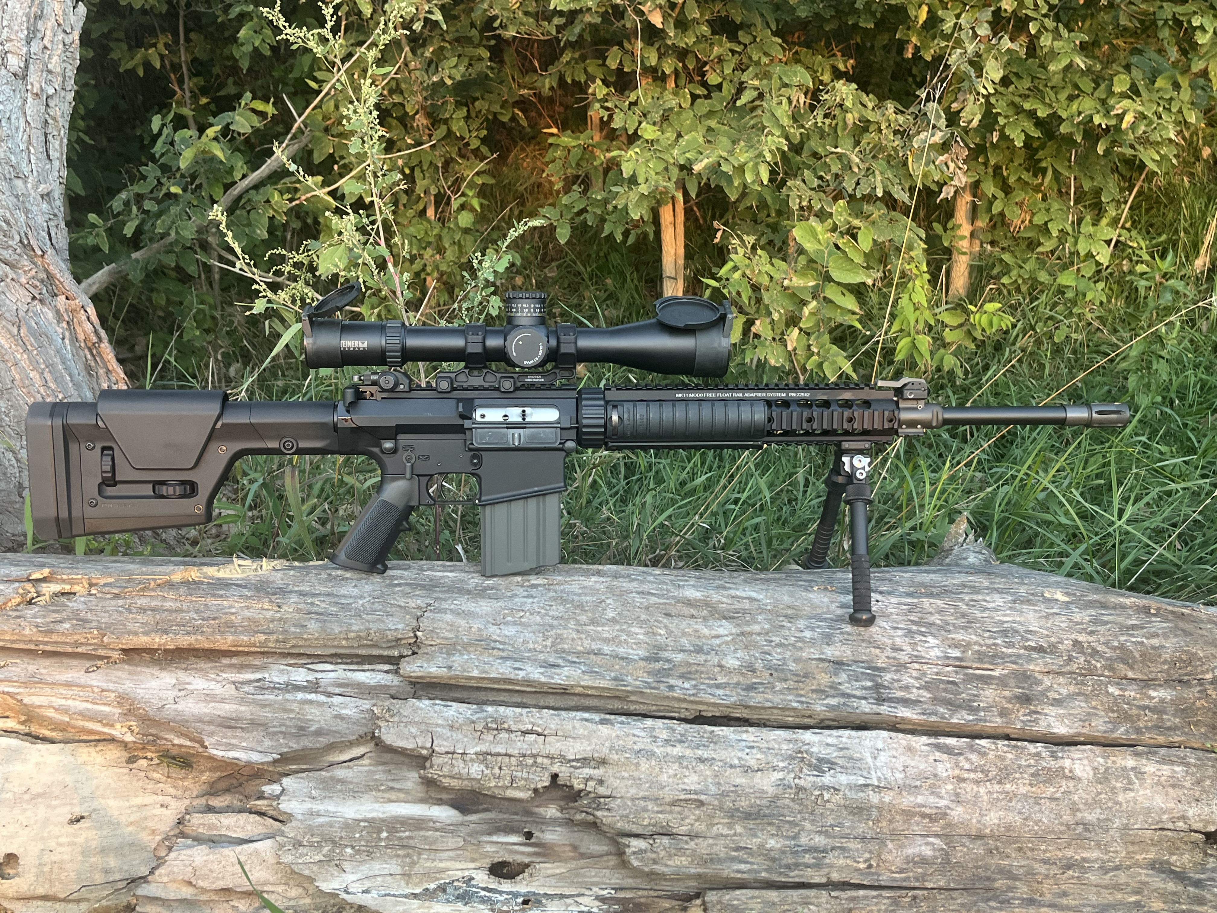

Obligatory pic of them in the wild.
I say the HTX is right in range with the SR25. The KAC is a solid 3/4-7/8” gun but my shooting was not up to it today. The LMT/HTX gun did have several ftf’s with the gmm. None with the hand loads. I attribute this to running a SR25 carbine spring with an h3 buffer. Or my shade tree gas tube bending skills. (Still waiting on the White Oak tube.) The KAC carbine springs are quite stiff. With the LMT barrel; a 16 inch cut down from a 20 inch I’ve never had a malfunction with any ammo. I think this shows the HTX barrel is gassed appropriately. The port is the same .09375”as the SR25.

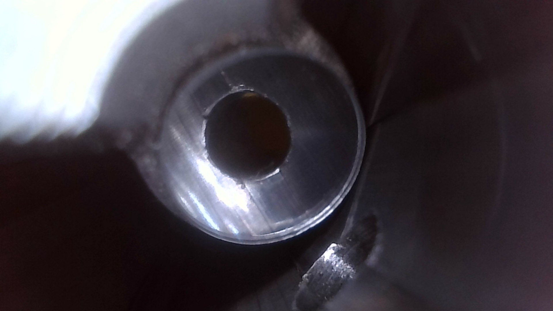

@Black max was asking about the barrels. These are supposed to be Rock Creek blanks. They are broached bores. At least mine is. It is a very good broached bore, couldn’t tell until I really looked at it after several hundred rounds with a bore scope. I did see something on IG, they are also starting to use Bartlien blanks for some of these, don’t know if there are in the wild or it is planed to use them for future barrels.

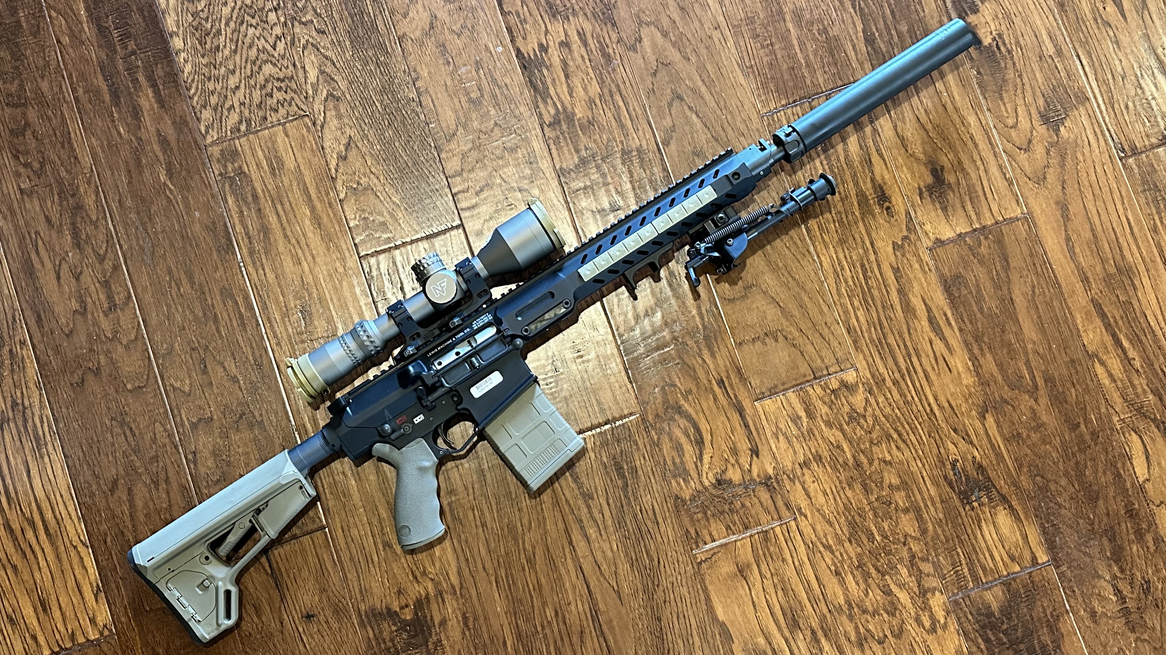

That looks great. I have a SR25 ECC and I got tired of waiting for shorter SR25 6.5CM uppers to get released. Here is a Cartel K1 6.5CM 16 inch dimpled by Templar. Pairing with a Centurian SR25 pattern Upper and KAC Keymod URX4 15 inch. Not sure on Gas Block. and probably go FDE for the whole thing. I was told that they are using cut rifled Rock Creek blanks.

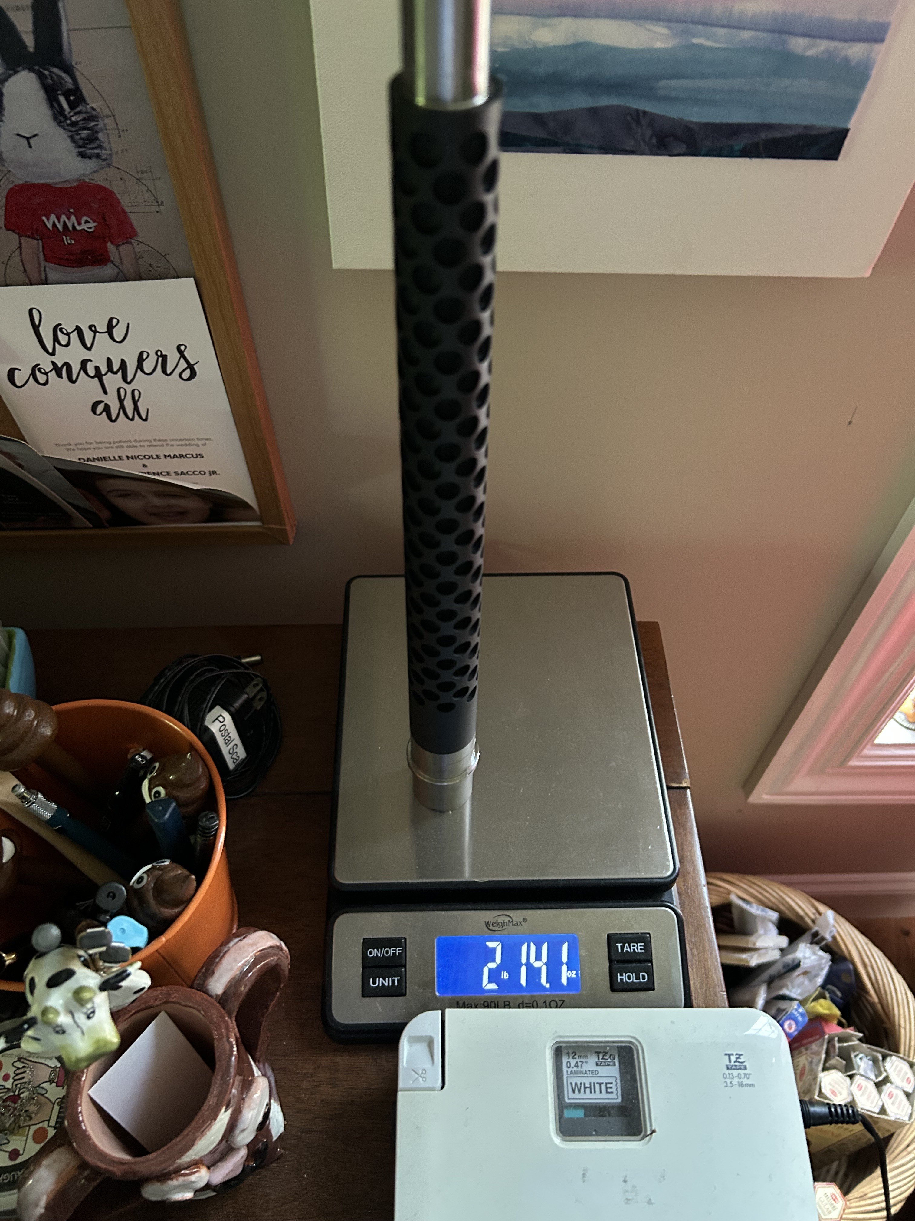

Picture of weight. Unfortunately I didn't weigh it before the dimpling.

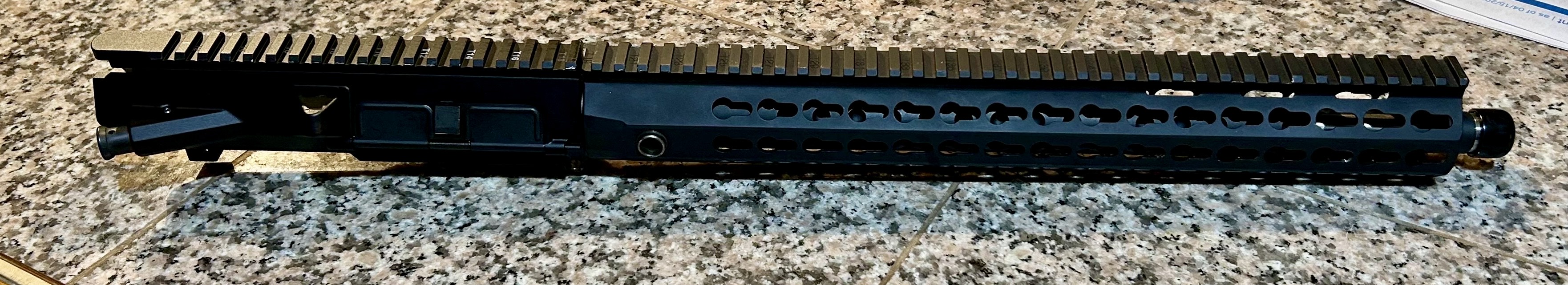

Picture of upper mock up with stag upper stand in.
