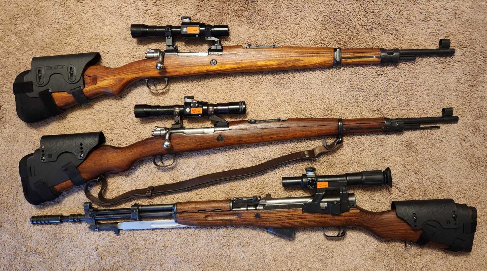

Anyone ever deal with John Huber's adjustable two-stage triggers in a Mauser. A couple years ago I was so frustrated trying to get his dual ball bearing adjustable two-stage in my M48 I had to send the barreled action to him to dial in. It's not bad but not amazing. Like my M48, I cloned my 24/47 into Yugo civil war era sniper. I’d like to have a nice modern two-stage adjustable (or not) feel with hopefully a 1-2lb free and easy first stage meeting a 3ish lb break over The Wall. I’d rather not go Timney, as I understand, will require dramatic modification of the stocks.

I'd like to do the same with my mint-barrel Persian 98/29 but am wary of any stock mod as that's far more valuable/rare than M48s or 24/47s. Gunsmiths and precision shooter (especially Fudd sporters guys) have been tweaking, building, modifying Mauser actions for decades. I spoke at length with John a couple years ago and, while no doubt a brilliant man, went off on all kinds of tangents that I just could not follow i.e. psychology of the “break” and timing theory about meeting and crossing “the wall”. One of those guys that’s possibly on “the Spectrum” (whatever that mean nowadays). I just couldn’t follow. The million-times photocopied notes and hand-drawings that he includes with his trigger are just too cryptic for me to make sense of.
