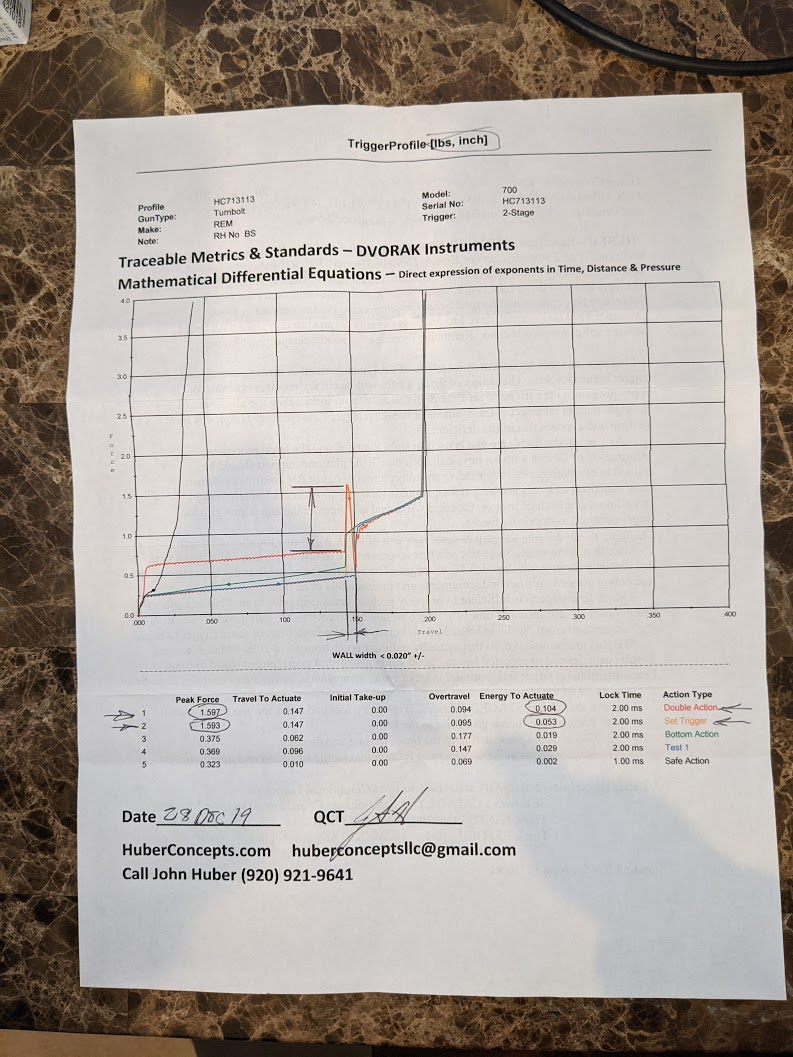

    For those who have a Huber 2-stage trigger, can you tell me why there's this set trigger behavior? I have a 1.6lb Huber 2-stage. From the behavior -
    1st Stage to 2nd Stage, .8lb of force.
    2nd Stage - Break, 1.6lbs of force.
    From a feeling perspective, that means I put about an additional .8lbs of force to break the shot. This feels great, I'm using to about a .8lb break and when I shoot this way I am consistent.
    Now, if I engage the trigger, and let off, disengage target, say I was on the wrong one and I switch to the right target. The trigger is now in a "set trigger" mode.
    1st Stage now becomes 60% of the original weight. So it's about a .45lb take up.
    2nd stage remains the same - Break 1.6lbs of force.
    From a feeling perspective, that means I had to exert an additional 1.1-1.2lbs of force for it to break. This throws me off. I sometimes pull, and it doesn't go bang because I didn't pull enough. It seems weird but I'm very used to consistently pulling at that sub 1lb for the shot to go off, but this 1.2lbs of addiitonal force is throwing me off.
    What I am curious about is why is there this set trigger mechanic? What function does it serve? If I put the gun on safe, or recycle the bolt, the set trigger mechanic gets reset to the standard 1st stage pull.

    The felt amount of pressure is the difference from 2nd Stage minus 1st Stage. So in general I'm looking at .8lbs / 1.6lbs. This means that it only took an additional .8lbs for me to break the shot. I'm used to that. I've trained on what that feels like.
    If I'm in the set trigger mode, I'm now looking at .4lbs / 1.6lbs. This means it will take an additional 1.2lbs to break the shot. After shooting thousands of rounds at .8lbs of additional force, my finger will pull .8lbs of additional force, and no shot will break because I need to essentially be pulling 50% harder.
    That's the issue I have with the inconsistency. If they made the first stage lighter, make the 2nd stage equally lighter so that the difference between the 2nd and 1st stage is the same, hence a consistent .8lbs of additional force to break the shot always.
    The stage that changes is only take up.
    The actual break is always the same.
    I don’t really care what the total is because it’s the break stage that matters.
    My tigger is a 2#
    Normally it’s 1 pound 1 ounce take up and 1 pound break.
    On a light second pull it’s 9ish ounces and a 1# break.
    I honestly never notice it as the break is consistent.
