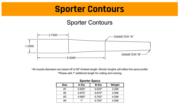

I'm building out a Bighorn Origin build in 6.5 PRC. I'm debating between going with a Proof Carbon Fiber Sendero ($820) or Preferred Barrels Pre Fit ($390).
Looking to keep the rifle at or below 6.5lbs.

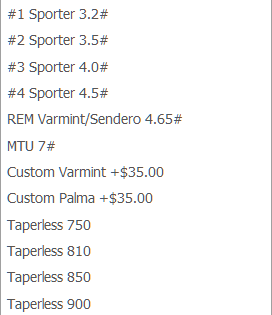

They listed out the following contours (some list the weight of the barrel);
Would a #1 or #2 contour be too thin and sacrifice accuracy?
If that chart is correct, their contours are pretty beefy. Their #2 is like many other #3's and their #2 is about like a Brux or Lilja or Rock #3. Heck even their #1 is almost a #3 from say Brux or Mullerworks. If your trying to keep it pretty lightweight and not overly muzzle heavy I'd go no more than their #2 which still goes 0.670?? I have a couple lighter weight 7MM-08 builds with Bartlein 2b contours that are about 0.66" @ 22.5" finished length and balance is good IMHO.

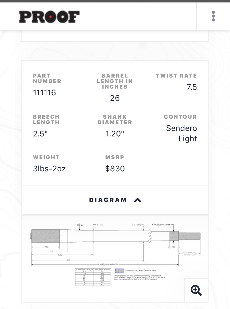

I’d be leaning towards a Proof CF Sendero Light for a Hunting build. Their Sendero Light is basically a Rem Sendero Contour as I recall and the Proof Sendero Contour is closer to an M24 Contour. Per the diagram below, the CF Sendero Light (Rem Var Contour) weights in at 3.2lbs, same as the #1 Sporter Contour You posted above.
