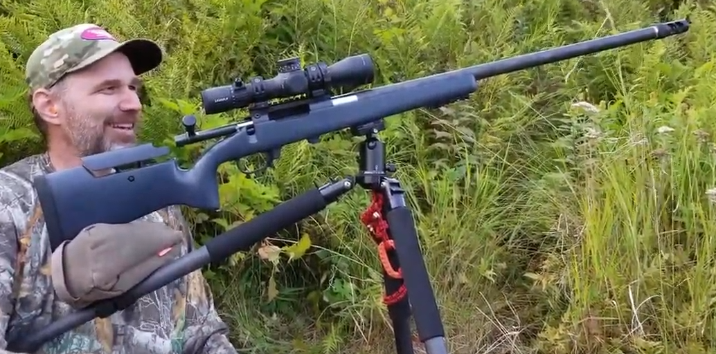

PM sent with a video of my rifle. Here is a screen shot.
I drilled and mounted it just like this.
I put it in front of the mag well, outside of the balance point, because I wanted to be in front of the recoil lug a bit. It is a little tail heavy, but not by much. I finished the rifle only a couple months before the hunt, and had load dev and other prep. So, I just used what I had and didn't think too much about it.

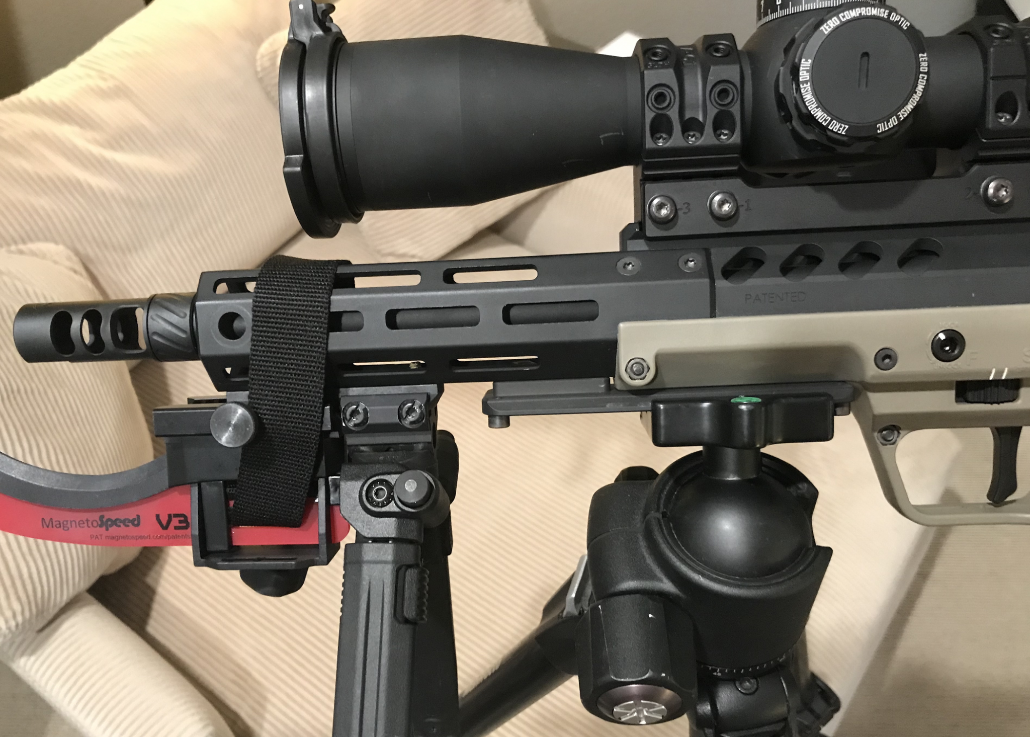

Like @hereinaz mentioned above, I run a shorter Arca towards the midpoint and a shorter Pic rail up front.
Once I upgrade my crappy bipod to a nicer one, I'll probably run a full length Arca. This works well for now though. Plus I can run my Magnetospeed on the Pic rail, which is super handy, since it's on the rail there's no shift so I run it a lot.
