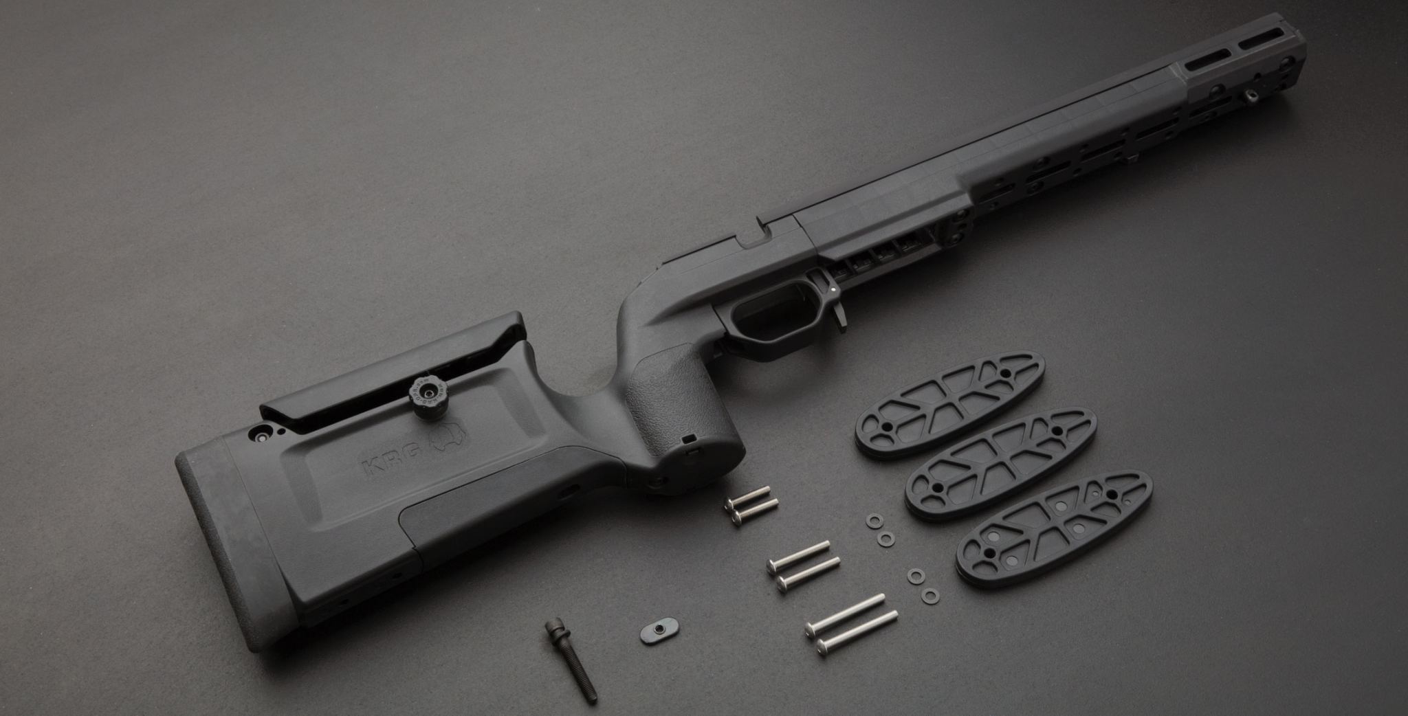

    A chassis would be the most affordable way to go about getting all of that adjustment. Something like the KRG bravo has spacers for the length of pull adjustment and an adjustable cheek piece. It keeps the more traditional butt stock profile (and cold metal cheek piece) while incorporating a more vertical grip.
    https://kineticresearchgroup.com/product/bravo-chassis/

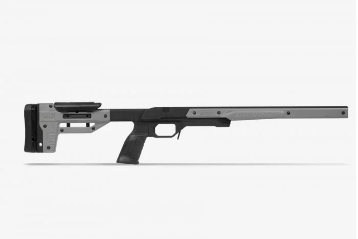

    MDt also has their oryx for preorder that has the adjustment in it for under 400 bucks.
    https://oryxchassis.com/
