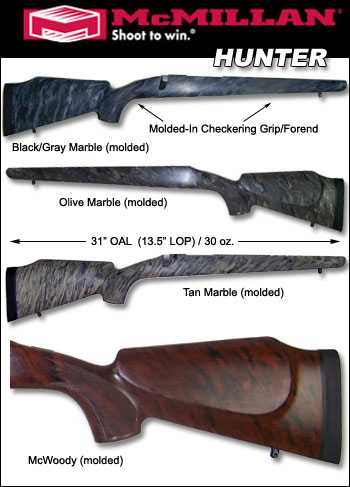

I have also been thinking about McMillan Hunter (Sako Hunter) which seems to be in in stock for Winchesters.

I love my McMillan hunter with edge, this is a 300wm with 26" Bartlein #3 contour, comes in under 8 lbs. with Z6. The McMillian is extremely tough, i got it from Stocky Stocks and it was in stock, I didn't care about color because I was cerakoting it anyway.

About 10 or so years ago, I bought a McMillan Sako classic, for my Sako AV. I went off the fact that it was in stock, and on sale I think. I rarely shot the gun, and never thought much of it. Then I started to look at upgrading it, and the stock was not exactly what I wanted, but I had already had it pillar and glass bedded. I even asked advice here.
I waffled back and forth, and called McMillan about shortening the LOP...it's on it's way now. Then I'll send it to ShortBus for a paint job.
Since I have the original walnut hunter stock, I considered Mcmillan version, but what I really liked was the BDL stock...the nice lady informed me that the BDL stock could not be inletted for the Sako, and I might consider the Sako varmint, as it had a higher cheek piece, and the forearm was only slightly larger, .5" I think, then the BDL. She also noted the narrowness of the hunter forearm, if I was thinking of going to a larger barrel profile.
