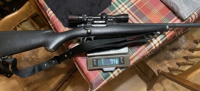

I'm just getting into hunting, and I built a rifle that weighs around ~12 lbs to provide some reference. I'm young(ish), in moderately good shape, and using it on relatively flat topography walking around about ~6-8 miles per day. For this purpose it has worked quite well, I have no qualms with the weight.
Would my rifle work or be optimal for someone that's going to be doing high elevation hunting that covers a lot of elevation gain over a series of days? Probably not unless they are very physically fit and don't mind the extra few lbs.

My current hunting rifle is 9.5lb-10lb, and I feel it is maybe a bit on the heavier side for a standard rifle calibre. Although, when configured as a magnum it is appropriate (Blaser R8 Pro Success, Razor LHT 4.5-22).
Aiming for the 8lb range would be ideal to me, but to qualify that my hunting is often in hilly terrain - a lighter rifle equates to having the flexibility of taking my tripod more often.
I’m youngish, fit and strong, and have carried plenty of packs and rifles in the hills - an approx 8lb rifle is more versatile to me. Closer to 10lb is good for hunting magnums is my opinion.

My two primary hunting rifles weigh in at 7 lbs 9 oz and 8 lbs + respectively. They are both standard sporter barrels in fiberglass stocks and made to be carried a lot. I have shot them out to 500, but they are NOT what I’d consider long range rifles even if they are custom. They do the job well, but I’m either in some very steep country or dealing with high desert and lava beds for hunting ground so weight can really make a difference.
I forgot to mention that they are. Purpose built rifles meant for long Walks. I have a second Custom Mauser in 22-250 with a heavy barrel meant for Pdog/ground squirrel shooting that weighs in at 15 pounds. It’s my 25 yard gun, most times it isn’t packed more than 25 yards
Remington 660 in 7mm08
Mauser ‘98 in 22-250
