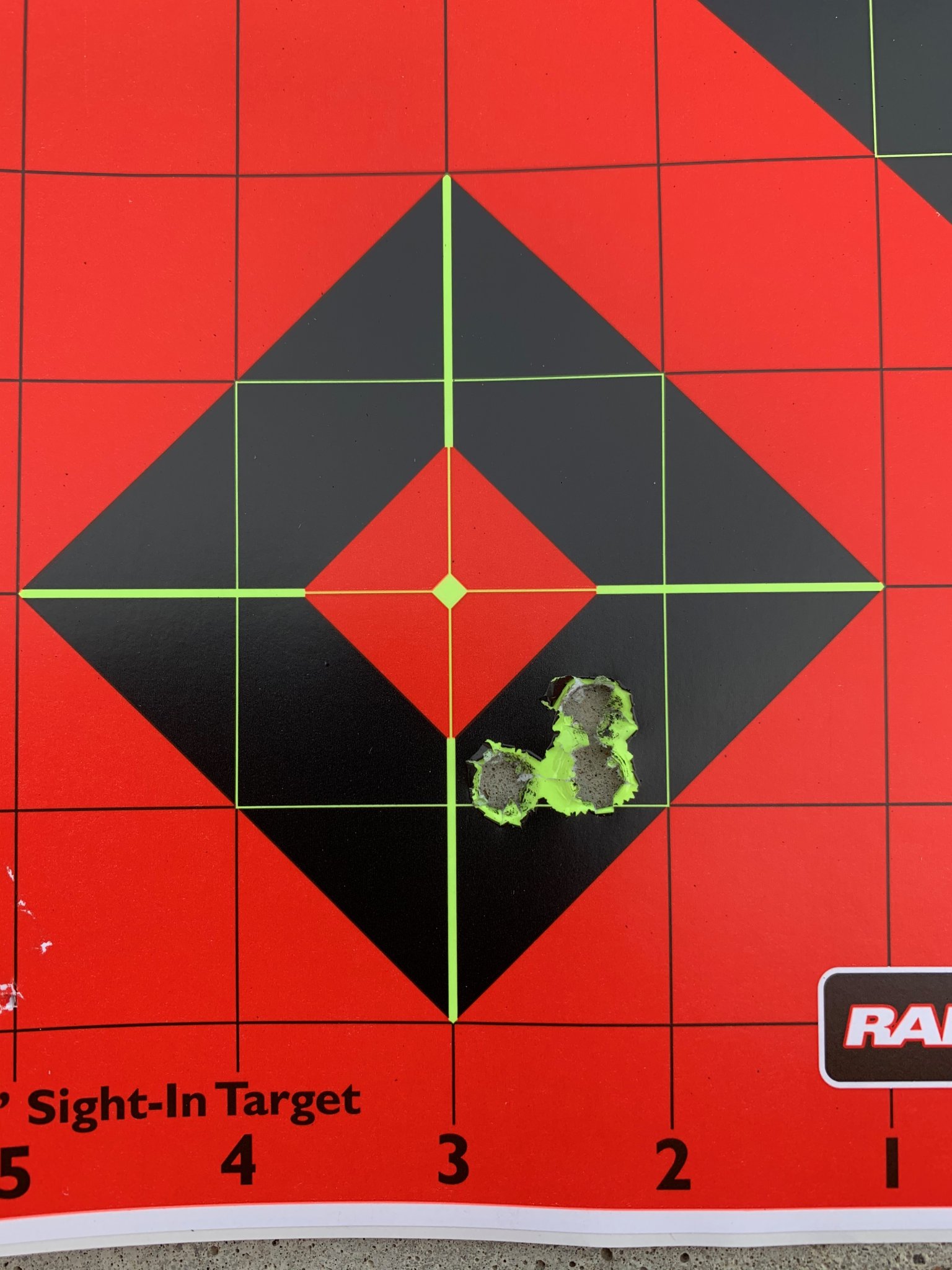

This rifle right out of the box, no matter the version is Sub MOA groupings. If the scope you chose is quality for the shooter, than you should easily be able to shoot sub MOA. The rifle comes with a Hogue Overmold stock, which I was a little nervous about when ordering it, but I came to the pleasant realization that the stock is amazing. (I have the 7mm Rem Mag version, and the gun barely kicks at all.)
