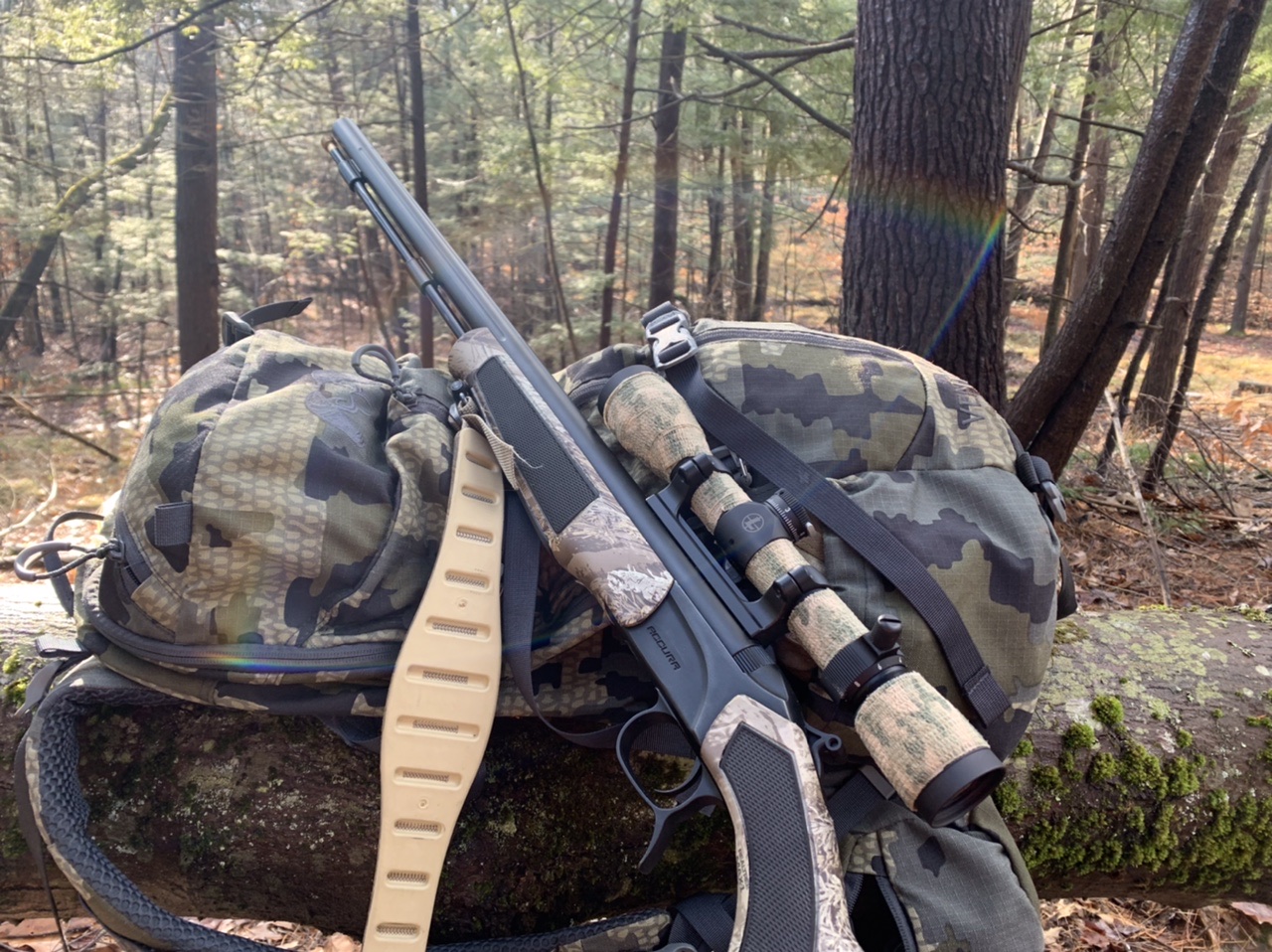

    I have a Leupold VX-3HD on my muzzle loader. The CDS dial with ZL is great. Nice FOV and glass. Very happy with it.
