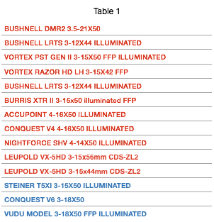

Here are the scopes I am currently looking at that will fall in my sub $1000 budget, the bottom 3 I would have to expand my budget a very little. I am leaning right now between Doug's deal for the Bushnell or possibly the Vortex Razor HD LH.... I plan on purchasing within the week, so what says everyone, based off the ones listed,
Razor HD LH is SFP.
