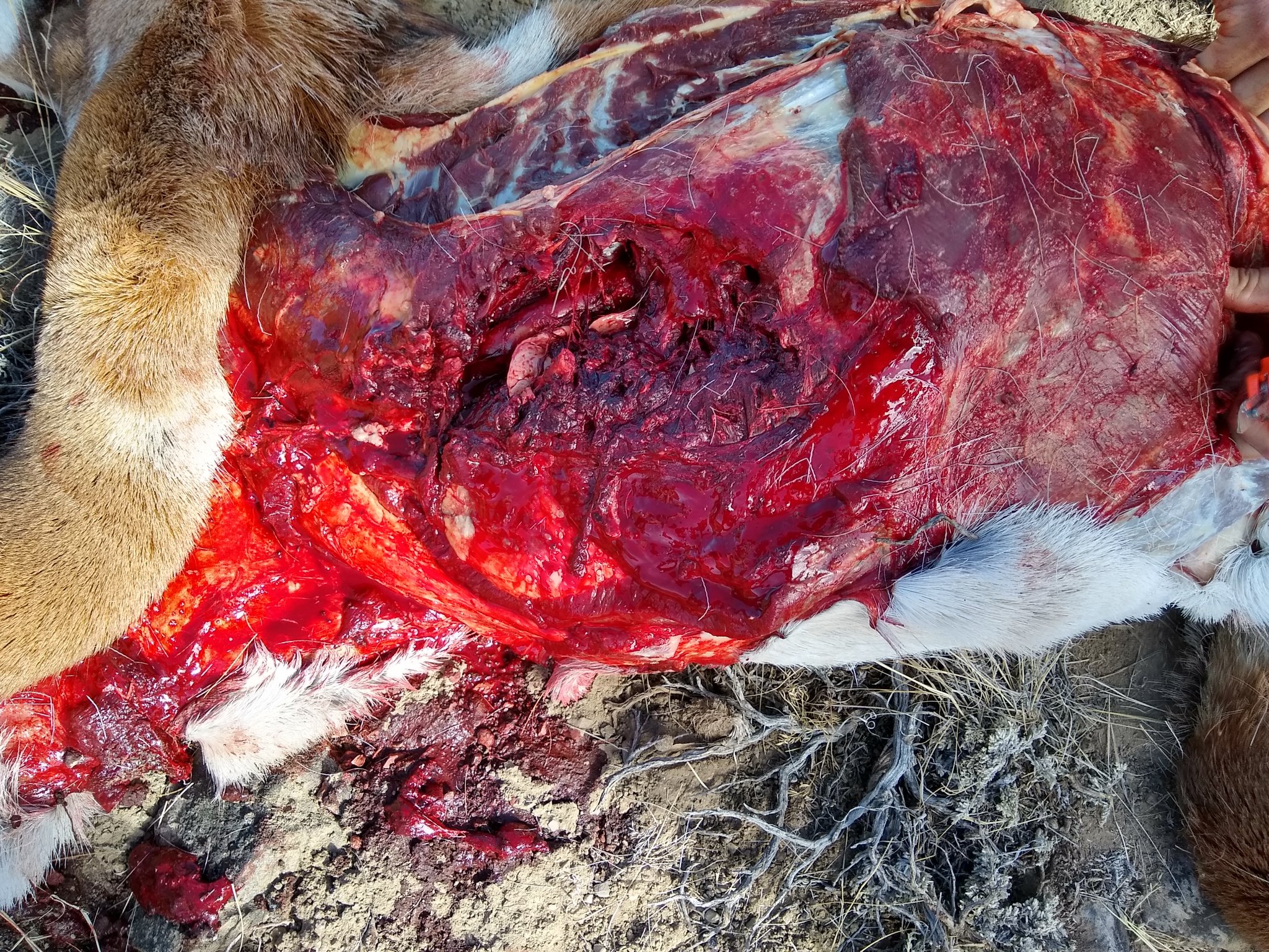

    Berger 156 6.5 PRC frontal heart shot. DRT
    Reactions: Flather18
    Muzzle velocity was 3060 fps. Not a far shot but 140 yards w fading light, shot off my knee w crooked crosshairs. Only line of sight was through a crotch of a tree. Lol

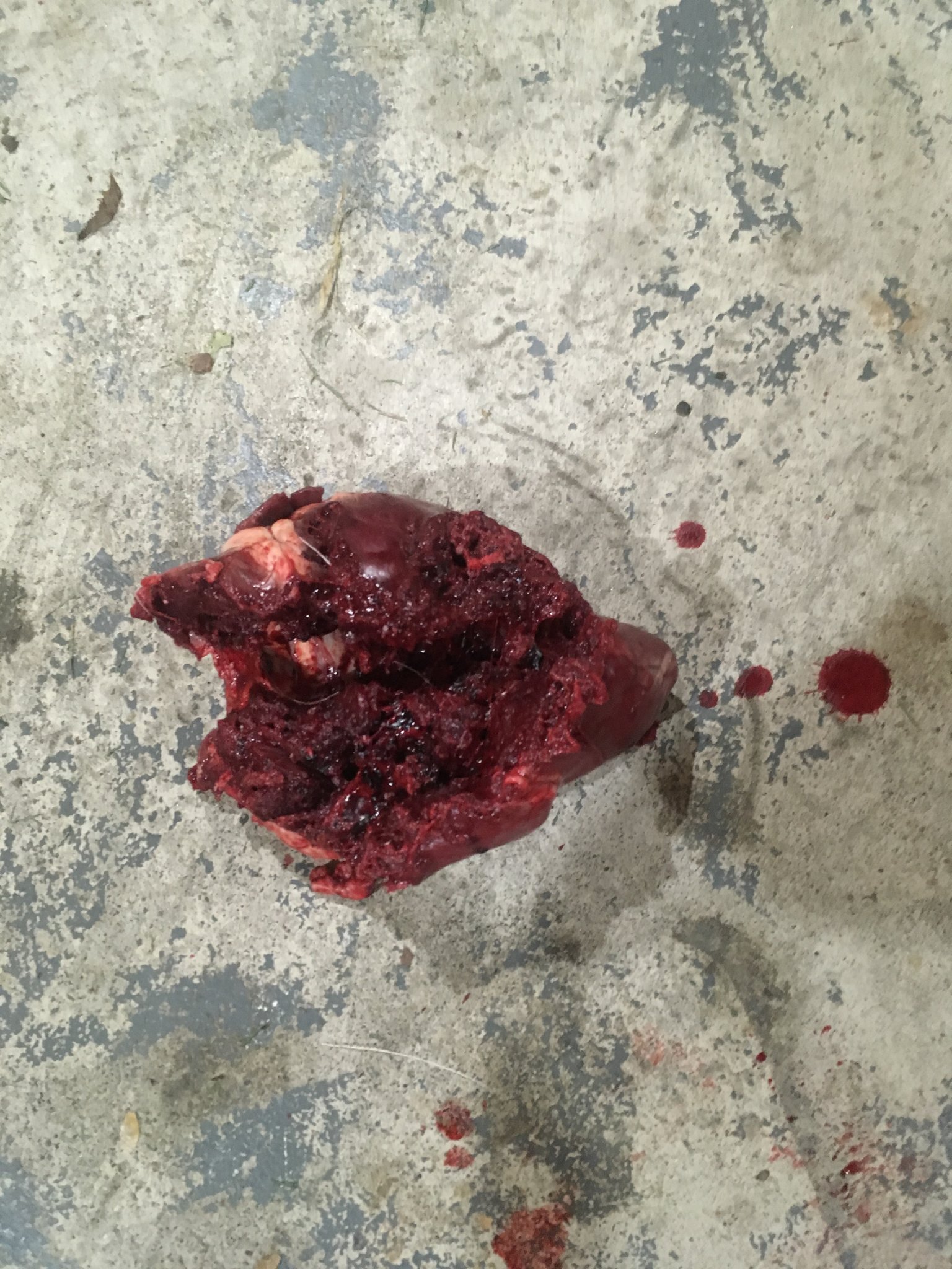

    6.5x284 Norma +P -- Berger 156. This was at 317 and broke the offside leg on exit, honestly it was going too fast. This rifle took both of my and my dad's speed goats this year and my muley. All were DRT

    First pic was shoot with the 6.5 140 eh
    Second 7mm 175 eh
