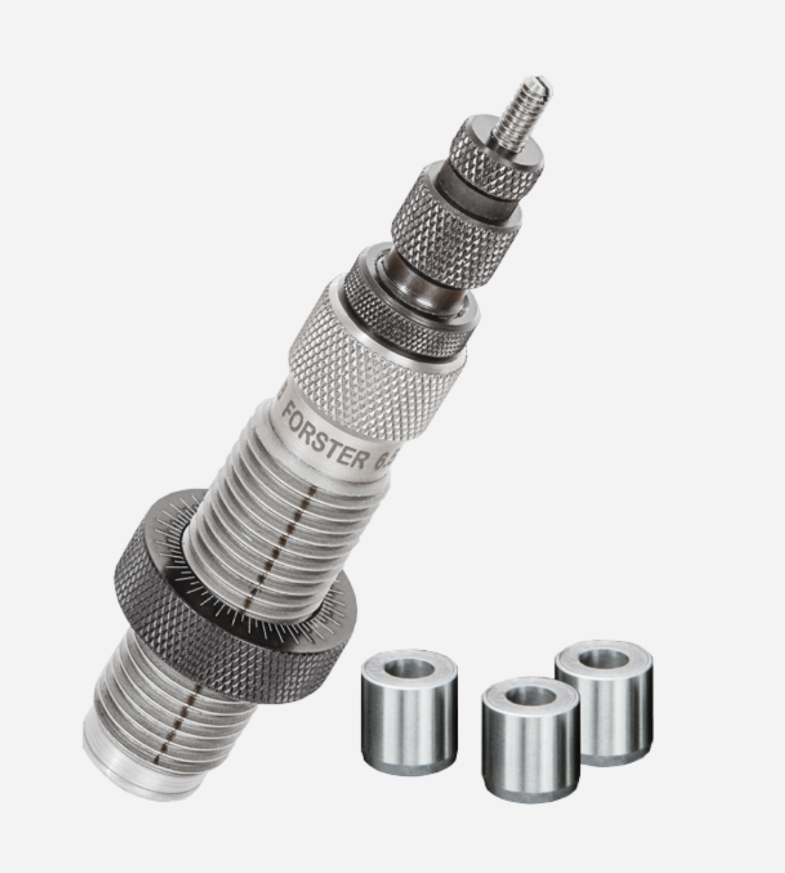

What type of dies are you using? I only have one type of bushing die, and it has the decapping pin, which is thicker than just the pin itself, but it is not big enough to size the neck up when pulling it out of the case.

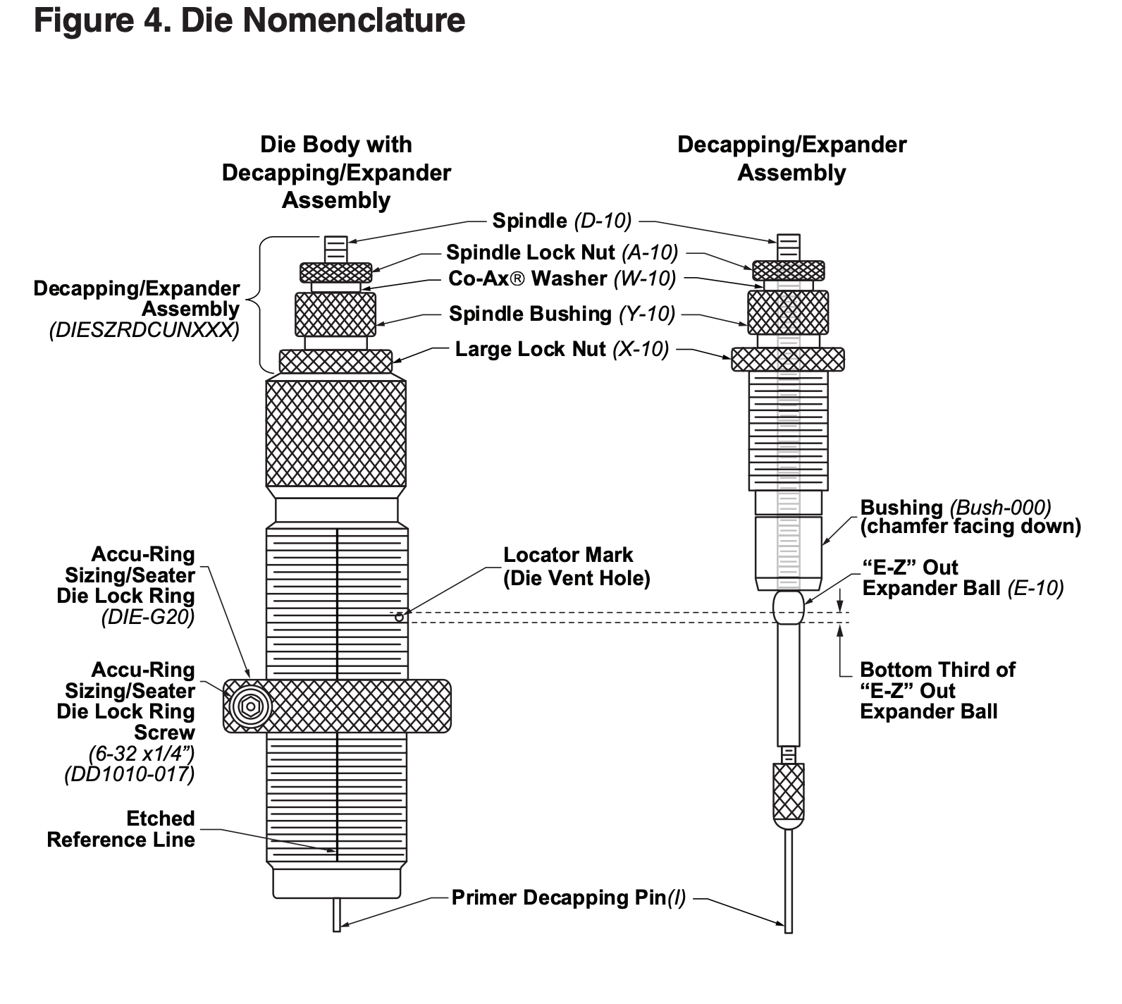

This is a Forster Products full-length Sizing Die. I just looked at their instructions again, and I see they call this expander ball an "E-Z" Out expander ball. Maybe that does mean it's not really doing anything! :)

I stand corrected. Shouldn't make blanket statements when I haven't used every die out there
