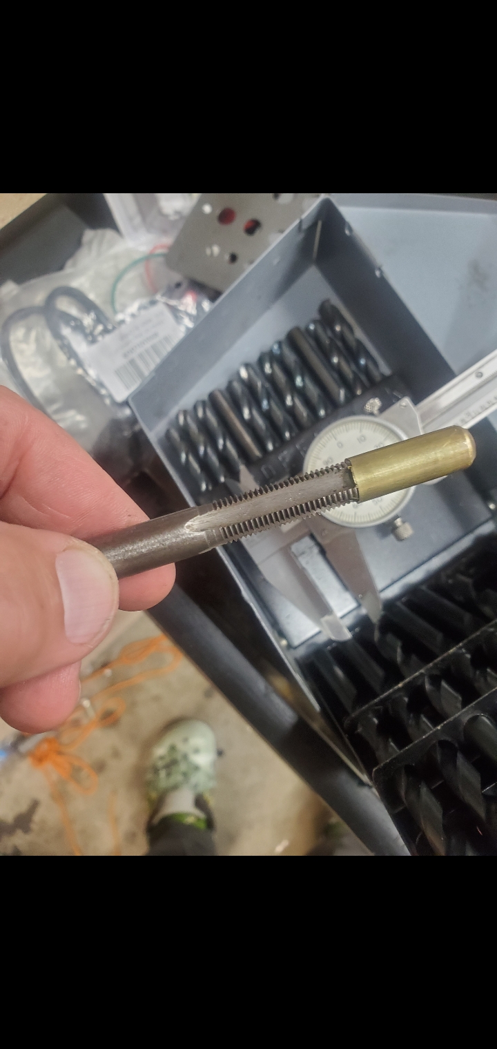

NO help on YT, or anywhere.
The full shit of reloading just happen at once.....
I was reloading my older .260Rem Lapua cases, and then this one comes out.
These were the cases i did reloaded with the older RCBS Summit press, and the one who know, do know..
That case is tight as MF!!
I have tryed everything, rat tail file, tap drill, heat, f...K.
I have one idea, to use epoxy putty, put a full kit in, and the same time a threaded bolt.
Once it settle in, try to to tap it out.
My friend also told to dremel it out, but i just feel that i can fuck this up like totally with that.
Like i told, there is a million ways to get the case stuck in the die, but what the fuck, when the case mouth is also gone.
My friend knows a friend, told that a acid bath would be one way to get that brass out, might be one.
But is there any one on this forum, who has been on this shit, where i am at the moment, and could tell me, what to do.
Thank you all ready...

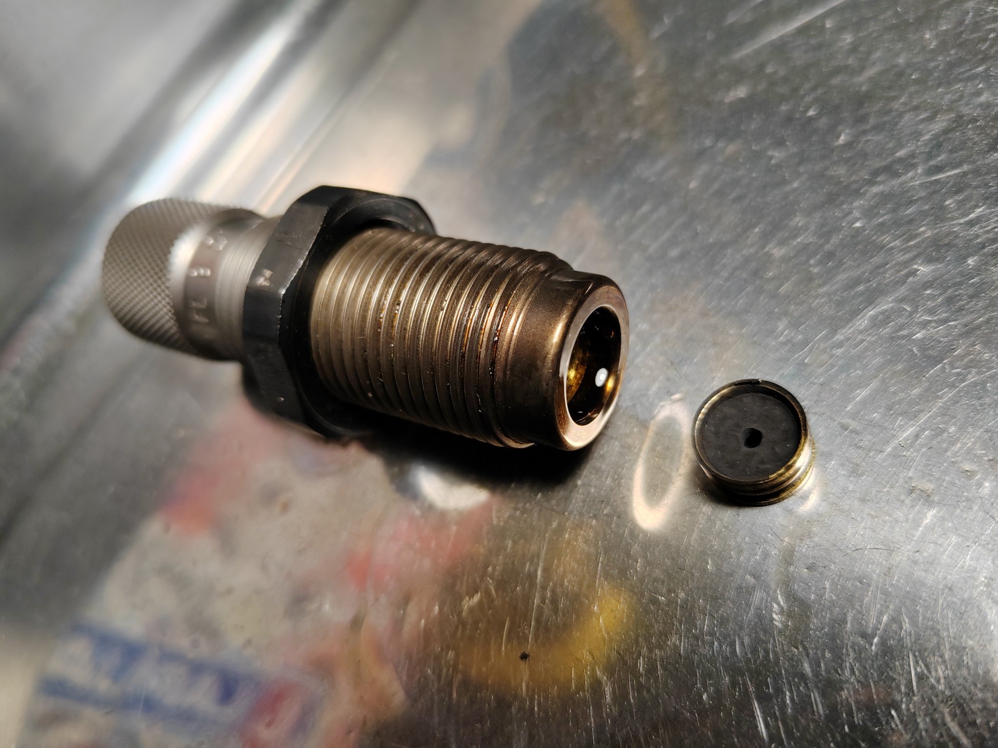

possible alternative methods...
if you really need to mac guyver this thing
plug the neck and epoxy-cast the chamber body.
(follow the directions correct chemical bond)
insert a handle into the un-cured expoxy cast.
remove via the handle.
For a handle, use a threadded mini-eyelet
with a screw spaced out on it...like pic related
alternatively, use the drift-punch method,
and punch out via the neck aperture, but using
the expoxy plug to reinforce the neck of brass.
It´s the RCBS, the die manufacturer, and it is the Matchmaster, that is why i am so f..d😭
Don´t know cry or laugh...
Guys, DO not reload too old brassssssss.
Just to add to that dont overwork your brass leaving your headspace to big causing your brass to thin out ahead of the case head or that can happen. Atleast it happened in your die and not the rifles chamber.
You might want to inspect the rest of your brass in that batch.
I used something similar to @ma smith with a 300blk case.
I JB Welded into the case body a bolt, leaving enough space to get a set of channel locks on the bolt stem between the die and the bolt head. Then with the die back in the press gently tapped the channel lock handle with a hammer and with a couple attempts out it came. I dabbed the bottom of the die with vaseline to make sure the JB Weld did not bond there.
Liquid nitrogen might be hard to get a hold of... But some dry ice (CO²) might not be...

Wow. Never seen that happen before, but I have considered the possibility of that happening...
First thing I would try, if you have one, is a broken case extractor, but the case is probably so stuck in the die it probably won't work-- and you risk the broken case extractor messing up the neck area of the die.
You might try plugging the neck and then soldering a piece of threaded rod into the case, and then use a nut and washer against the bottom of the die to pull the case out using the threaded rod similar to a stuck case extractor kit. You could also tap on the solder plug with a punch through the neck while tightening the nut.
Solder will adhere to the brass quite well given all the surface area and mechanically lock to the threaded rod. As long as you don't use acid core solder, it should not stick to the steel die, although I would advise not filling the case up with so much solder that the level overflows the broken case. Also try to avoid excessively heating the die which could mess with the heat treat. A 60/40 solder melts at about 370F which is highly unlikely to mess with the heat treat on the die. The solder will also shrink more than the steel die as it cools which may help pull the case away from the die and help unstick the case from the die.
You could also try the same method above with a good epoxy instead of solder, but protect the exposed piece of the die with mold release or grease so the epoxy won't stick to the die. Using epoxy also means waiting for it to cure before trying to remove it, while with solder you might be back to using the die in 15 minutes.
For those suggesting freezing it, keep in mind brass vs steel is only about a 5 x 10-6 difference in linear CTE, so even a large temperature change creates only a small difference across the relatively small diameter of the case. Even if you quench it in LN2, from room temp to -320F is only going to shrink a .473" diameter brass case about 0.0009" relative to the steel die down at the case head, and by about 0.004" relative to the die over the full 2" length of a .260 case. I bet the die was working the brass quite a bit more than 0.0009" for it to stick so hard it separated the case head-- so it probably isn't going to just fall out after an LN2 dunk.
And as others mentioned, it's time to check all your other cases for impending case head separation, and also check to see if you're bumping the shoulders back way too far each sizing leading to case thinning and possible case head separation. While having a headless case stuck in the die sucks, I'd honestly rather have a case head separate in the die than separate under 60ksi of pressure in front of my face during firing...

I did manage to get the broken case out of the die.
Dremel i did used, that´s the only thing i had on my hands, and i tryed many different way.
I did cut the case about half way with the dremel, i tryed to be as gentle as i could, my first girlfriend might not feel the same, me being gently :D
But the case is out, die is still working, and i did tested it, so thank you very much all the help, i do apprecciate that.
Here is the video i made, i was not sure at all, few points i was about to quit and just admit, that i am a looser, and i wont be doing it, but then i took some SISU, something, only Finns have, and i made it.
But the best way it would be, to take it to a gunsmith, put it in to a lathe, and tap it out.
But this is the way i made it with DIY method, not the best but it did worked.
