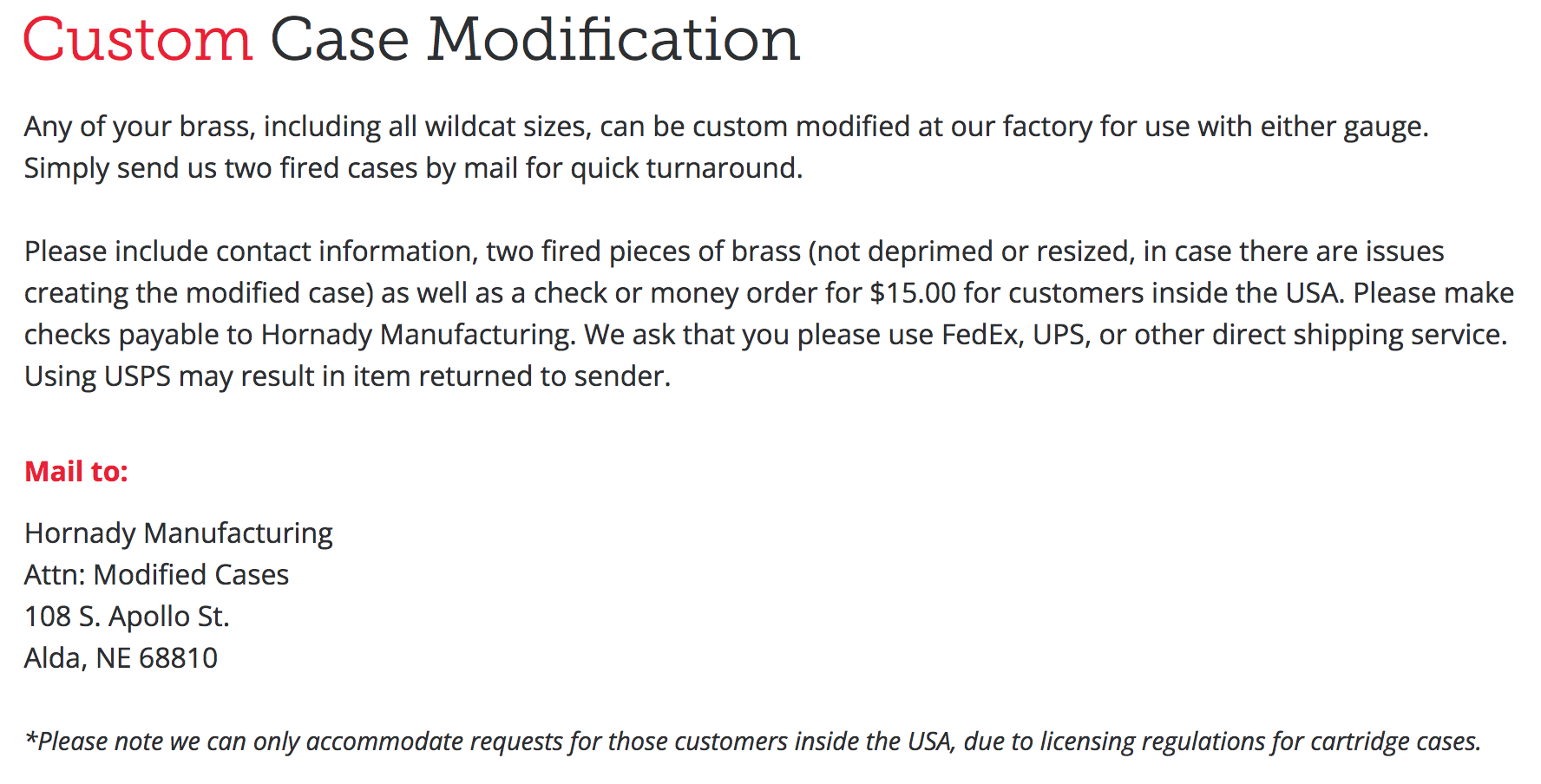

I am in Desperate need of a Lock-N-Load A-300 Winchester Mag Modified Case
In stock at Creedmoor sports.
Never used these guys, but as able to add to cart and is in stock.
If you send Hornady a case that has been fired in YOUR rifle, they will make you one for not a lot of extra $.
Reactions: Baron23

  8. Take your COAL / CBTO measurement.
I found that this procedure gives CBTO measurements to the lands that are much more consistent than the Hornady tool ever did.
My $.02.
^^^100%, this works much better actually than the variability I get with the Hornady product. Marc from Spartan rifles does the same. This is the same process as the Hornady if one was wondering. It is just the viability in the ultra-light case neck that makes it harder to get a consistent reading as pointed out above.
