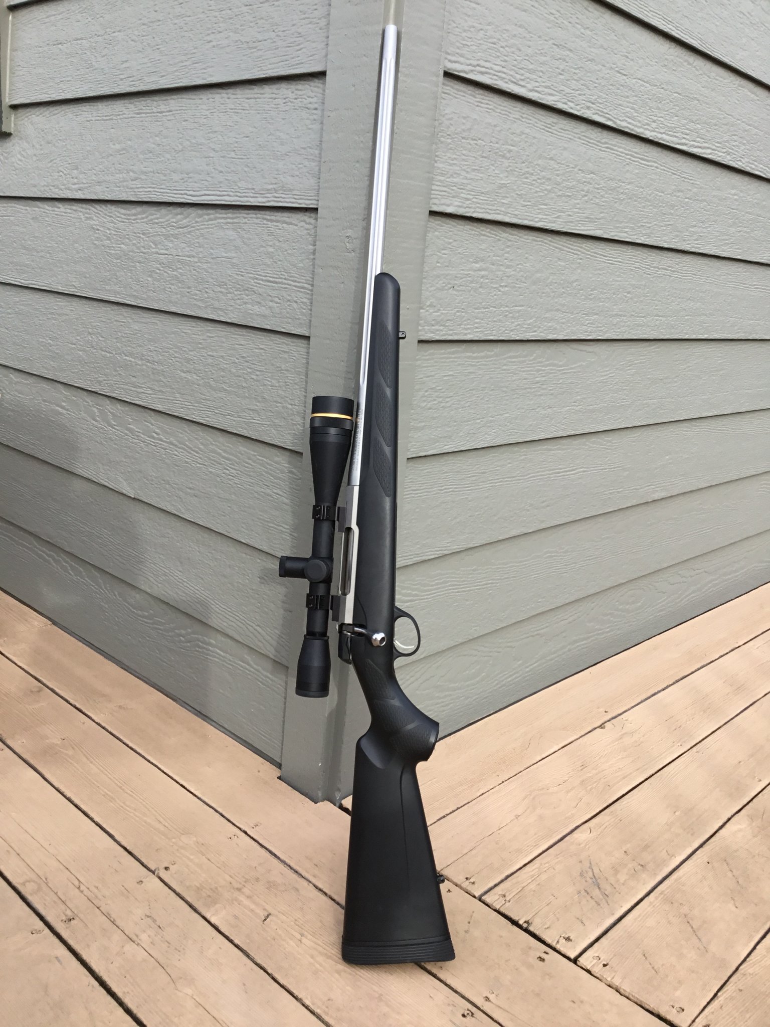

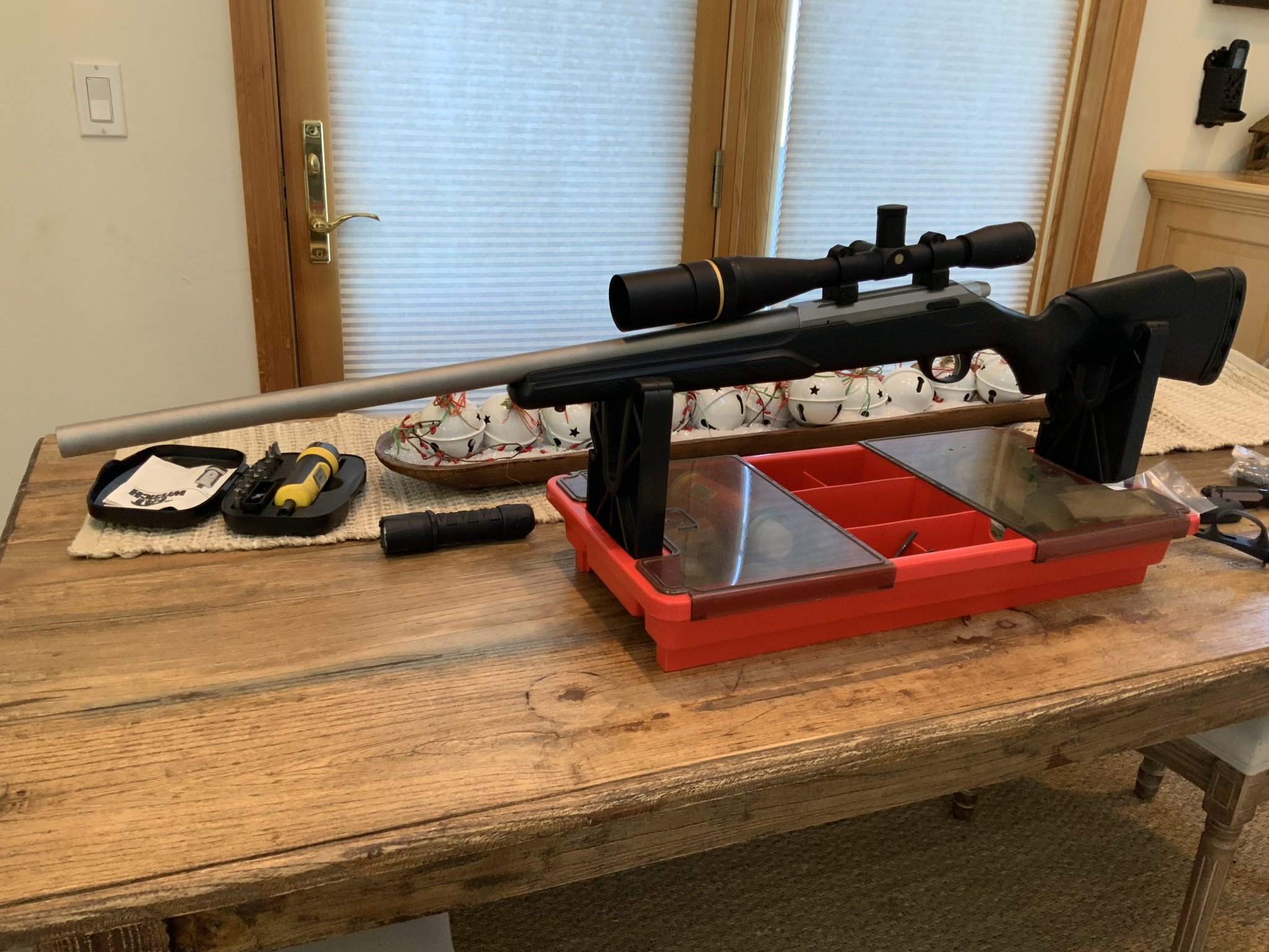

I’ve been looking for a stainless T3 Varmint in .223 for a long time. I posted a WTB over at 24hourcampfire back in Feb and a guy sent me a message a couple of weeks ago that he had seen holy cow’s ad here. So I joined your party and made a deal with holy cow. Great seller.
HC said the rifle was probably unfired and I’m sure he’s right. Either that or someone went to a lot of trouble.
All of my Tikkas wear Limbsaver recoil pads so I put one on the Varmint. It keeps the LOP consistent. I installed a Yo Dave trigger spring as well as an aftermarket bolt shroud. Warne mounts and a Leupold FX-3 12x40mm AO Target and she’s ready for the range.
My 1-8” Tikkas all shoot the 75 grain ELDM exceptionally well. I’m hoping this one does, too.
Thanks again holy cow.

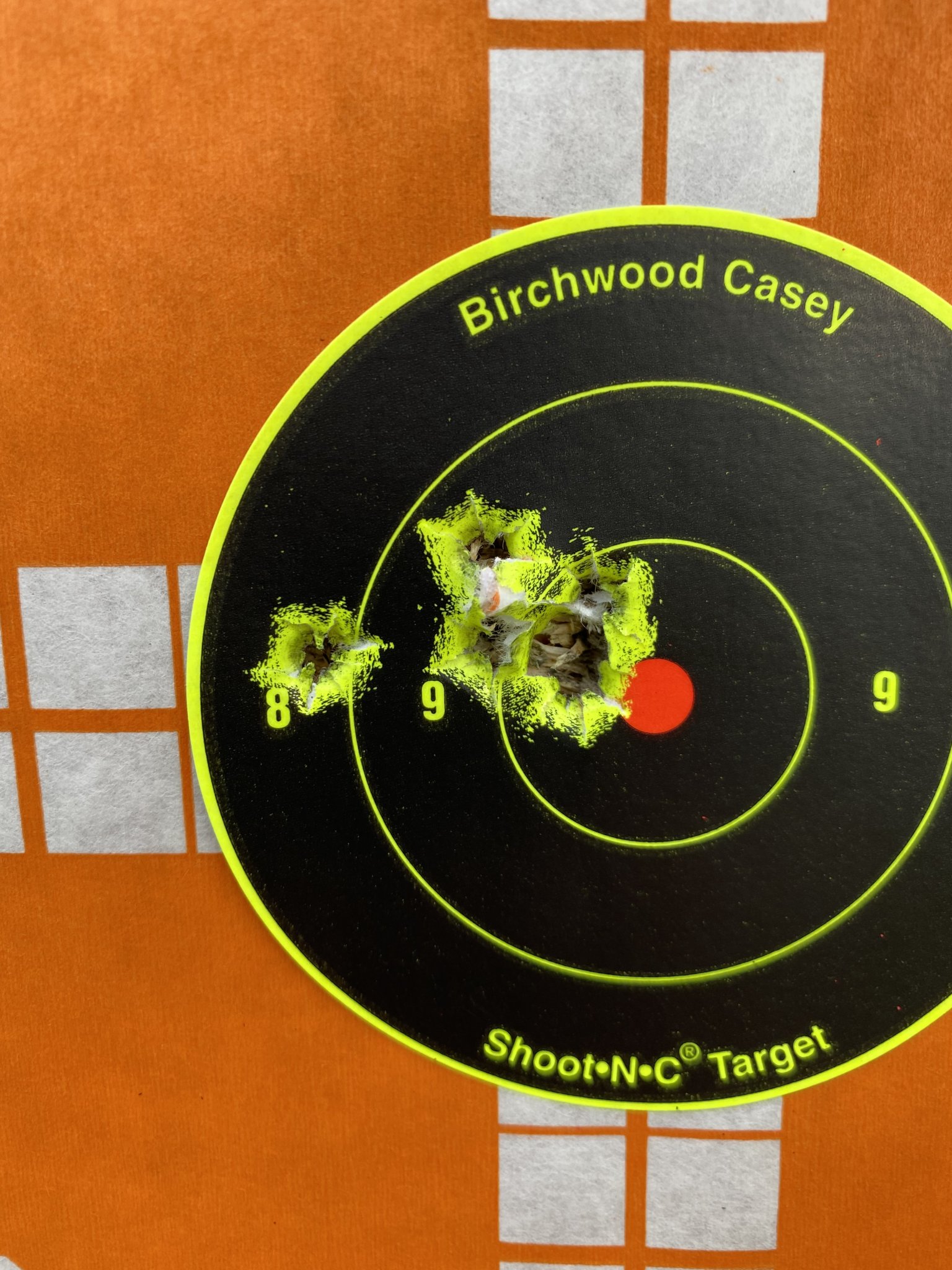

Well, she’s a shooter. I started off with Pest Control, my 50 grain Ballistic Tip Varmint load.
Three shots on the left are the first three at 100 yards after getting on paper. Two clicks right are the two holes (three shots) just left of the red dot.
One more click right and the bull was gone.
Disappointed, though, that she didn’t like the 75 grain ELDM load. The good news is, I get to work up a load. That’s always fun.

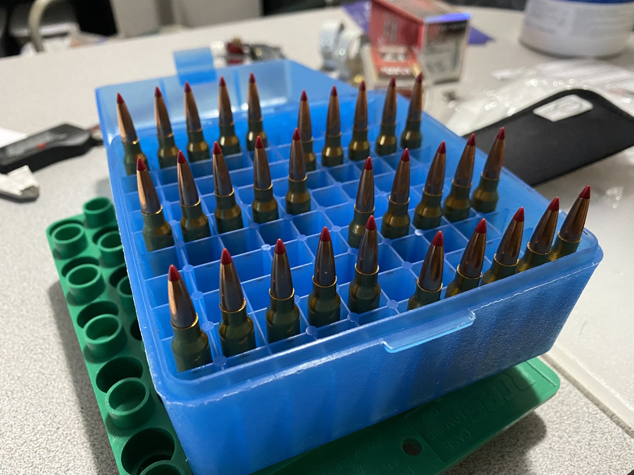

Next stop, finding a replacement 75 grain ELDM load. I measured distance to the lands at 1.940”. I started there, then moved in to 1.900”, then in one more time to 1.875”. I already know that 25.0 grains at 1.915” is a no-go.
Two charge weights of Varget, 25.0 grains and 25.5 grains. Five rounds each at each charge weight and seating depth for 30 total rounds.
I might get to the range this week. I have TAC to try if Varget doesn’t pan out.
The BT Varmint load (Pest Control) is a great fallback but goes subsonic around 750. The ELDM stays supersonic past 1200 with way less wind drift. And I have a bunch of them.

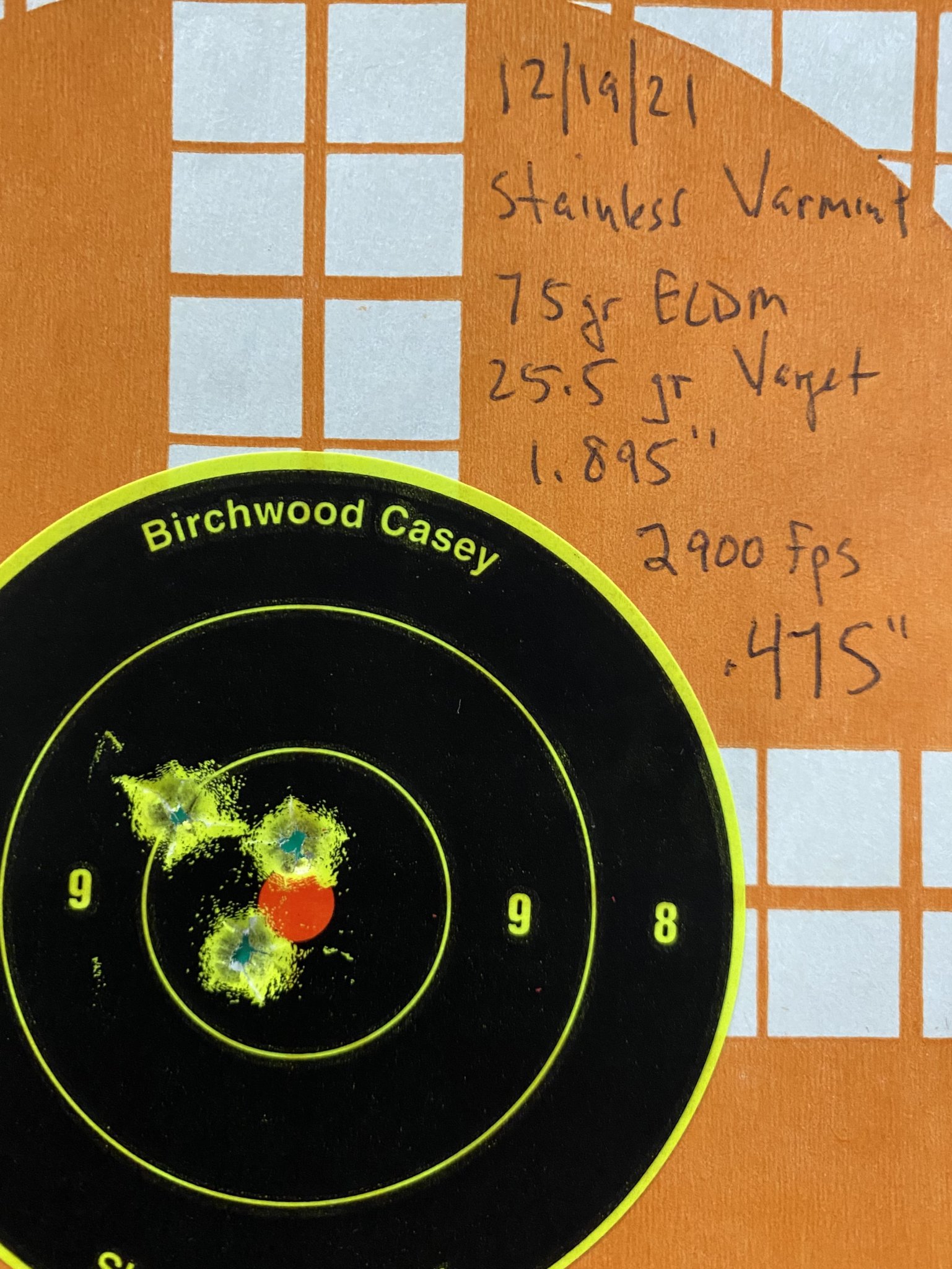

Hit the range today with more choices. I brought some 1.900” as well as 1.895” and 1.905,” looking for a little tighter performance. My timing sucked, however, as the wind was blowing pretty hard. Oh well.
The 1.905” loads weren’t as good, but the 1.900” load was a bit over .4” in the wind. The 1.895” did just a hair under .5”. I didn’t shoot much.
Quarter-inch squares, 1” sticker.
1.900”
1.895”
I chronoed both loads. 1.900” averaged 2924 fps with an extreme spread of 42. 1.895” averaged 2896 with an ES of 5. Not too shabby for just the second outing.
