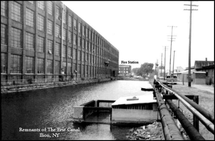

In fla for winter. With the closing my son moved here permanently. He will post one photo from his phone not of us, but my father who worked there about 35 yrs, last several in R,&D where he was the first regular employee when they opened.
As far as plant closing thanks to our idiot state government which is controlled by about 5 or 6 heavily populated counties out voting the other 60 conservative counties, it will hurt but they'll probably survive. One of the major hopes is the fact that we have a very historic area and Cooperstown baseball hall of fame and museums not far away and the recently opened Erie canal trail becoming very popular. One of Remingtons main buildings was built on the Erie canal so they could load directly
onto the boats.
onto the boats.View attachment 8309350

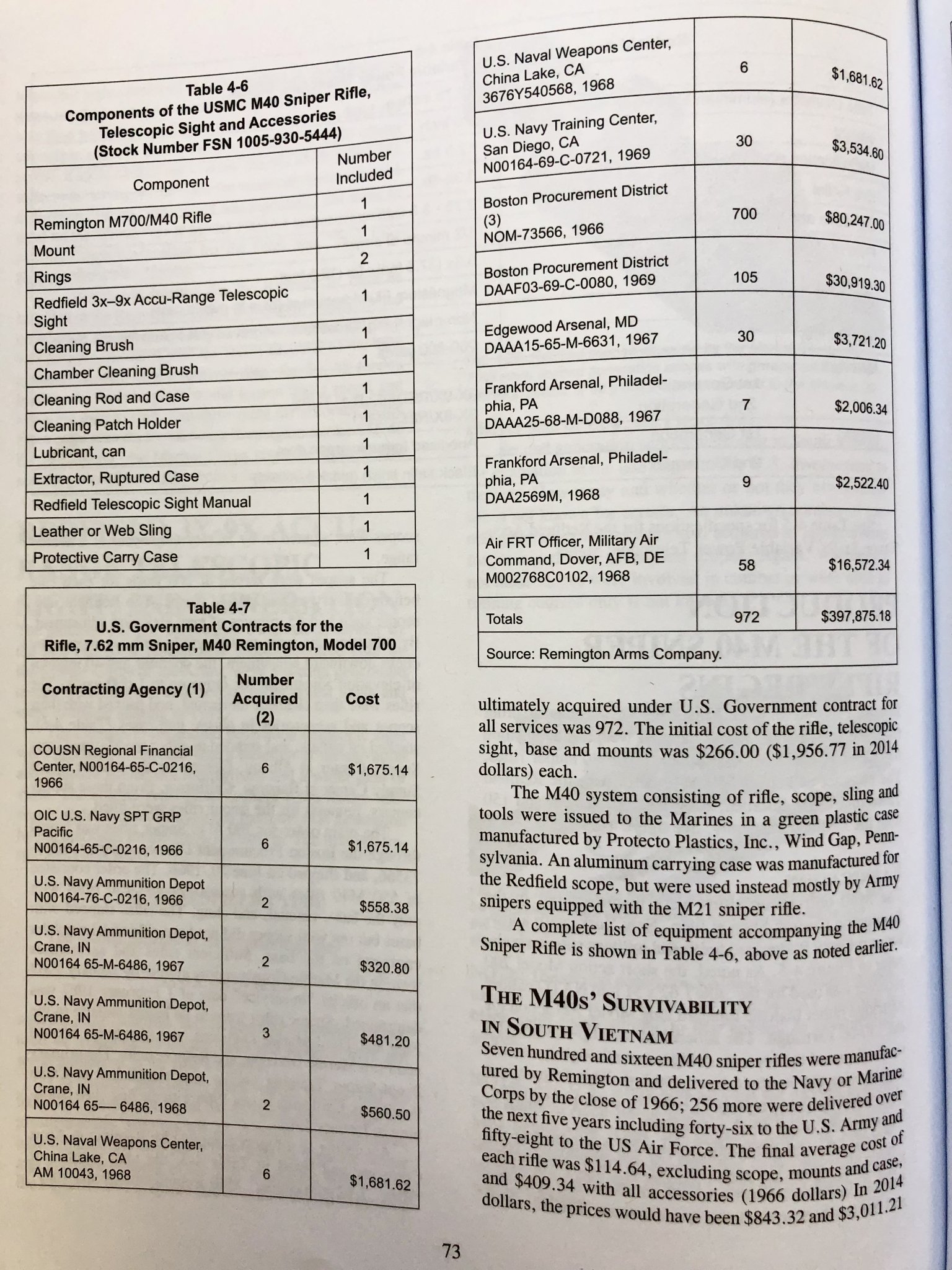

The one mystery order was the 105 rifles ordered in 1969 by the Boston Procurement Office, as the end user is not known. (The 1966 order out of same procurement office for 700 rifles was clearly the original USMC order).
I recall reading somewhere that by '69, only around half of the original 700 M40s were still in serviceable condition or even in the hands of the USMC. My tentative vote would be for replacement rifles, perhaps for supply to foreign militaries or federal agencies. After all, the UK and Aussies bought AR15s/M16s early on and it was the Cold War. We sent folks all sorts of fun things to shoot commies with back then.

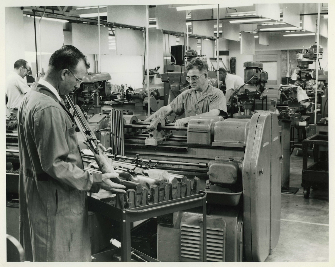

Yes, that's my father Lloyd (Hoppi) Haponski working at the rifling machine. As you can see it does 2 barrels at the same time. It pushes a carbide plug ( button) about 3/4" - 1" long with the rifling cut slightly off parallel on it, so the plug turns slightly as it goes through the barrel putting the 1 in 8, 1 in 10 or whatever twist is required. You can see a truck of drilled, ready for rifling barrels beside the machine.

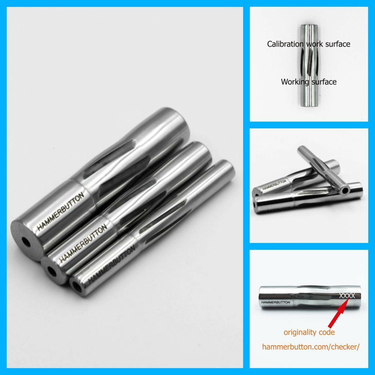

These photos of rifling buttons are much longer than what we used, must be newer versions. I have a couple of those we actually used at home. When I get back there will try to find and post them.
