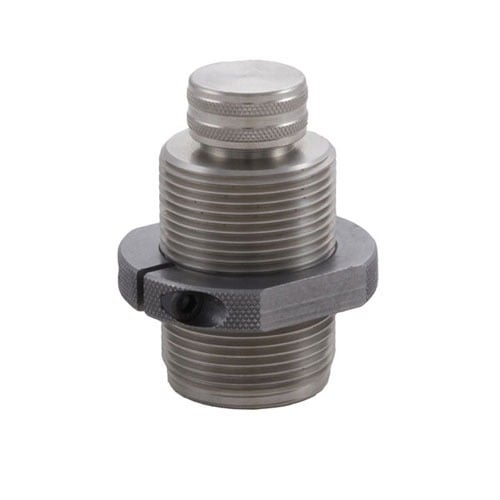

If you want to keep it simple you can buy Forster two die sets with FL sizing die(non-bushing) and what they call their "benchrest " seater die . This will get you started with quality dies . You can always get their bushing dies and Micrometer seater if you want to upgrade in the future .

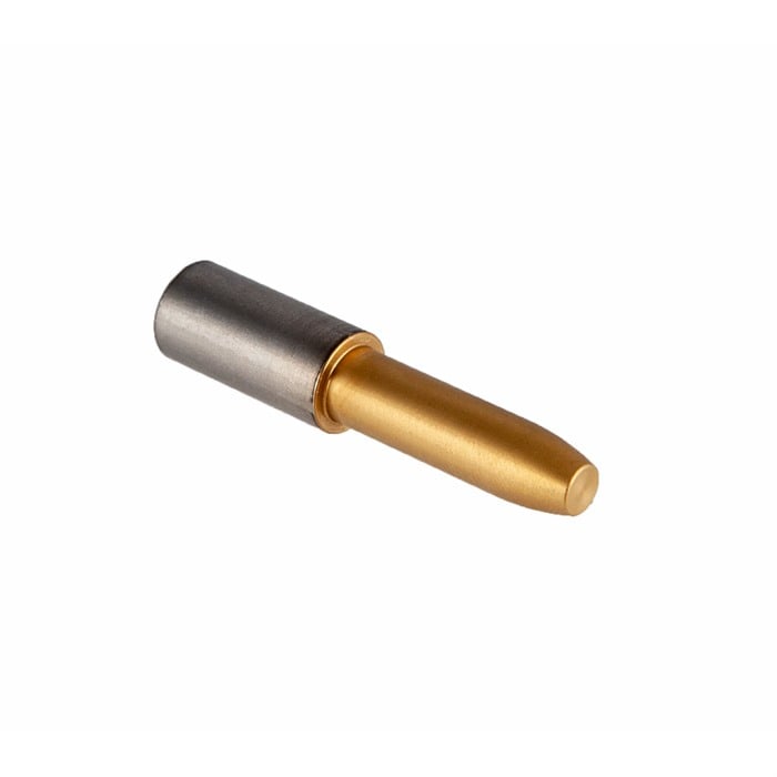

Cortina makes a mandrel die that uses 21st centry mandrels. You’ll need to buy a few mandrels from 21st century.
Forster mic seater die works great!!

You can buy an expander mandrel die separately later if you choose to go down that road (the necessity of using a mandrel is still arguable, but I think is worth doing if you're after crazy low SD numbers), for those I prefer the Sinclair die body with their TiNi "turning mandrels" (-.002 bullet diameter).
