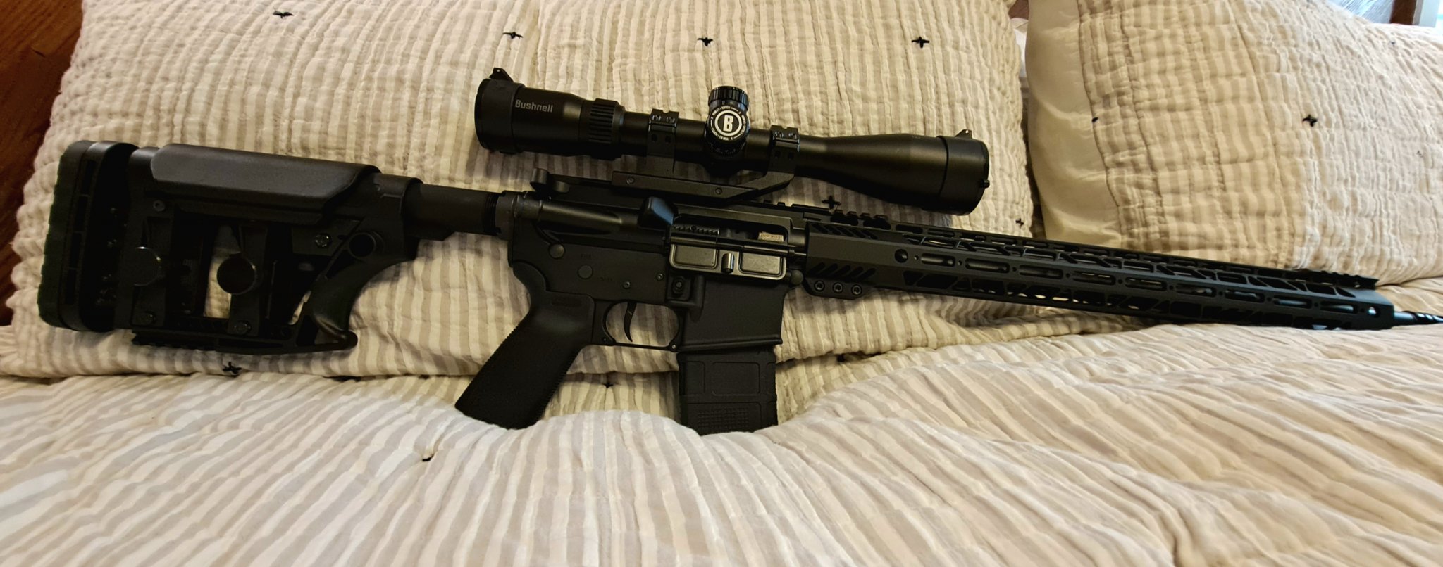

I don't know much about semi-autos
jlorensen
Dec 9, 2020
131
135
Kansas City
Generally speaking, I'm a bolt gun guy....but I do own an older DPMS AR-15. It mostly sits in the safe, but my son has shown a recent interest in it. I'm wondering about the feasibility of swapping out the upper, adding a better trigger and scope, and ending up with something he can shoot at steel out to 300-400 yds (recreationally).
In your opinion, would something like this make sense, or would I end up spending money on something that isn't worth it once assembled?
Thanks!

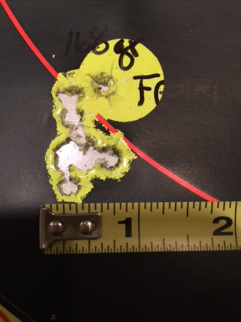

Do you know what kind of accuracy the rifle is capable of as it sits? It may shoot well as it is. Put a scope on it, preferably 10x or higher and see how it shoots at 100 yards. You’ll want to use 69-77 gr match ammo which will cost you but there’s no way around that. Reloading can bring the cost down in the end but if you aren’t set up to do that just buy some good ammo and go see how it shoots.
I've shot this rifle at 100 yds, and from what I recall, 1.5-2" groups is about all it would do with factory loaded varmint ammo, and some Hornady Black. I'm not expecting this to be a super tack driver, just looking to get my kiddo away from the video games a bit......so we might be good.....buying a larger gong might be a viable option as well :rolleyes:.
Maybe a different upper with the same accuracy expectations could come down the road if he maintains interest......it would be a nice winter project.
Thanks!
3-400 is easy with a eotech on a 12.5" gun. Throw a scope on it and see how it shoots. I was at the range yesterday and my buddy was working the kyl rack at 1000y with a 20" scoped ar in 223. 13.5 mils to get there. It was fun spotting watching the bullets literally fall on the targets.

Well, talked to a buddy and he loaned me a Rise Armament trigger (Rave 140). From what I've read, it breaks around 3lbs....not sure if that's accurate, but I can tell you it's leaps and bounds nicer than the OEM trigger. Now to decide if I buy a scope, or keep the red dot!

FWIW... my 18" MLGS 308 PSA FN CHF barrel shoots very well. I did lap the upper and Loctite in barrel, as well as snugging the upper to lower fit.
10rds Hornady 155gr AG , rapidish fire, 100yds, scoped , benched, blah, blah, blah.... I flubbed the flyer.
A typical 168gr FGMM group...

Everything has arrived except ammo. Still need to put everything together and get a photo, but in the meantime, a question....I noticed the flash hider on all three of these uppers have slots cut in the top but not in the bottom.....As the bullet exits the muzzle, would there be an imbalance of gases surrounding it that might cause accuracy to suffer a bit? Or am I over thinking it?
