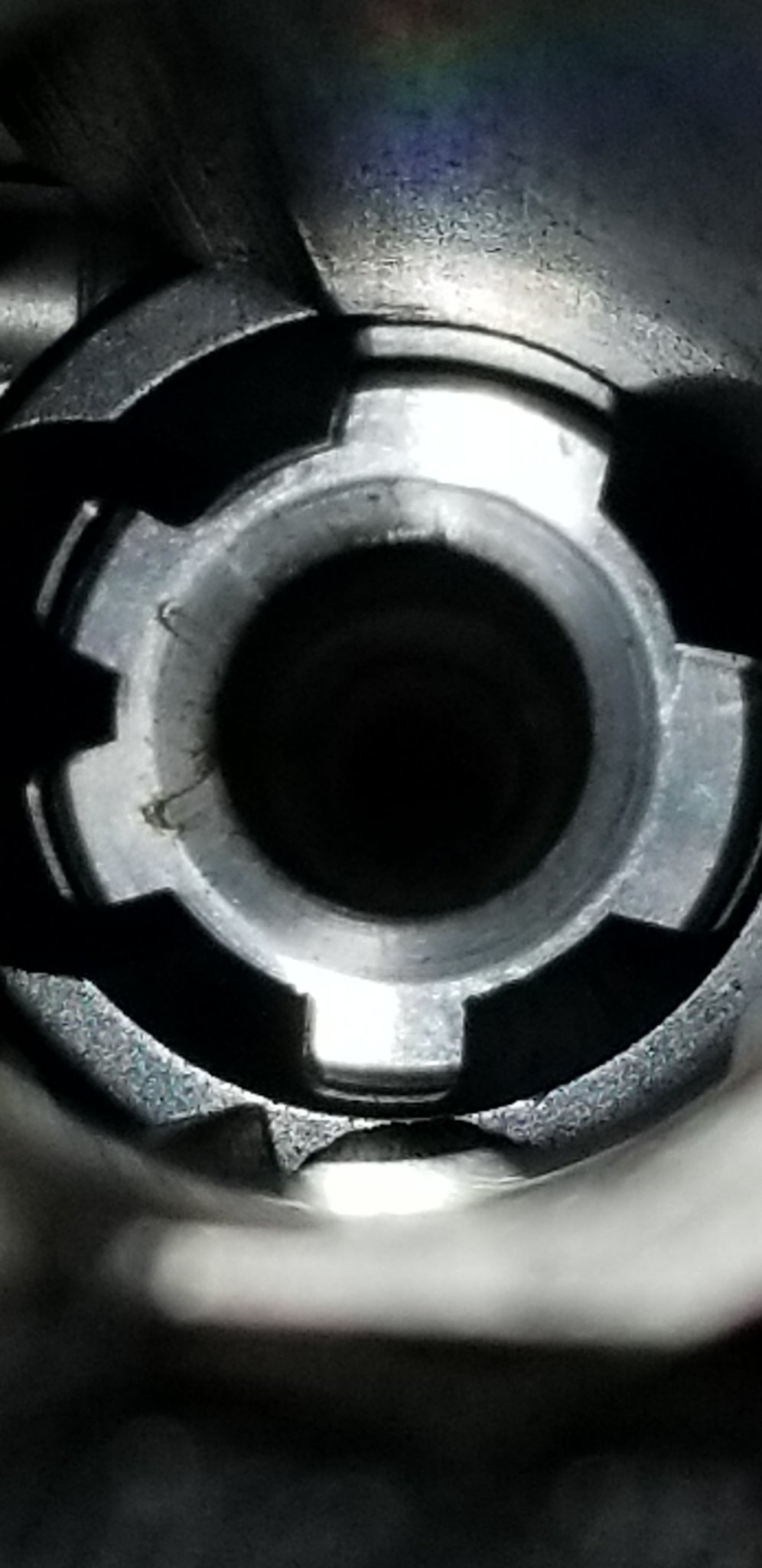

I got feeding problems with my Q Fix rifle
That’s what happen

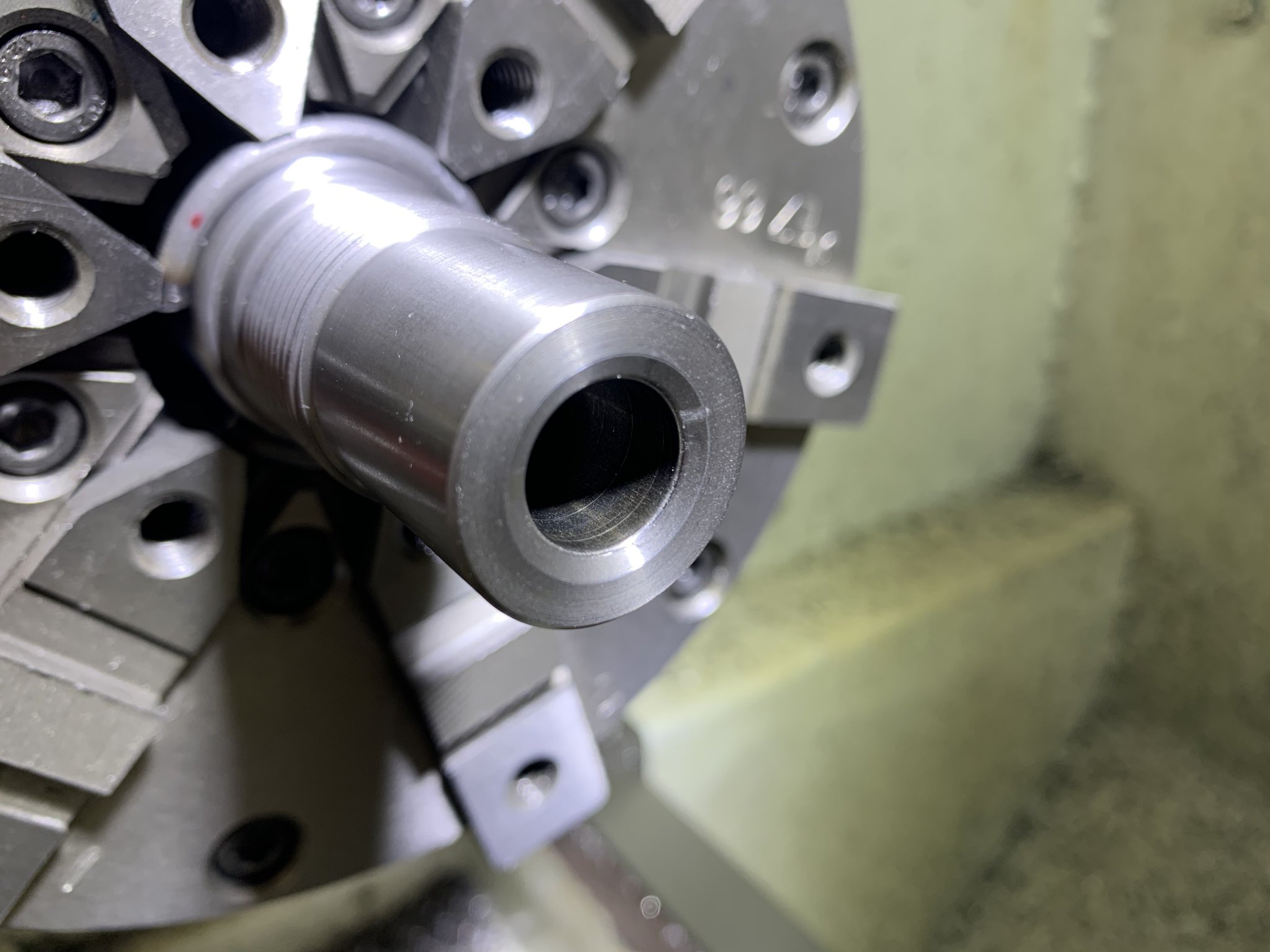

FYI, this is the response I received from Q after sending mine back to them for the same issue. I was trying to use 140 gr Berger VLDs in mine. Also, there work did not resolve the issue as they expected. 143 gr ELDX loads do cycle just fine. Continue reading for further details.
"In it's current condition the problem may be improved but it was not solved. What I did was increase the chamfer size on the barrel face so that lower chambering bullets do not hit on the flat face but on the lead in chamfer. This does not solve the problem for long and thin tipped bullets like 140 and 130 Bergers, and I cannot increase the chamfer any further to try and minimize unsupported case head. With the increase in the popularity of these slimmer bullets coming to market we are going to a 6.5CM specific extension. We don't expect to have them for about 2 months. Until then I would avoid loading those rounds. We function and accuracy test with Hornady 140ELDM, and have had great results with 143ELDX for accuracy as well."

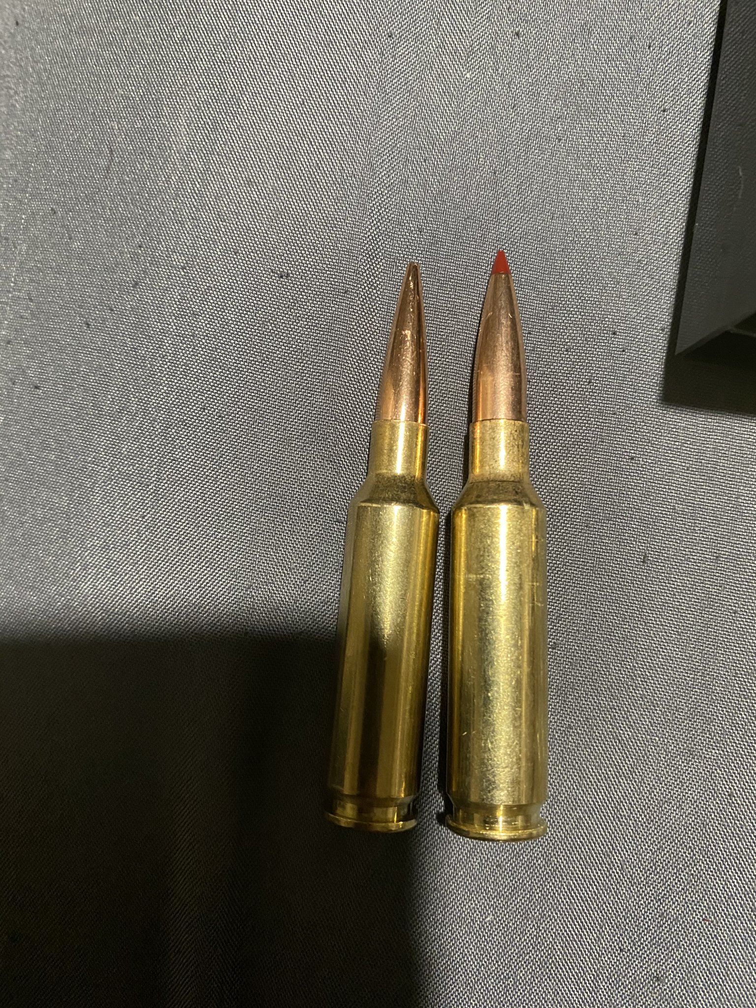

So you think is the ammo I’m using
Look where your bullet is hitting. Right on the flat portion of the breech at the chamfer edge. If your bullets were shorter, or the rounds were just loaded shorter, the case shoulder would hit the front of the extension before and lift the bullet up before the the bullet tip hit the breech face.

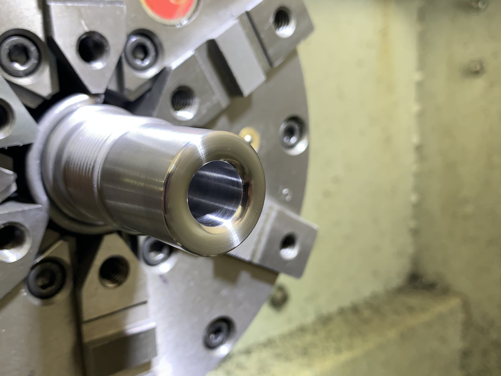

You have a pic of your barrel after they did their work? Curious because I've sorted out a few of these and they work great afterwards.

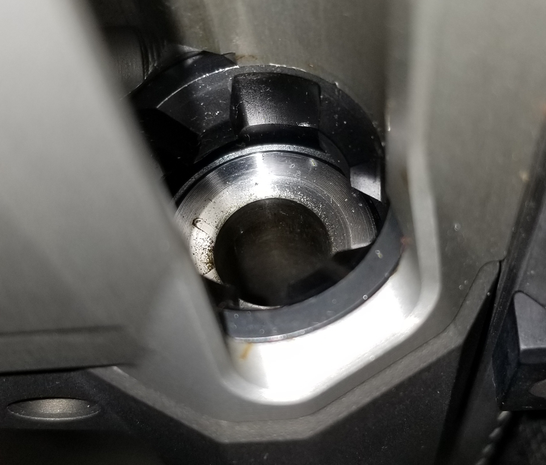

My mod
Proof prefit/Factory

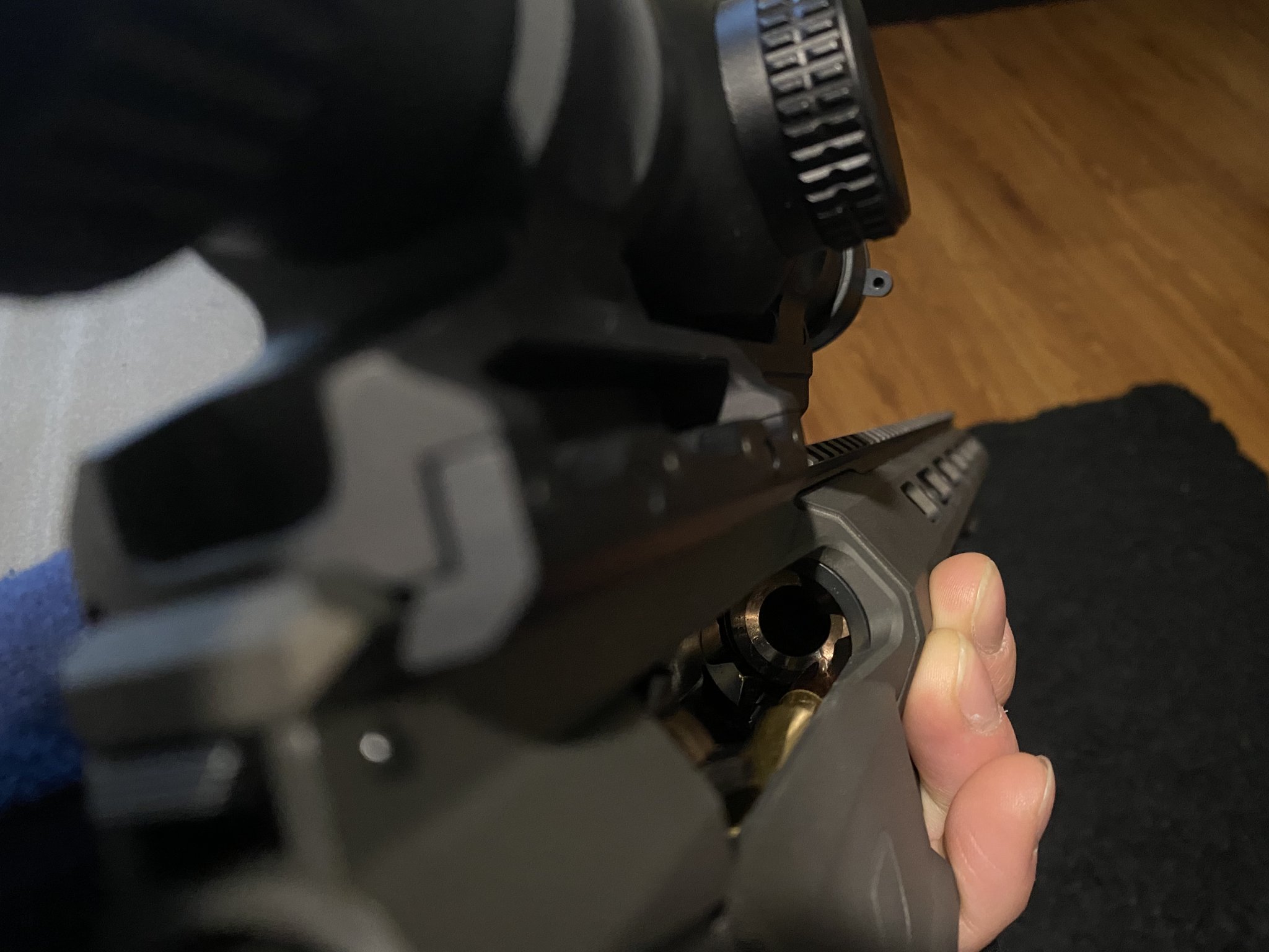

So you recommend me to send it back to Q that way they can fix that?
If you would go that route, I would ask them if they have a new barrel extension design first. If they don't, then there really isn't a point of sending it to them from my experience. I am going to ask them the same question and if they don't, I am hoping to find a smith to help remedy the situation.

Hate to hear you are having problems. If you look at that last pic you posted there is a pretty significant “splash” of metal at the five o’clock position. That may be your big problem area. Also...is the sheer amount of shaved brass in you action par for the course? Seems very excessive to me. Not going to say a thing about Q because I know nothing about them that isn’t anecdotal from forums.
