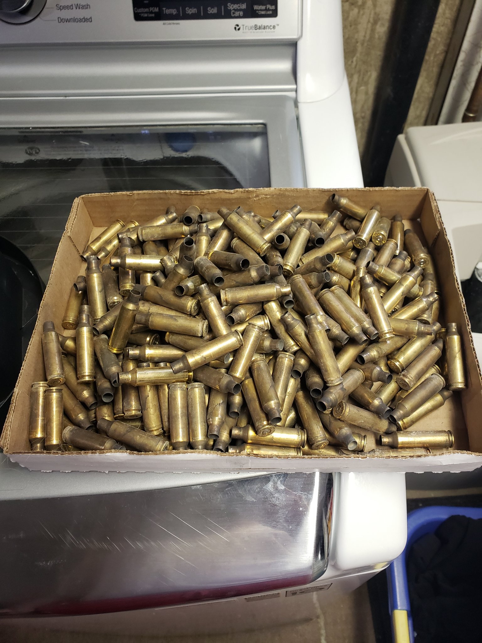

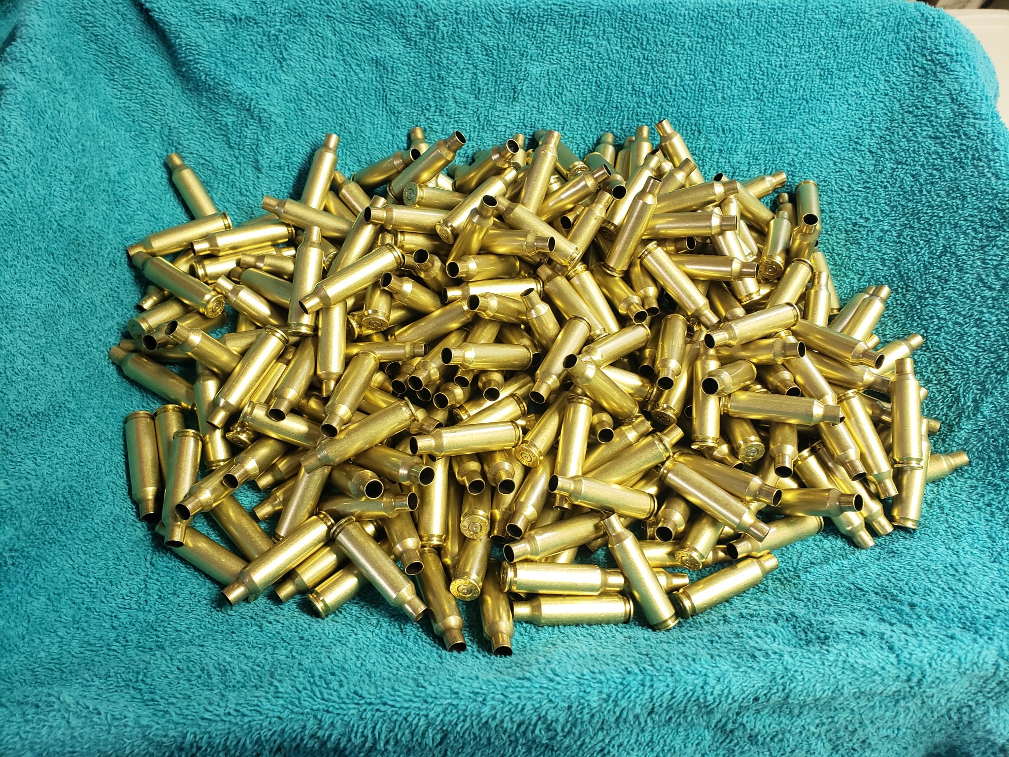

I have thrown my sized brass in my Hornady Ultrasonic for 20 minutes and then dried them in the oven at 200 degrees for 1 hour. A friend told me I am wasting time. He has 2 five gallon buckets, a gallon of acetone, and a strainer. Dumps sized brass in the bucket with the acetone for 5 minutes, maybe stirring a few times, and then dumps the brass into the strainer sitting on top of the other bucket. Then he dumps the brass out on a towel to pat dry. Says brass is completely dry inside and out in a few minutes and starts loading. This should cut over 1 hour out of this process, but I still haven't tried it.
Fired brass goes into the wet tumbler with FA case wash or Dawn and Lemi-Shine but has no media in.
30min later they come out clean and after rinsing they get tumbled and dried in a dehydrator.
I do it the night before cuz I plan ahead🤣(lies)…
Then I put cases on an old cookie sheet. Spray with One Shot. Then decap and resize, prime and mandrel on the 750.
I don’t wipe off the lube…
That’s right.
Load and go shoot. I’ve never had any issue with that in thousands upon thousands of rounds in any chamber or magazine.
Ever. 🤯
Solves that pesky problem of wiping off lube.
