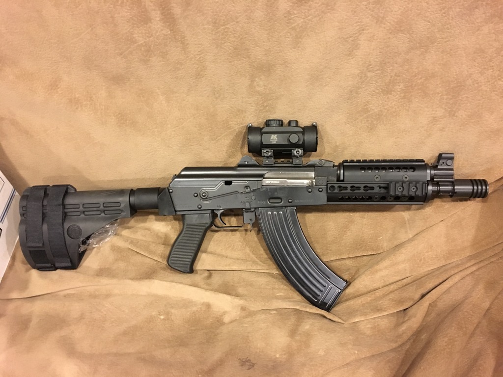

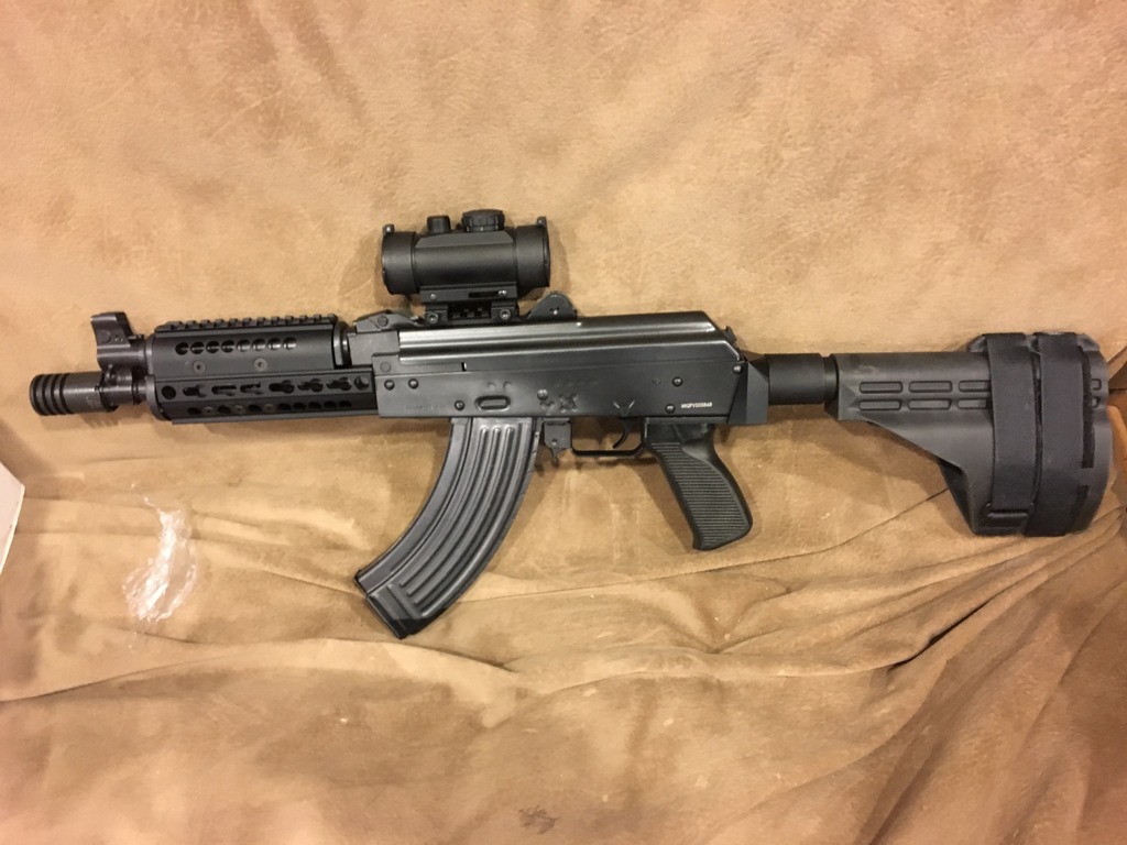

I have a 7.62x39 PWS MK1 SBR I want to run with a suppressor my friend/gunsmith/c3 dealer warned me it likely wont be reliable.
I have many suppressors in 7.62 but this one I was planning on using my YHM ti Phantom if that makes any difference.
He said they have all had problems. I bought it before I knew him he is also a C3 dealer.
I know I need to take it out and run it but is this common with this gun in 7.62x39?
If yes what are the solutions?
I love the idea of this set up since it fits under my desk at work but if I cant count on it thats no help.
Thanks PG

That looks like a Mod 1 or early model. No adjustable gas block? If it's a fixed gas block those long stroke uppers tend to be over gassed for reliability. The suppressor will enhance this so I don't think you'll have failure to fire or feed but you may beat up the gun. You can swap out buffer, different weights, if it becomes an issue.
