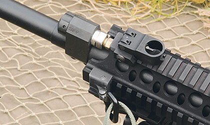

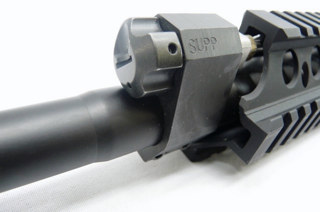

I'm not sure what I would do. The Armalite Adj. GB would be a big feature for me.
However.. the photo does not show the rather large Adj. GB used by Armalite on the "Gen I" SASS. (Era 2010'ish )
That Armalite Adj. GB is huge.
I think I would ask the seller if they still have those parts at the very least. ( If they even came on that model you bought )
I see a Gen II that uses DPMS pattern mags, and that does not have that large Adj. GB.

That gas system was really cool because they made a flange on the gas tube like a break line.
There’s a nut that slips over the gas tube from the rear, which then threads onto the male threads and spigot on the back of the gas block. Seals the gas from any chances of escaping between the block and the tube, which helps maintain consistent gas pressure suppressed and unsuppressed.
Very slick system. The gas regulator also has mechanical advantage to being able to turn it with your hand or a cartridge base if you look closely at it.
