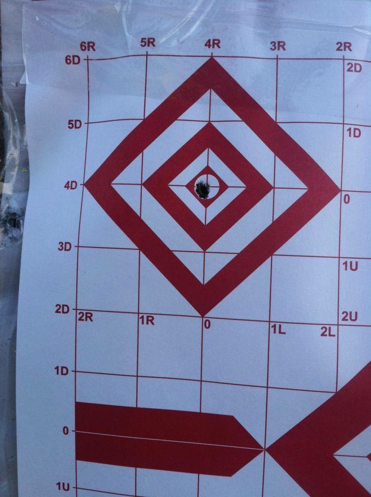

Here is my factory.223 Rem sps Tactical. Never cleaned it yet.
Why would I when it does this? 3rds.

Nice shooting Bender on that factory Remington. I was once told by a well known gunsmith that he has seen more barrels ruined by cleaning than he has seen shot out barrels. Besides cleaning rifles is a pain in the ass.
