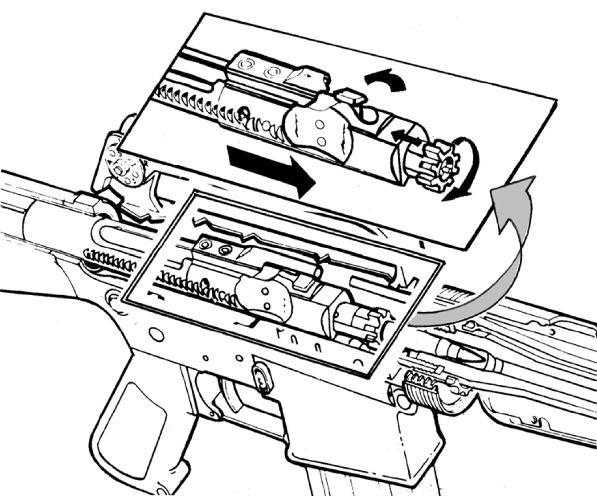

Wrong. the BOLT absolutely rotates and locks into the barrel extension. It's not just a spring holding everything in place. The bolt CARRIER has to start moving rearward either from gas from the gas system or manually using the charging handle before the cam pin in the bolt carrier rotates the bolt to unlock it.
Reactions: Rocketvapor
it locks rotational position, but you can still pull it rearward without unlocking anything as the bolt rotates on it's own.
in a bolt or lever gun, you have to unlock them with manual action.

The AR bolt is locked if it is fully in battery............no gas = no unlock. All actual recoil happens with bolt locked. Secondary impulses are BCG reciprocating movement. When you pull it rearward you are manually rotating the bolt to unlock via the cam pin, sim. to a straight pull bolt gun.
The amount of brass play is same as bolt gun & completely dependent on head space. if it's .005 then typically the brass will be .005 off the bolt face when chambered. This is due to the stiff ass ejector spring shoving the brass to the head space datum point (same as a bolt gun with spring ejector). Yes the brass locks to the chamber when fired just like a bolt gun & it will/can extrude the base back to the bolt face. = Don't bump shoulders back further then necessary for reliable feeding for your application.
The above is why checking and having proper head space matters in an accurate gasser. Also why checking and obtaining proper firing pin protrusion matters.

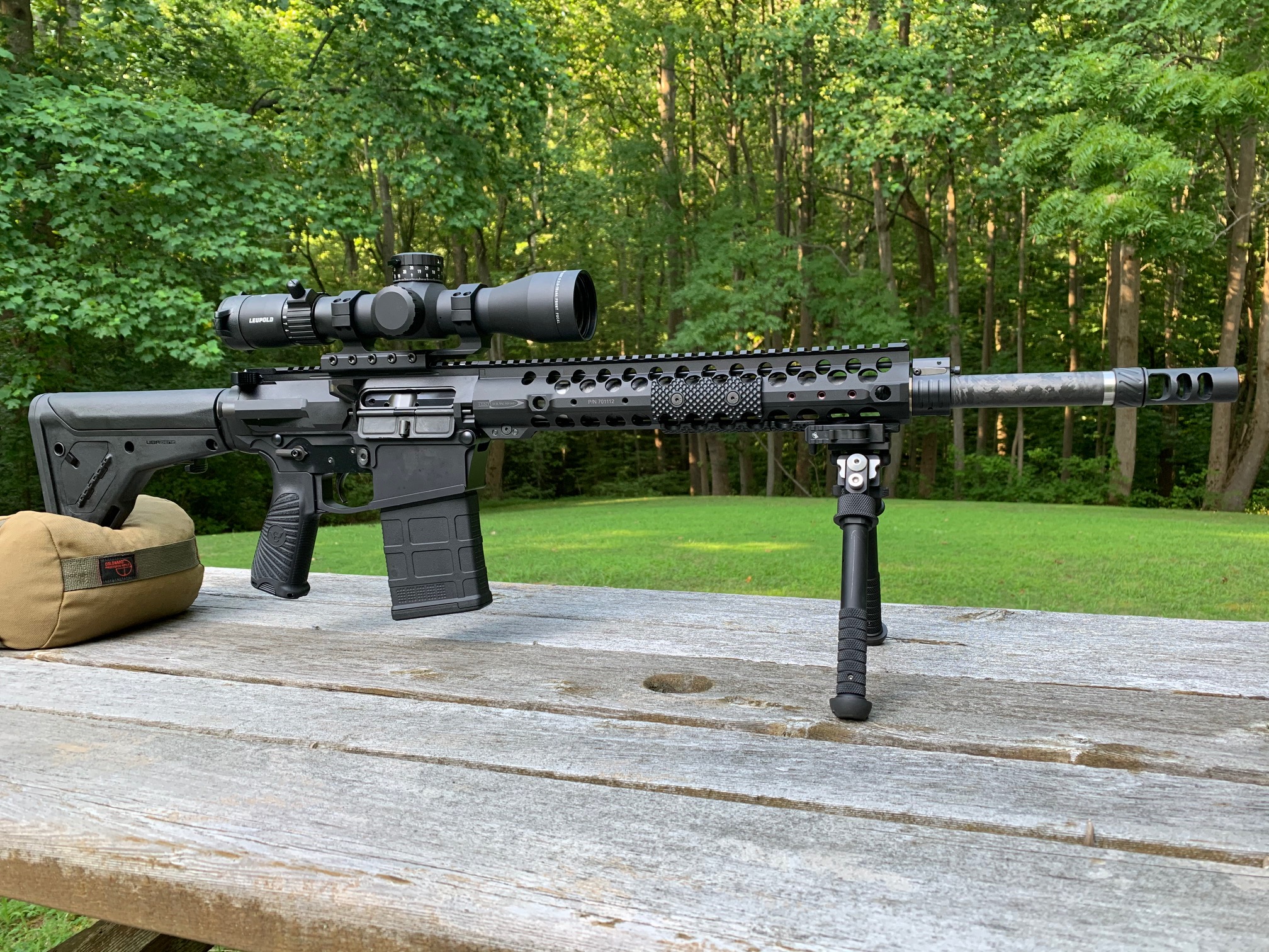

It's really incredible just how well a gasser can shoot. My home built 80% DPMS 308 is a hammer with factory FGMM or Nosler 168 or 175. No load development.......no BS, well under 1 moa with good factory ammo.
When you take a step back and compare to a bolt gun. it really is incredible the performance these gasser's are delivering, assuming you can shoot one well.
Gasser = 8-12lbs & often not well balanced depending lrg or sml frame vs. Precision bolt gun typically 12 - 22lbs balanced in front of mag
Gasser barrel length 18-22" vs. Precision bolt gun 24-28"
Gasser stock ergo's, such as check weld etc are a compromise vs. most precision bolt guns.
Gasser recoil impulses are multiple vs. 1 for bolt gun.
Gasser trigger pull is typically heavier (My DPMS with Geissele SSA-E is 3.5lbs) vs bolt gun 6oz - 1.5lbs
Here is a direct field comparison @ 547 yards, where all the above differences are at play.
I shoot ever so slightly better with the bolt gun that has a better bipod, it's heavier, less recoil from 6.5C 130, better brake, longer barrel, 1.5lb trigger, & cheek riser.
I could see trace with the bolt gun, but not the DPMS. I do think it's possible, but I'm just not there yet. Maybe after Franks class in PA next year.
18" DPMS 308 set up.
Previously this DPMS shot no better then 2.5 MOA with a Bergara 18" mid gas barrel.
The only time 1 tried single feeding was with the Bergara barrel trying to sort accuracy & reliability issues.
Now that both accuracy & reliability is 100% there is simply no chance in hell I would even consider turning the gas off!!
Only small changes will be made going forward such as a precision armament 4 port brake.
I can now just focus on improving my driving skills.

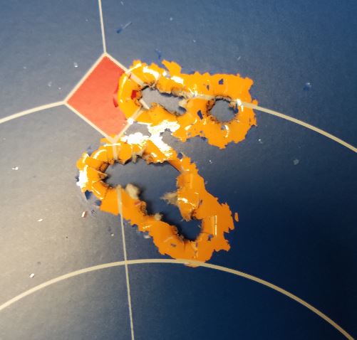

First 10 rounds out of new proof 18" rifle gas 1/11.25T 308 barrel & new MK 5 scope. Break in was Hoppe's #9 clean before going to range.

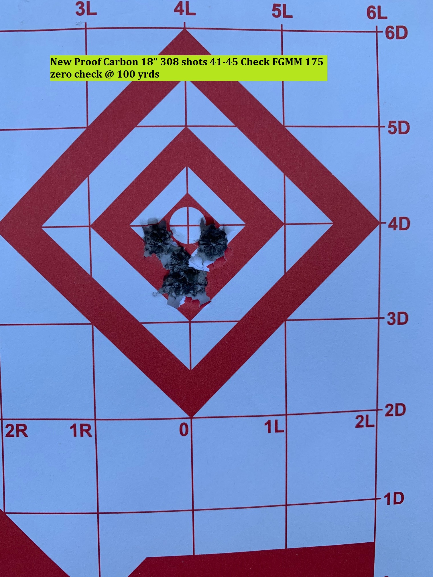

rounds 41-45 zero check with FGMM 175

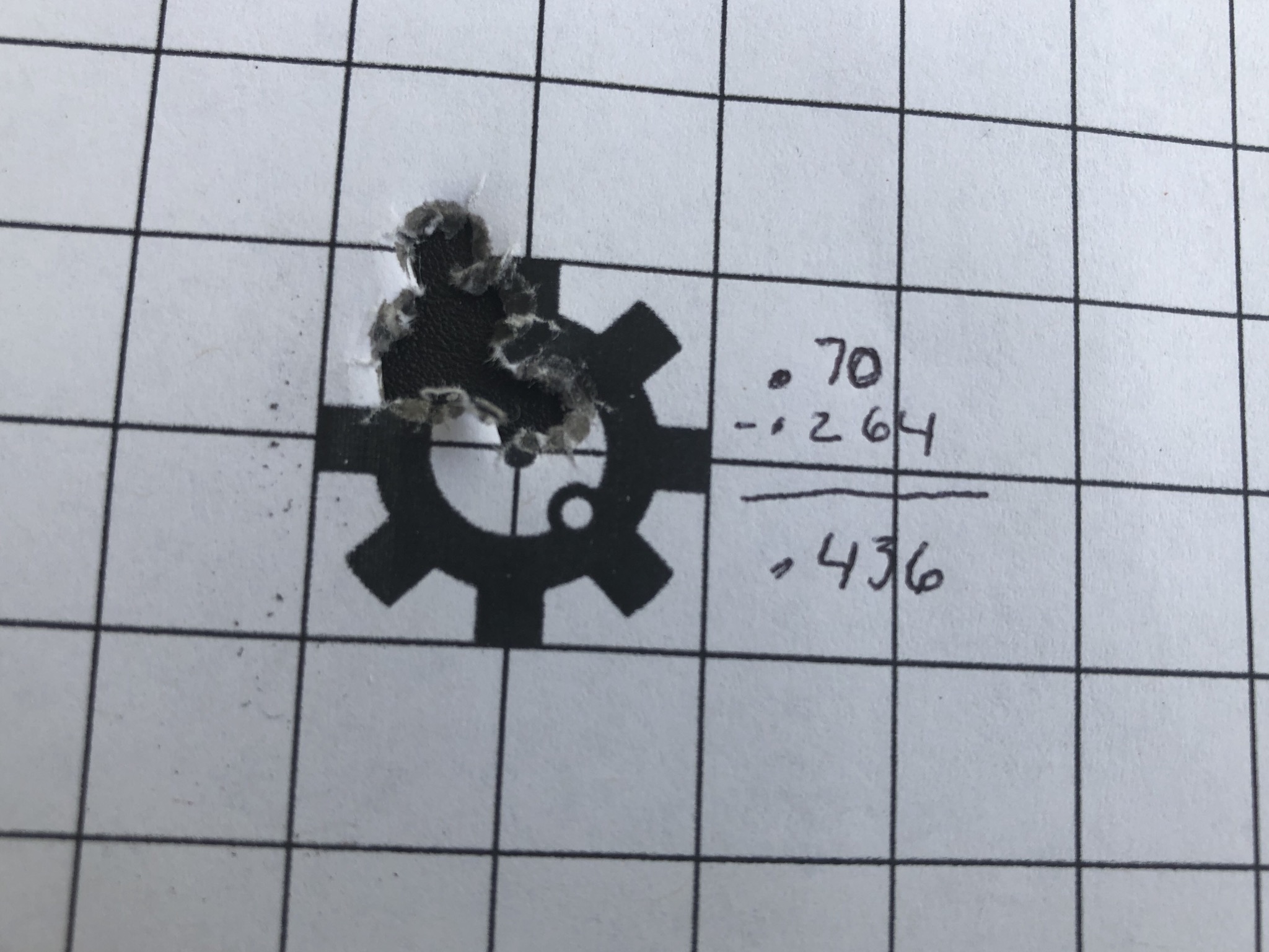

Having finally gotten the DPMS sorted I entered and shot my first ever match recently. The Geissele Gas Gun Challenge in PA.
Heavy tac. div.
They say confidence in your rifle is very important when competing & after finally doing it I completely agree. I knew my gun was capable of any precision required & would run 100%.
I did very well on the precision shots & finished mid field of 50. The match was a blast & there were a lot of very good shooters.
