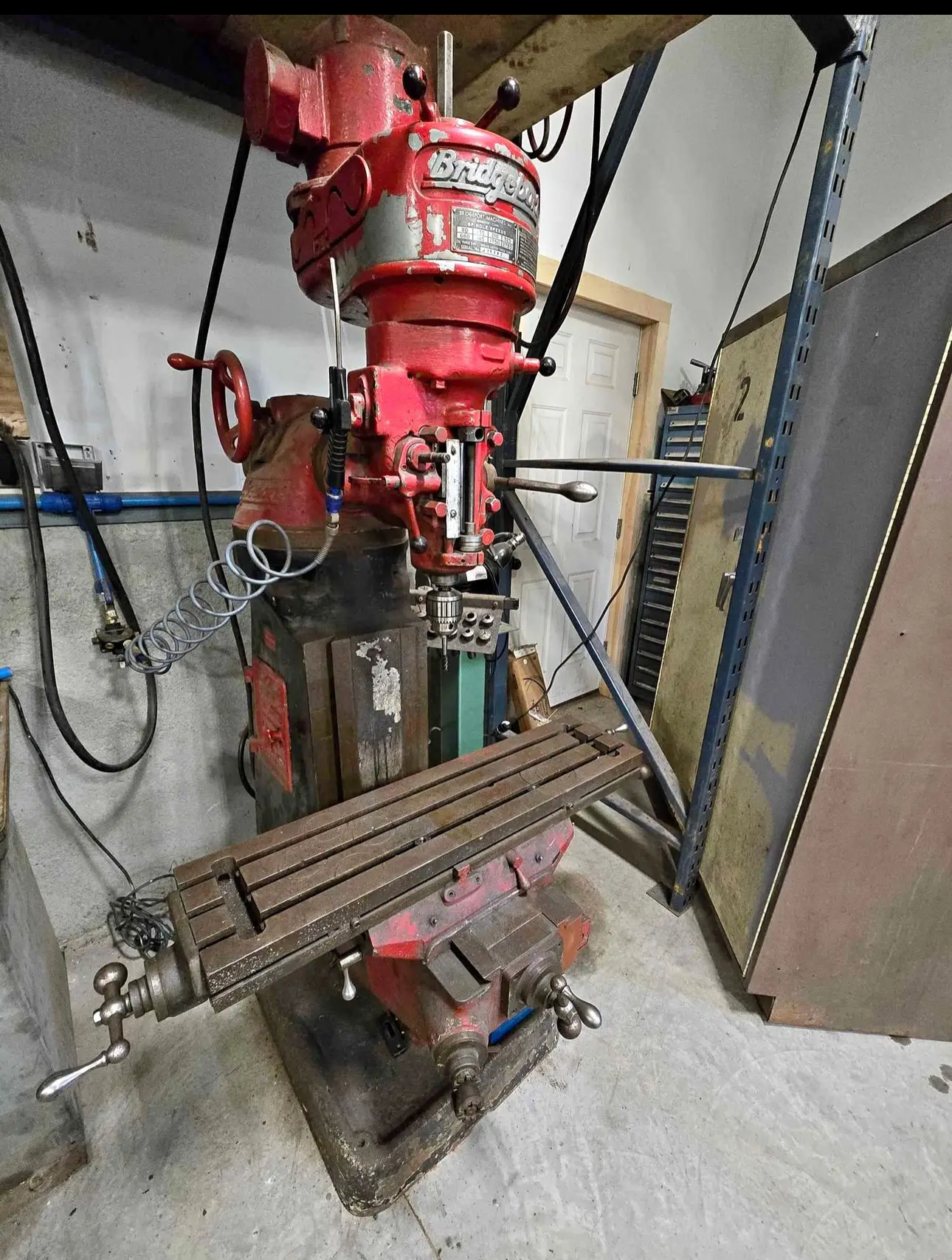

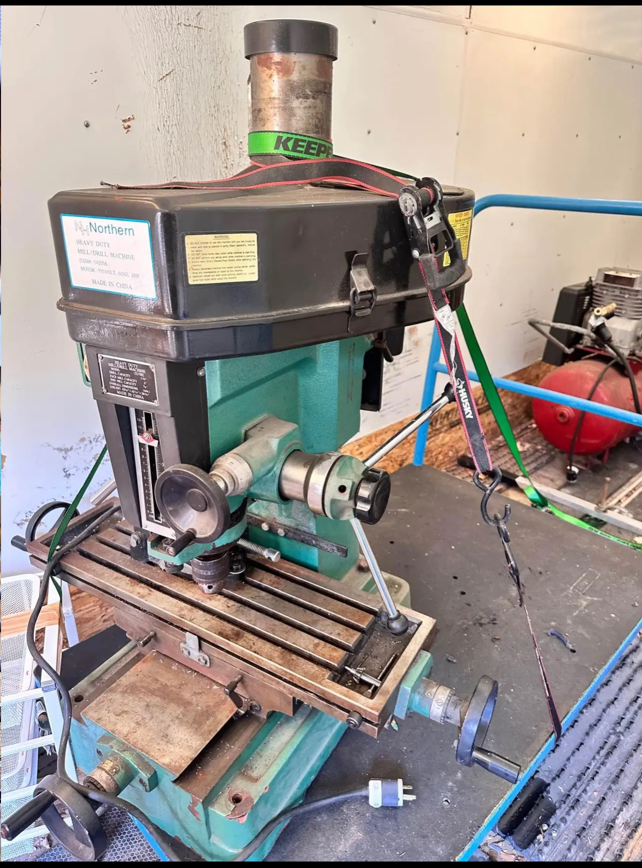

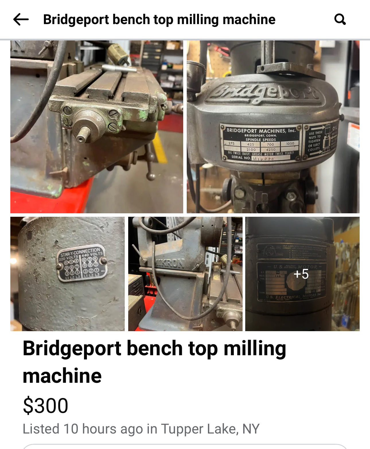

Just a quick search of FB marketplace in my area…
$1050 asking
$350 asking
$300 asking
Just some thoughts to expand your search.
There are also some 3:1 lathe, mill, drill machines by companies like Jet. They are not perfect at any of the functions. And not commercially viable, but for homeowners and hobby folks are amazing. Often very low use. And cheap. The machine is the cheap part… the tooling adds up.
Again… don’t limit your thinking to a drill press. Think “what can I do with my bench or floor or garage space.”
Cheers!
Sirhr
Reactions: Makinchips208

The vast majority of hobbyists would be better served allocating that floor space to a knee mill.

WTF. I wish something like the top one would pop up within 100 miles of me. Ive been looking for a reasonable "smaller" Bridgeport for awhile now.

I had at one time, one of the Bridgeport benchtop models. It worked ok for light machining. I found by the time you put in a drill chuck and twist bit, you used up all the z axis and it wasn't good for anything other than sheet metal. But it was in fact very rigid compared to a drill press
