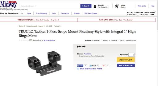

Has anyone used this TRUGLO 1" scope mount and if so do you like it? I want to change mine because it is 1.375" to center of scope tube from the top of the rail. The Truglo is supposed to be 1.5" to center of scope tube which is exactly what I want plus the zoom ring on my scope binds to the split mounts and this one doesn't extend under the eye piece.

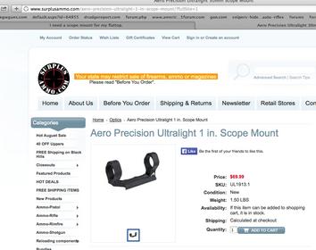

Pink, now I follow you brotha. I thought you meant that your zoom ring was binding at the top because your rear mounting ring is so far back. Now that I understand that the zoom ring is binding at the bottom of the mount, I can see were your issue is. Even though the CL is 1.5"ish, those PSeries look to have a bunch more material on that part of the mount. I think the Truglo would work, but couldn't vouch for quality etc. I'd definitely recommend the AeroPrecision ultralight mounts. They are 1.5" CL and are extremely well made. Come in a 2.98 ounces. I think they're around $80. Would be a huge upgrade over the P-Series my man!

This one looks really good. Hope I can find someone that has one in stock.
gt40
Buy it directly from AP. I have one of their extended mounts. I bought it to save weight but the machine work and finish are first class.

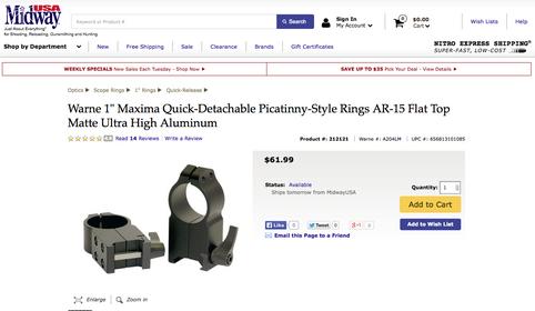

I looked on their web site and they were out of stock. I saw a guy that had these and I'll send for them tomorrow. I can position them any place I want. I take very good care of my toys and if I don't trip and fall I should be good for a long time.
Warne 1 Maxima Quick-Detachable Picatinny-Style Rings AR-15 Flat Top
