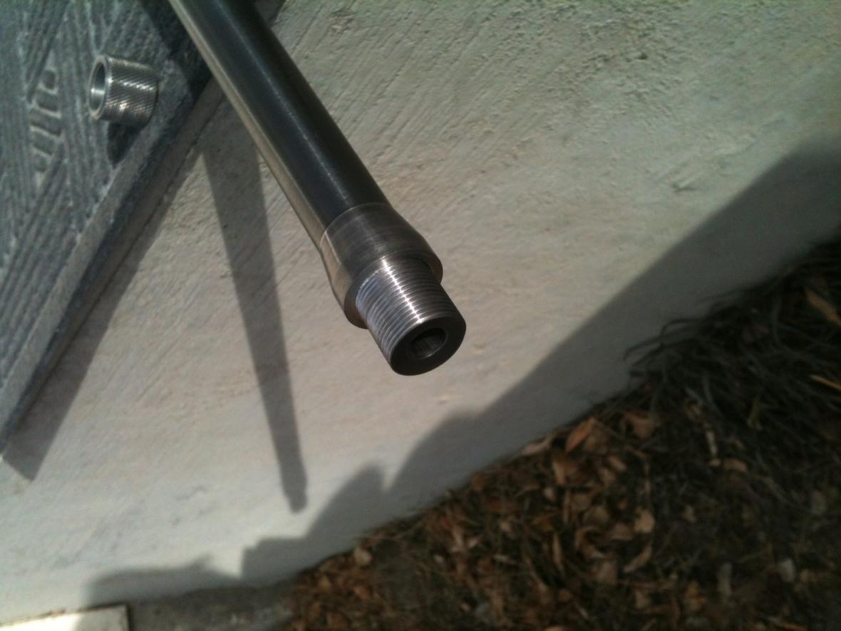

bush your barrel, don't replace it!
Just bush the barrel, like in the attached pic.
Your smith needs to be indicating the bore, rather than turning between centers. The bore center and profile center of a barrel are often quite far off, in machinist dimensions.

I'm sure a lot of good smiths turn down work like this because it is "sub standard" meaning that yes 1/2-28 threads can be put on the barrel but, lack of meat around the bore, lack of a shoulder, making up adapters/spacers are not things that give you a warm and fuzzy, esp when there all together. Even tho they may all work fine, in the off chance that something was to happen it would more than likely come back on the smith.

A good gunsmith will dial in the barrel from the bore to thread, crown and add a shoulder like the one in the picture, but a
gunsmith with love for the art will make that shoulder to barrel joint invisible for the eye to see.
