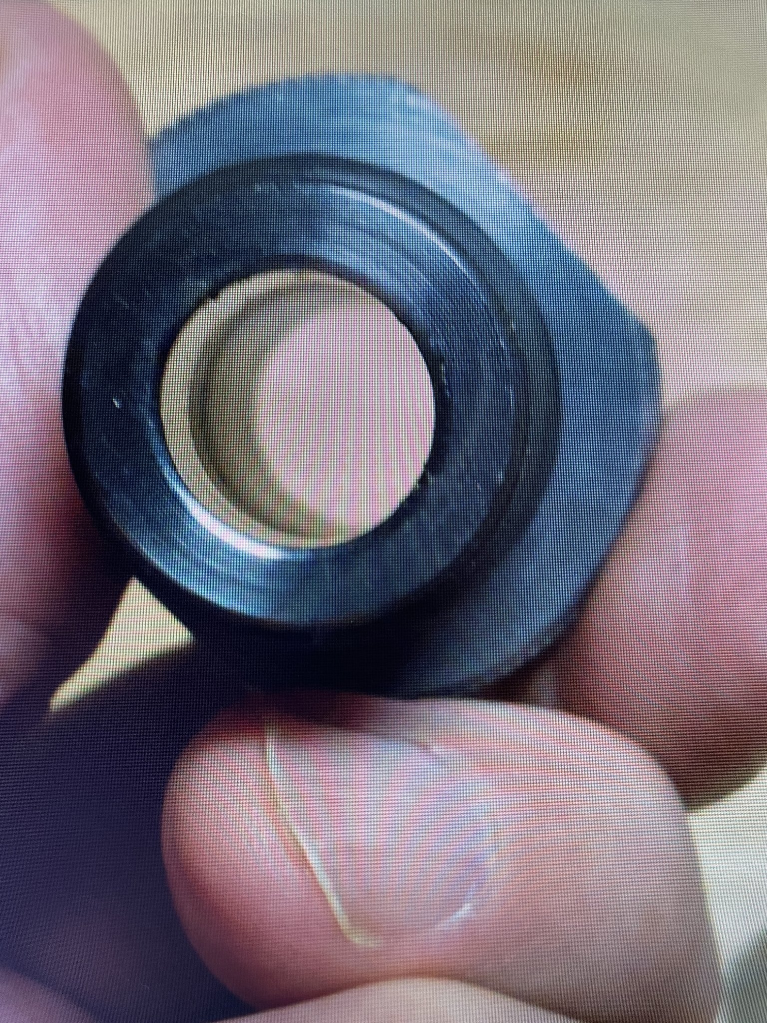

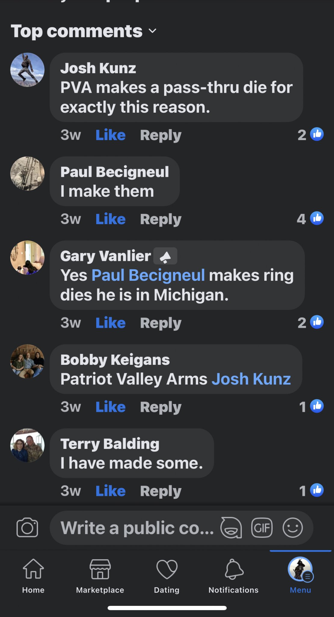

Small base dies size the entire case back to factory and really works the brass hard to get the base down to size. Get a ring die to just size the base only.
Check out pbike on accurate shooter forum for a ring die or Paul on the FB posts.
