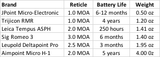

    What were some of the red dots that you found were lighter than the H-1? Over the last several months, I've been putting together a detailed comparison guide for battery powered equitment (optics, lights, range finders, gps, etc). From my research, most red dot sights weigh in between 5 and 8 ounces, with the H-1 being only 3 ounces.
    To be fair, I classify optics such as the Trijicon RMR, Leopold Deltapoint, and other handgun-mountable optics as "Micro Red Dot Sights", and optics such as the Aimpoint H-1 or Trijicon MRO as simply "Red Dot Sights". Since the optics are made for different purposes, with unique advantages and disadvantages, I find this distinction to be important when selecting the right optic for one's mission requirements.
    Reactions: Near miss
    Here are some weights:
    7079726
    I put my RMR on my Ruger 10-22 and my Leica Tempus is mounted on my VZ-58. So I guess I use "mirco" red dots for rifles. I never really made a distinction between red dots but you have a point.
