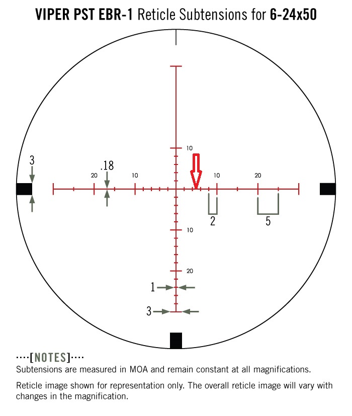

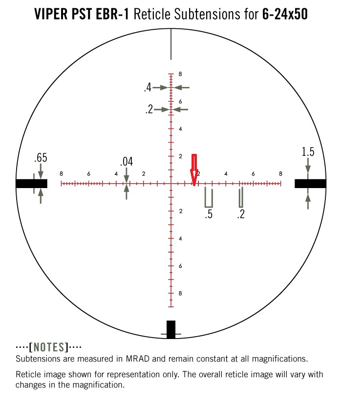

One thing that's been bugging me about using MOA reticles and MOA turrets......
As I watch this debate play out, one thing that's been nagging me about the MOA/MOA scopes that doesn't seem right but is intuitive for me on MIL/MIL scopes is how do you convert what you see in the reticle into the actual turret adjustments? I will assume all tactical MOA/MOA scopes have 1/4 click knobs. But when you look through the reticle, most MOA scales are in 2 MOA increments. So when a bullet hole ends up somewhere in between those hash marks, what do you MOA shooters think in terms of - decimals or fractions?
For instance (using the PST reticle as an example), the first pic is of a MIL reticle. If the bullet hole lands where the red arrow is, then I would call this 1.7 mils and dial and additional 1.7 mils left (17 clicks).
But then in the MOA reticle, what would you MOA shooters call that? 4.4 MOA or 4 1/4, 4 1/2? And if 4 1/4 - that again is 17 clicks. If you DO think of it as 4.4 MOA - how many 1/4 clicks is that? Wow, that is not intuitive to me at all. Nor is it easy decimal math.

I don't see the problem at all. Both MOA and mrad are angular measurements. You are changing the angle to bring POI to POA.
You change the angular measurement. 17 0.1 clicks per the reticle will bring POI to POA. Right?
The second example with a MOA reticle, you measured at 4.4 MOA, OK, you have a choice of 4.25 (17 clicks) or 4.5 (18 clicks). You pays your money and makes your choice.
Interpolation is probably a little easier to grasp with decimal gradations but it shouldn't be that hard. 4.4 is closer to 4.5 than it is 4.25 so I would pick 4.5. Your group dispersion, unless you normally shoot under .2 MOA groups will take care of the rest.
Who cares how many clicks 4.4 MOA is?
First of all, MOA target turrets are numbered every MOA (1, 2, 3, 4) and have either 4 or eight marked lines between MOA numerals.
Second, all MOA scopes are either .25 or .125 MOA per click.
So if you REALLY have to dope 4.4 MOA, and you have a .25 MOA scope (the most common), you have to round to the nearest .25 MOA. Now you realize that 4.4 MOA has to be doped as 4.5 MOA and to do so run the knob to the 4 MOA line plus 2 clicks.
Done.
If you don't have tick marks on your reticle, you must do math to sight in your rifle, for example.
Yes. So?
Math is simple
1 MOA = 1.047 inches
1 miliradian = 3.6 inches
Sight in your duplex reticle using the math and then forget about the math. With a simple duplex you won't be doing too many holdover or windage holds out in the field since have virtually no reference marks on your scope.
