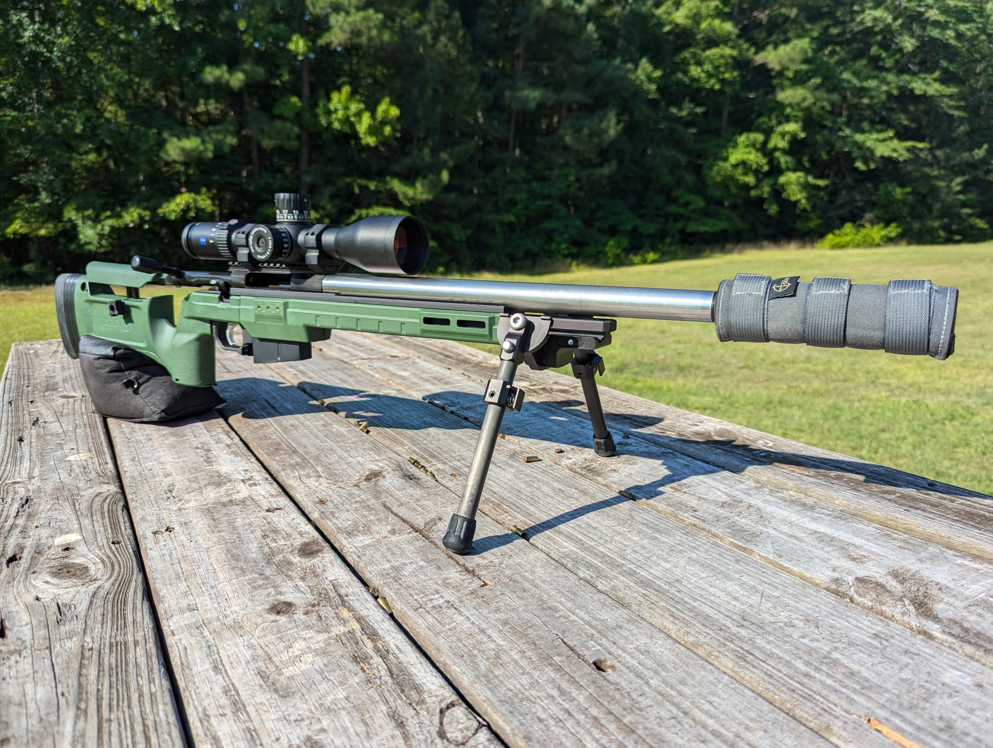

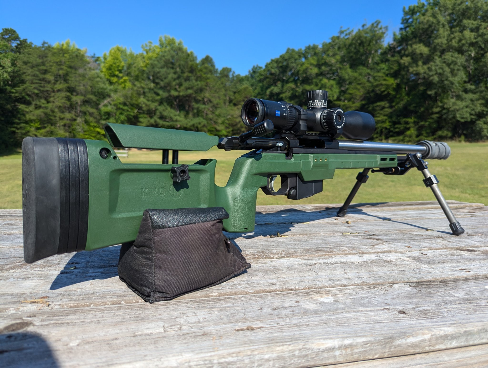

I get roughly 9.125" from the front edge of my Solus action to the tip of my Bravo chassis. Running an 18" barrel and a spigot on mine, still get about 3.5" of barrel past the spigot out front.

Bravo will be fine. I think they're one of the shortest forends because they really expect you to put a spigot on the end (which all mine ended up with).
