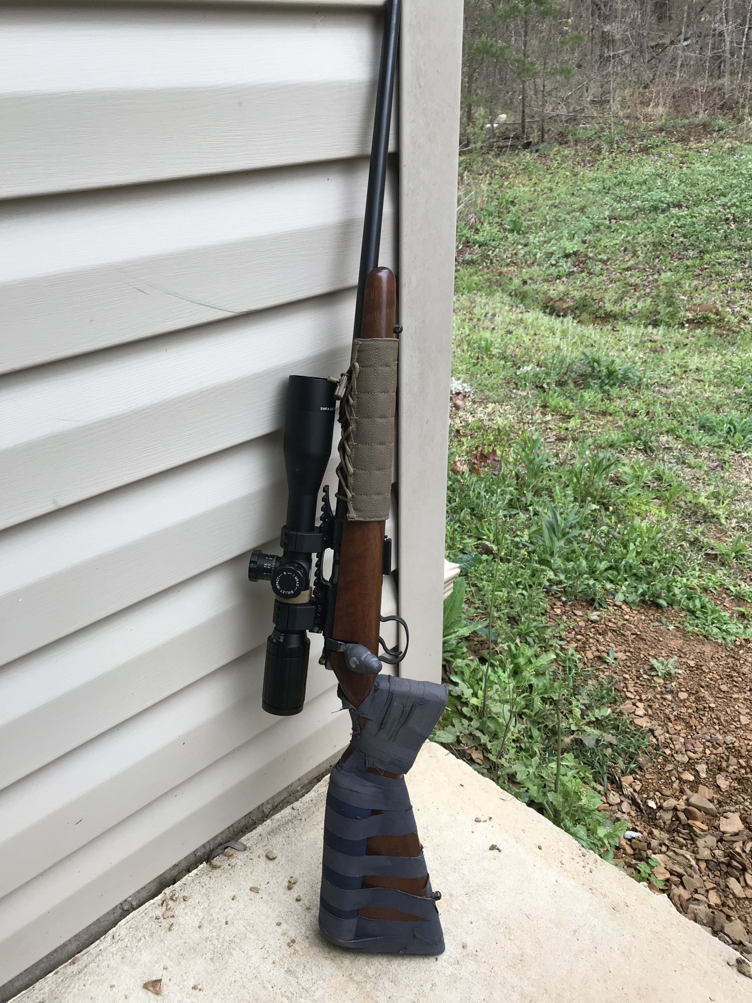

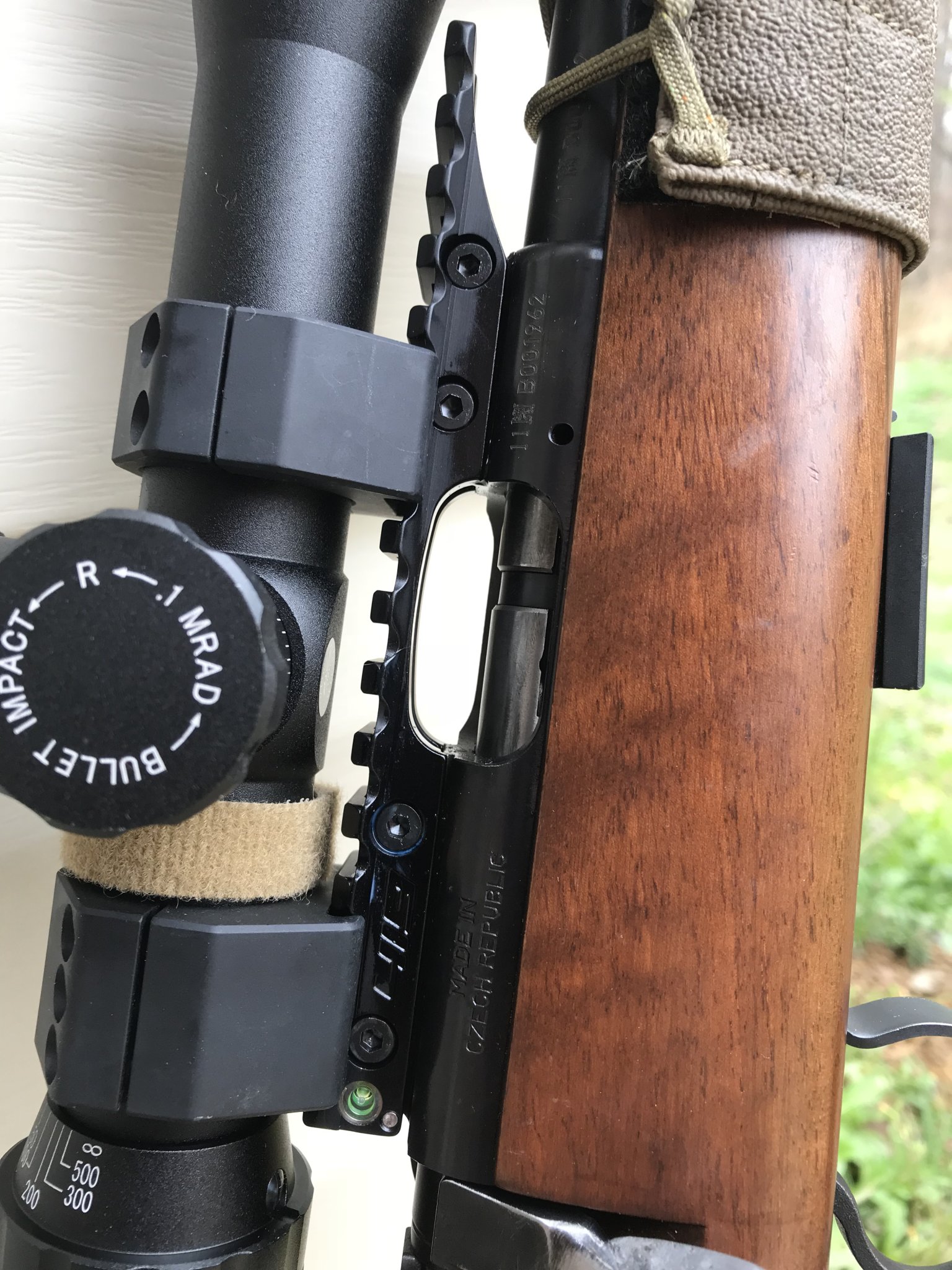

Got the rail and an SS 10x42 scope in today. Rail inspires much more confidence than the DIP rail. Very tight fit to the reciever. Had to spray a bit of WD40 and tap it on with a rubber mallet. Put blue locktite on the four screws and hand tightened them down (didn’t have an appropriate size hex bit). Will shoot it and do my sight it the Sunday after Easter, have zero issues thus far.
And yes... I did screw and tape a piece of wood to my sporter stock to try and get a vertical grip. Believe it or not it works extremely good and hasn’t budged. It’ll have to do until I can get a good aftermarket stock (KRG XRay most likely unless they offer a CZ 455 Bravo inlet). And yes, a bad JB weld bolt handle, that works great! Still need an Atlas bipod though... one day.
And yes... I did screw and tape a piece of wood to my sporter stock to try and get a vertical grip. Believe it or not it works extremely good and hasn’t budged. It’ll have to do until I can get a good aftermarket stock (KRG XRay most likely unless they offer a CZ 455 Bravo inlet). And yes, a bad JB weld bolt handle, that works great! Still need an Atlas bipod though... one day. View attachment 6888924View attachment 6888925
What's funny is that I didn't even notice it was tape. I thought it was one of those cheek risers people use. I would have to do something similar. I've been so damn spoiled by vertical grips that the other day I was crying about my wrist hurting when shooting my hunter 700 stock. I think the non-vertical is great for hunting, but for me, prone or bench, it is uncomfortable as hell.

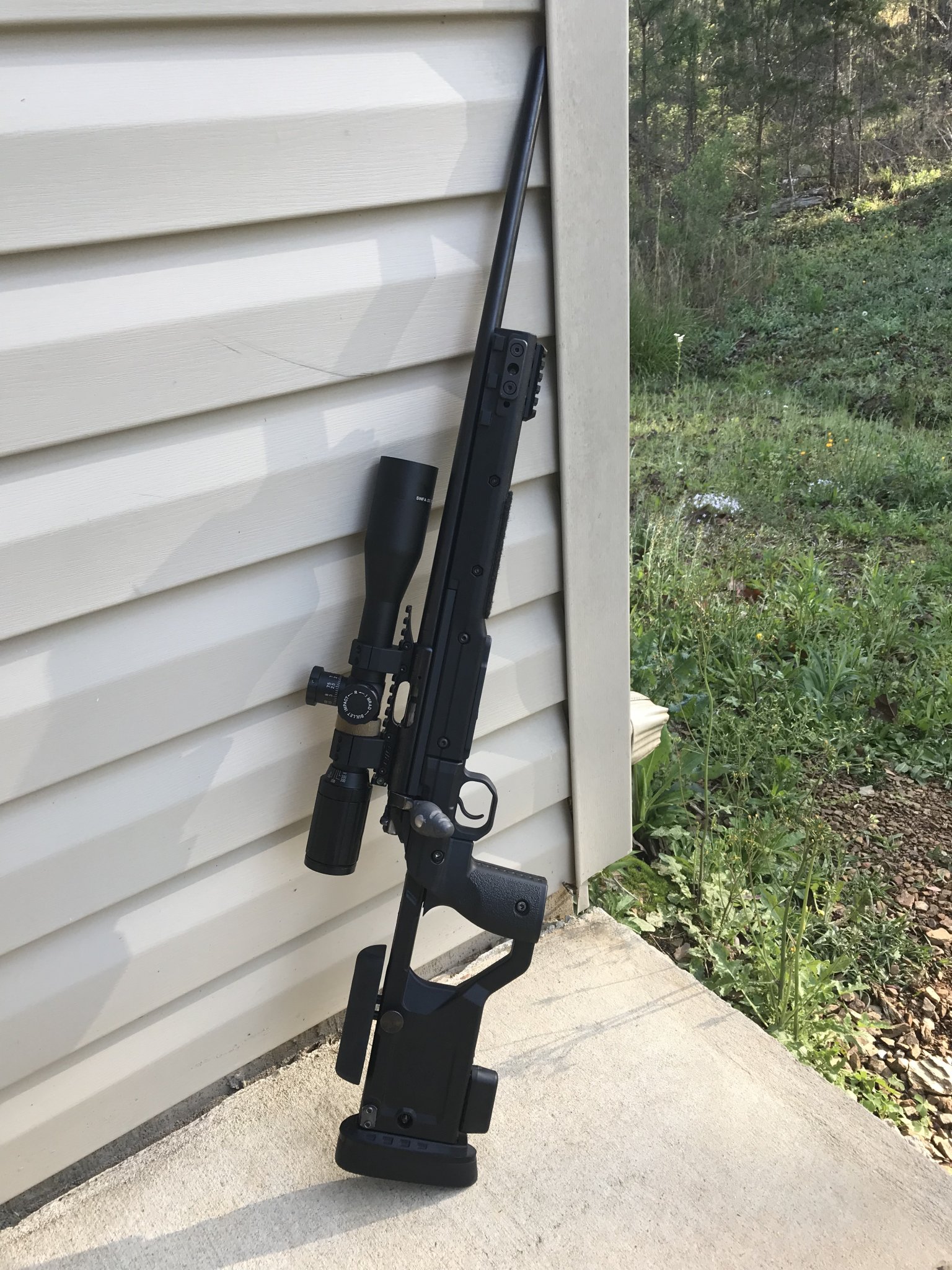

Last pic just as an update. Hopefully it still shoots as good as it did in the factory stock. Forend is flexible, but does not make contact with the sporter contour barrel. Need to eventually get an aluminum rail and buy an Atlas, sometime. For now I’ll just be happy shooting off a bag, barricades, obstacles, and a sling
Last pic just as an update. Hopefully it still shoots as good as it did in the factory stock. Forend is flexible, but does not make contact with the sporter contour barrel. Need to eventually get an aluminum rail and buy an Atlas, sometime. For now I’ll just be happy shooting off a bag, barricades, obstacles, and a sling View attachment 6890927
Yep, that looks pretty damn sweet.

So the 419 has a recoil lug. The DIP does not. Does the EGW or Murphy have one?
Other than the recoil lug, I don't really see how the other rails do anything different than the DIP. Is it that their screws are bigger? I have a DIP on one CZ, and was about to buy another one for my kid's scout. Never had an issue with my sample of one, but if something really better exists...
I wish 419 had made the rail less expensive and simply didn't add the bubble. Seems useless to me on many levels, (bad) pun intended. Probably wouldn't save much money, but since it appears useless anyway, might as well save a few bucks.

Same principle sure, there is definitely more heft with the Area 419 rail and seems to be of a higher quality. The bubble is kinda useless as I can barely see it under the scope. I employ the bubble as a training aid as I am still relatively new to precision rifles.
I get the higher quality (always a good thing), but does the heft help it in some way? I'm trying to figure out if buying a rail that costs 2.5X my current one will work any better at all. I always thought the set screw approach to rail mounting was a poor idea. Mine just happens to work well enough so far. I have a NF 5-25 ATACR that is going on it shortly, and it currently has an F1 on it. Not lightweight scopes, probably like most of you.

The Area 419 and DIP rails do not work in the same manner. The DIP uses set screws that run downward through the rail and apply tension to the receiver to hold the rail on. The Area 419 (and the EGW) use screws to pinch itself onto the rail similar to how scope rings are mounted.
That's very helpful, thanks very much! Looks like I'm going to try a 419 rail then...
