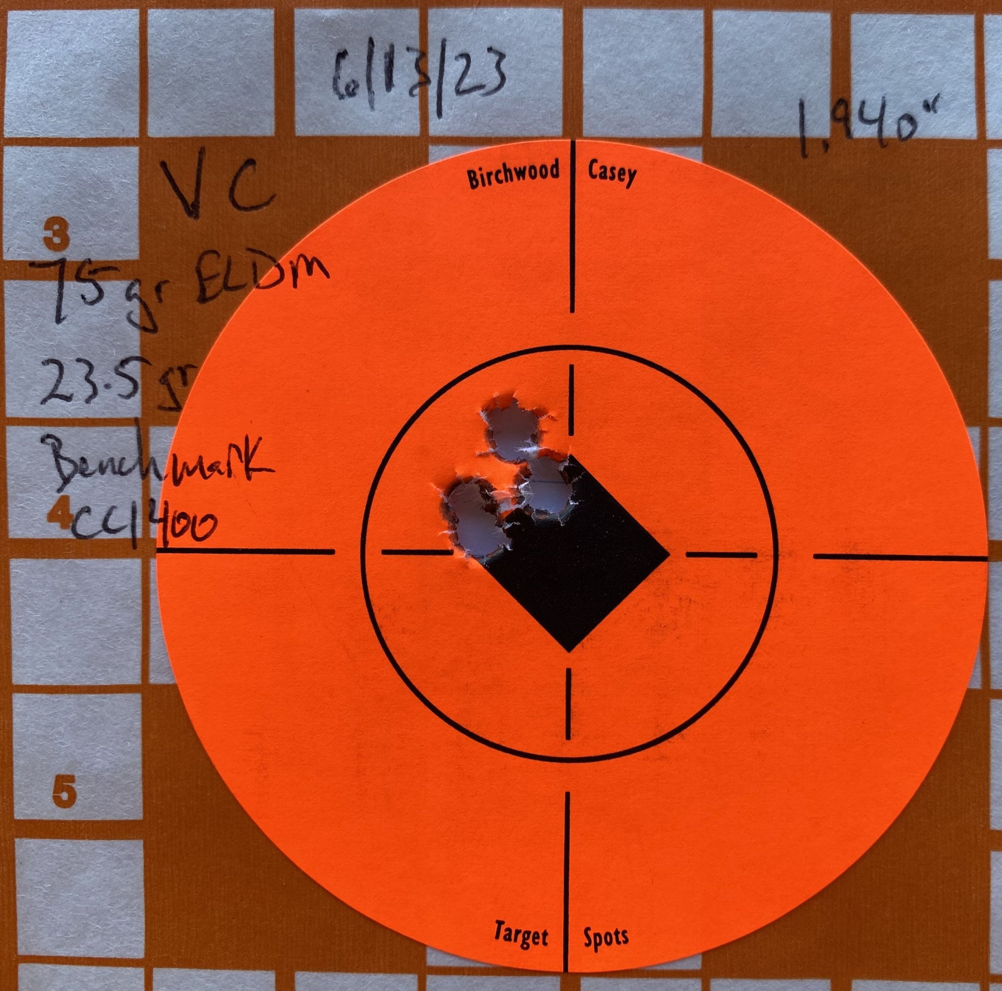

After trying to kill myself with 75 gr ELDM and TAC I had to go back to the drawing board. The Varget load that shot so well in other 1-8” Tikkas just didn’t do it for Varmint Kong. I have a big jug of Benchmark so I thought I’d give it a go.
I primed a bunch of twice-fired neck sized R-P cases and primed with CCI400 primers. I chronoed the max book load of 23.5 gr Benchmark at 75 F and got close to what the book said, high 2800 fps range, ES of 18. Brass looked good.

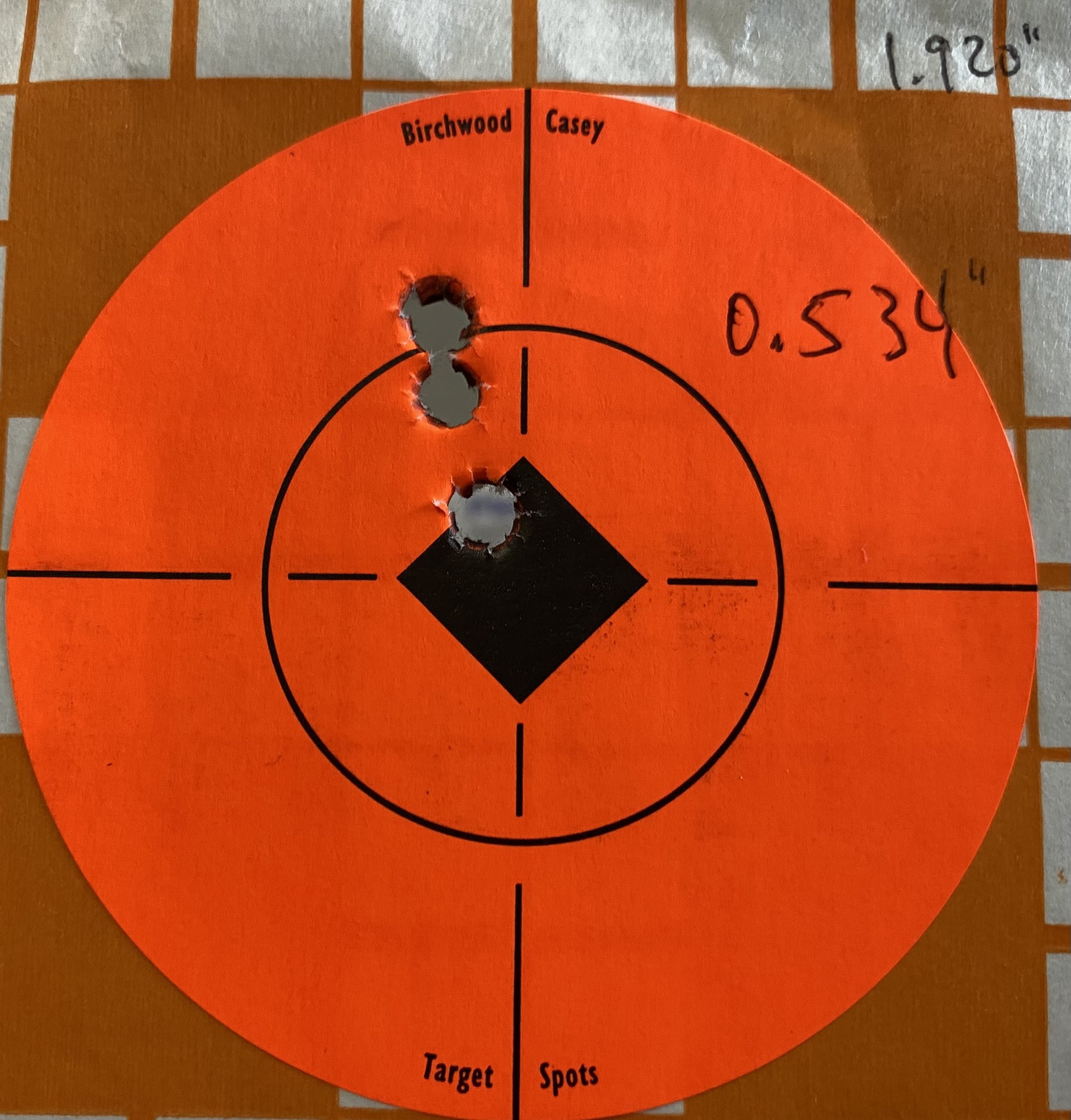

I loaded 4 rounds each starting at just barely off the lands, then shorter by 0.02”, for 6 seating depths, starting at 1.940”. I wanted to try more but the shoulder of the bullet went below the case mouth at 1.823”, so 1.840” was my stopping point.
I hit the range today and started with the shortest loads. If I found precision early I could shorten the longer loads, the opposite not so much.
The longer the cartridges got the better the precision. I was really happy with the next-to-last depth.
until I tried the longest cartridges.
I need to roll a few more to chrono and confirm but I’m pretty pleased.

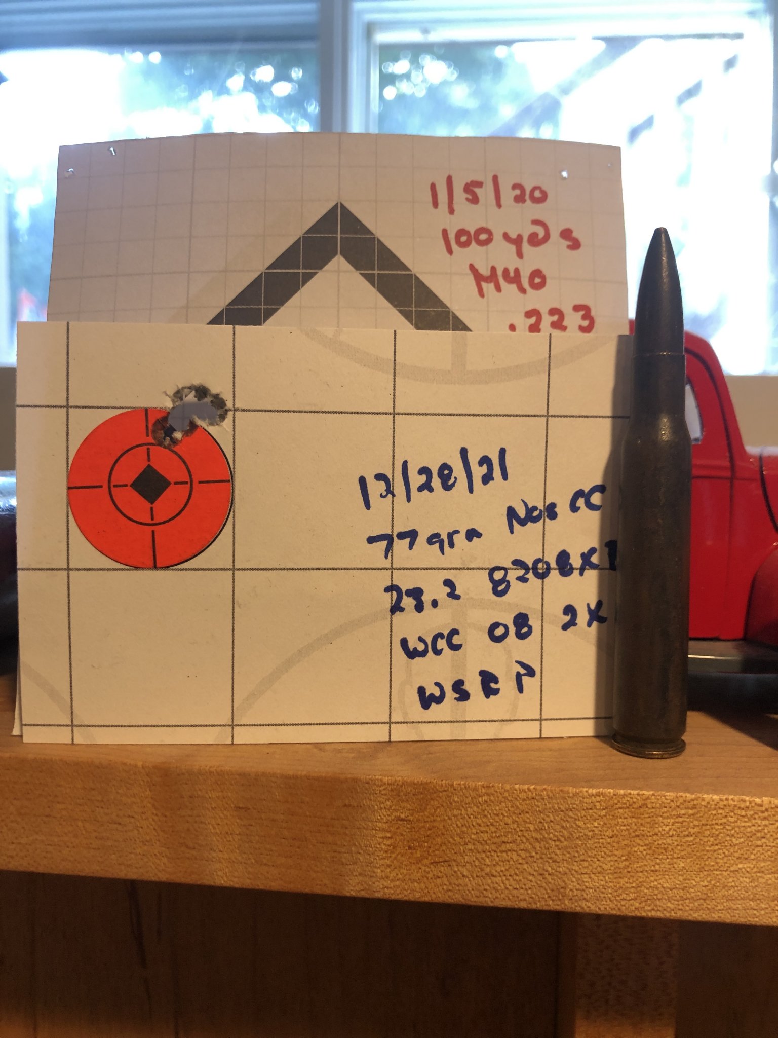

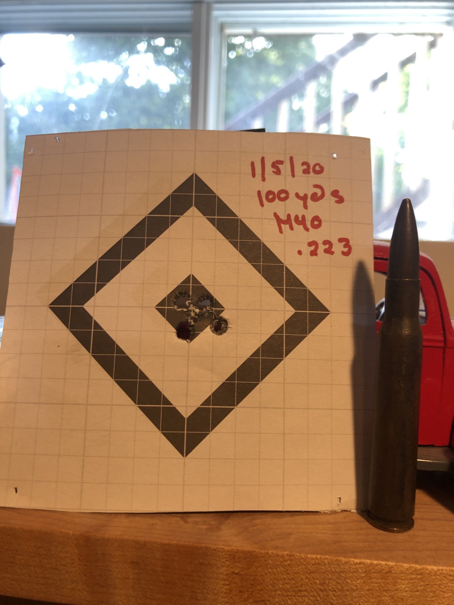

I've had good luck loading long with 223. Of course using a standard length magazine (AR's) only allows what it allows. Bought a PRI 10 rounder and modified the front. Fun to experiment with and I have some good loads that are as long as the mag well will allow. This a heavy bullet only thing though.
I use the slower powders and have never played with Benchmark. Your load looks good!
Pickup some 8208XBR
8208 is vaporware these days, as some have noted. A guy posted 18lbs of it in the PX a few days back but he was in GA. It took everything I had not to jump in the car for a 20hr road trip and a month on the couch to pick it all up! Benchmark isn’t much better…
