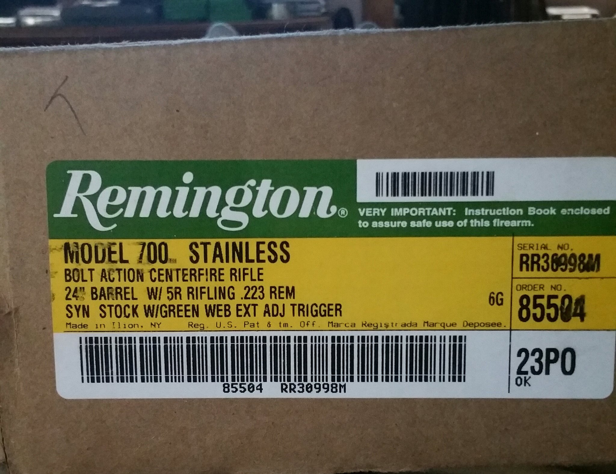

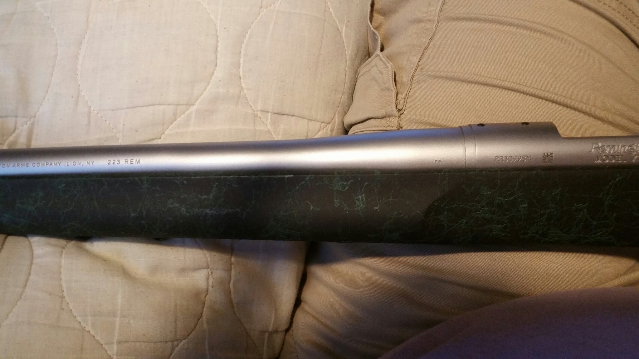

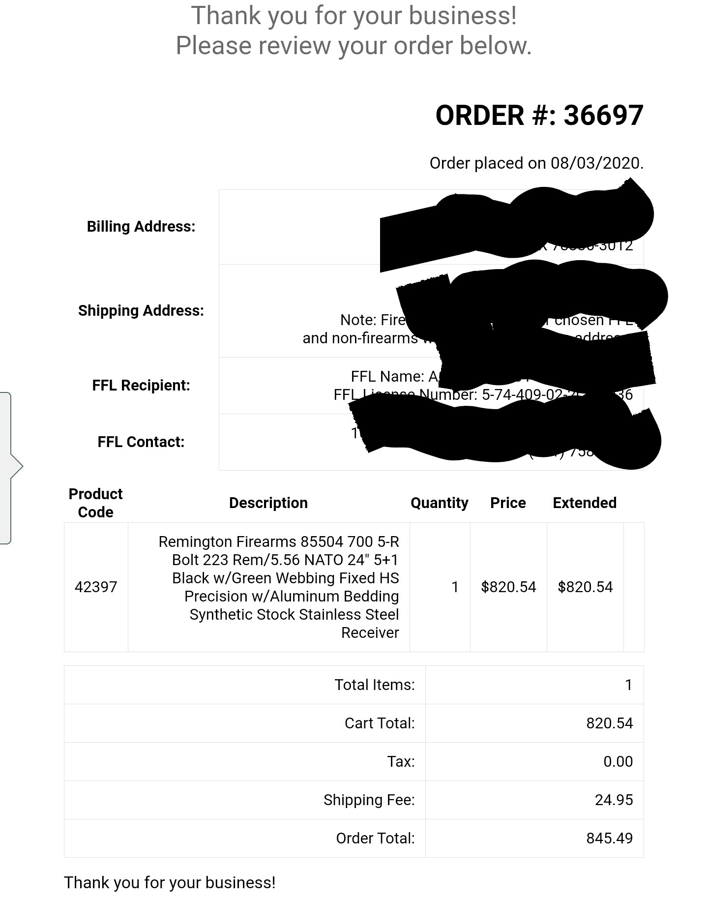

I think i got duped.
DannyBoy
Jul 21, 2020
29
7
Just got a 700 5r in today and its advertised as 223/5.56. Noticed label on box says 223. Gun barrel stamped 223. Called Rem, lady checked serial number and said its 223 only. I see this same rifle #85504 advertized to shoot both at alot of dealer sites so WTF. If your thinkin bout one of these to burn up your 5.56 stockpiles ya might do a little more digging or plan on re barreling. Got this to make spare P dog gun so i will add it to the pile, no harm. Could probably get a pull string and test some hot 5.56,s but im gonna stick with dont shoot 5.56 out of a 223 only barrel rule lol. If anyone else had this problem i would be curious to know why these are being advertised like this.

Technically it would have to be a true 5.56 or .223 Wylde to safely shoot 5.56. But I have shot plenty of 5.56 in a modern .223 "only" rifle and it's fine. My only .223 rifle that does not like 5.56 is a Ruger American. That chamber is really tight and only likes virgin .223
If you really need to shoot a lot of 5.56, and it bothers you, then get a Wylde barrel and sell the OEM one...
Biggest difference between 5.56 and 223 chambers is freebore which rem has natoriously long free bores... i bet if you measure it's likely beyond even 5.56 spec despite saying 223 on the barrel.
Pressure differences is nothing to worry about in a 700. It's steel not a thin sheet of aluminum.
If the purchase invoice says 5.56 but the rifle can't shoot it, you didn't get what you paid for. Send it back.
Normally i would but have a family prairie doggie trip coming up so needed an extra bang stick and i can press out plenty 223 loads so its not too big deal for me. I was more concerned someone not catching it and run some 5.56 rounds through it. Im sure it will run most just fine but ya never know and hate to see someone having an issue. And also keep someone from getting one thinking they will be able to run the 5.56 factory stuff in it. I would actually buy 5 more myself at that price and give em away as christmas presents. I know it will shoot fine, a new trigger, good glass-rings-base and box mag and poof!! Sweet varmit rifle😊
Reactions: blues2o
You do know that 5.56 and 223 are completely interchangeable 99.9% of the time right?
According to Remingtons website, it should have a 1/9 twist barrel.
That means that in all probability, they throated it for heavier bullets than the usual 1/12 twist could handle...therefore, it will most probably shoot 5.56 without incident.
The Rem 700 will hold pressures well in excess of 70K psi, so I'm pretty positive you have more than enough margin for safety.
Edit to add:
Think about it, do you think a company would make a gun that was ONLY safe for 223 (especially a bolt action)?...When there is about a 100% chance that someone will put many 5.56 surplus rounds through it during it's life?
Great point and i will post what i find. I have time to work up the loads for it before vacation so hoping will have some good groups and data to share if anyone should have need.
It may as well be a sales or order error, You should give them a call.
But as @Steel head mentioned, Its a bolt action. You should be testing its limits and having fun. But its your money not mine.
Quit fussing about and shoot it.
It’s a bolt action, it will easily handle the extra pressure that you’ll probably not see.
Im not fussing by no means. I raised the point because its being sold as something its not. I reload plenty so i know the drill but someone may not and press up some bad stuff and have an issue. Just getting the info out was all.
I’d be surprised if you could even get a proper 223 chamber these days without having a custom barrel made in it.

Why was it labeled advertised as being able to shoot 5.56? Because morons are allowed to run businesses too! As soon as I read the first sentences of your post I was scratching my head. I’ve never seen a 700 5r or any other 700 listed as being chambered for 5.56. I’ve also never seen someone purchase a bolt action to go through surplus 5.56. Usually they have an AR for that.... Hopefully it’s some good 69gr ammo and not bulk 55/62gr fodder.
The safety aspects have already been addressed by others.
Thats exacting why i bought it, because it was advertised as 5.56 bolt gun, and it got my brain in gear, seeing how i have thousands of surplus 5.56 brass and a primer pocket swadger set up already, so lots of quick p dog rounds. I have several AR,s but just for the family to have fun out back. Never put a penny in them and none of them will flip a doggie in the air at 600 yd reliably😊 But i will do the work to make sure everythings sized correctly and safe to shoot so will be a fun family vacation and thats all that really matters.

Must be a reason it's marked.223 and not 5.56. They might just be covering themselves for liability purposes. So if something goes wrong, you're sol. I would not accept it, unless you're comfortable shooting only.223.
