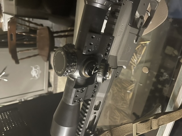

    my 3-18 rests in a Midwest Mount, I went this way because of what I read about vertical split rings. I had it in a ADM Mount briefly about two years ago. The MI sits lower than the ADM I had so it wouldn’t clear my BUIS (ARMS #40L-SP) so I put a YHM riser under the MI Mount. I had to rezero and this is where my problems started. my elevation changed but so did my windage, I could barely get on paper but I had about one revolution of wind age left. The impacts would wander, I checked everything and all was tight. I used a FAT wrench on the mount at 17 inch pounds and the bolts weren’t loose neither was the Mount.
    So today I took off the sights and the riser expecting every thing to return to normal. I had to dial down 2 revolutions to get on paper and my impacts were still left edge of a B27 style target at 25 yards. I dialed left 1/4 of revolution and I fired a shot. My impact moved up to the top of the paper While remaining on the right edge. So I have a scope problem, it’s a good thing I reached out to Vortex last week and I have a return label. I never dropped this scope nor have has it taken a ding or impact. I find it hard to believe just putting a riser under it would cause this to happen. Anyone else hear of a problem similar to this with a razor?

    I just got the scope back and the repair slip said it was a stuck gimbal, it was replaced. So I wonder if this is common with the razor 2? This is my oldest Razor 2 and probably the most used as it is on one of my gas guns. The 4.5-27 is on a bolt gun that doesn’t get used as much and it’s about a year newer than the 3-18 I just sent in. anyway, they repaired it rather quick and I’ll hit the range next week with it so hopefully I’m back up and running again.
