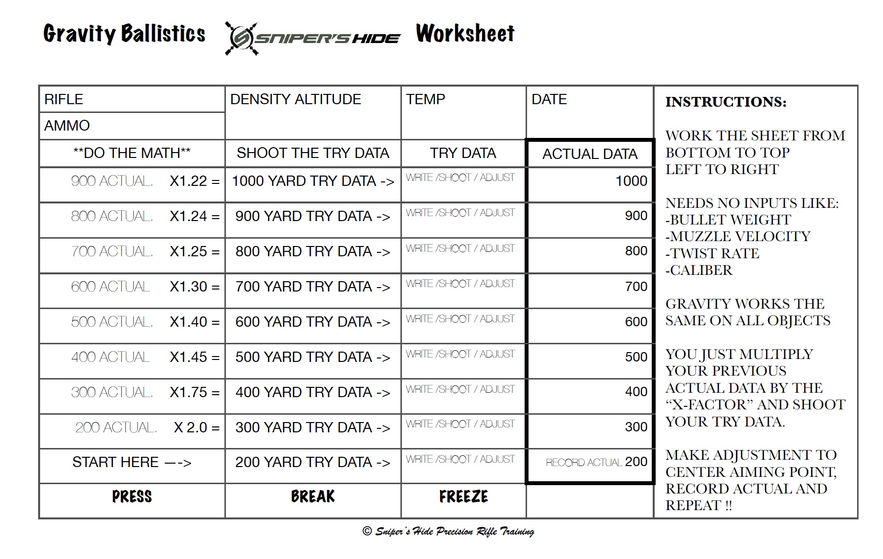

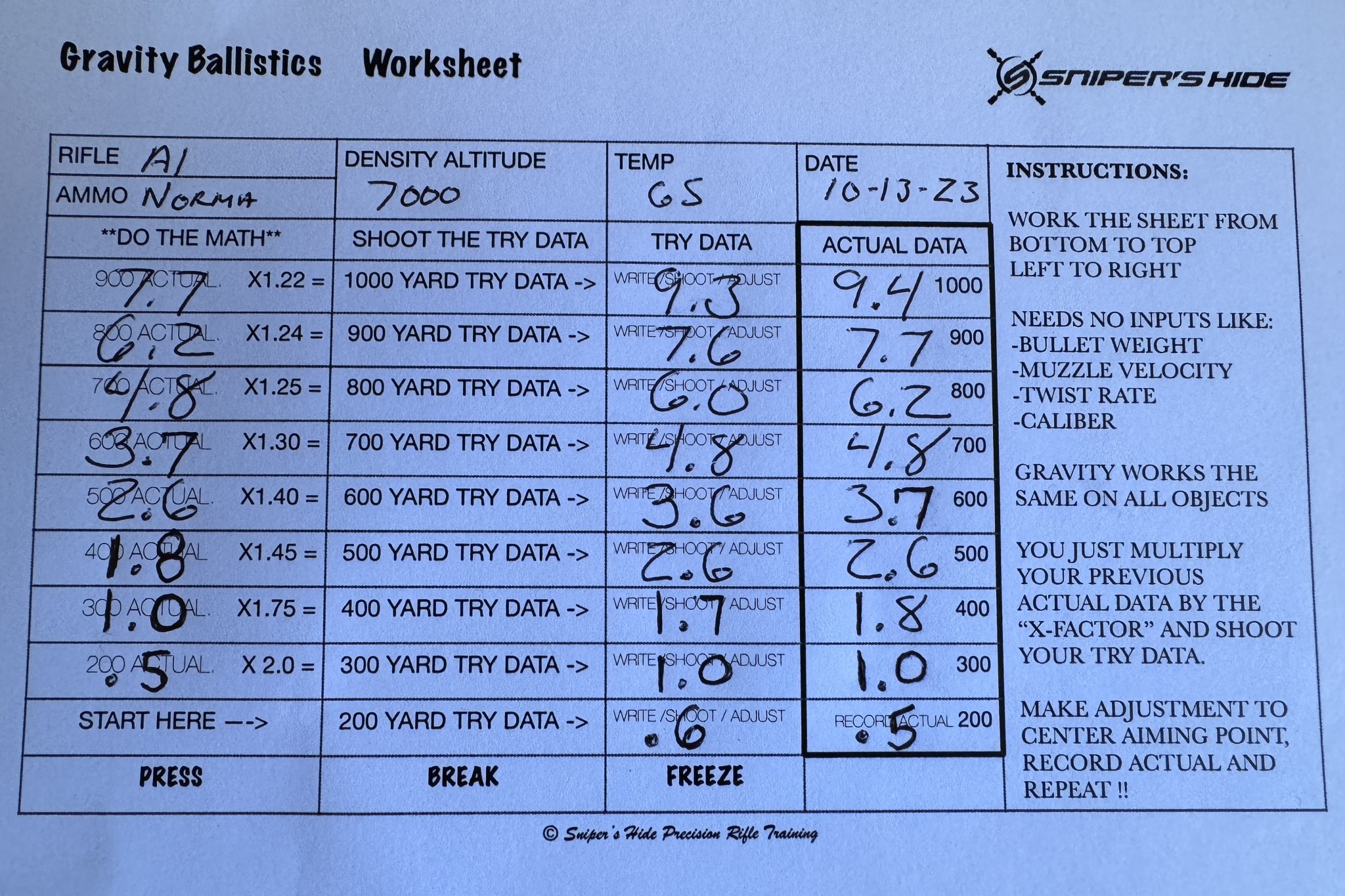

Why Gravity Ballistics is so much better,
There are no inputs, there is no chance of making a mistake by using an incorrect value.
Gravity Ballistics dopes a rifle than any other App out there.
Use this and Dope your rifle, if this does not work, something is wrong
Fill out, will look like this:
