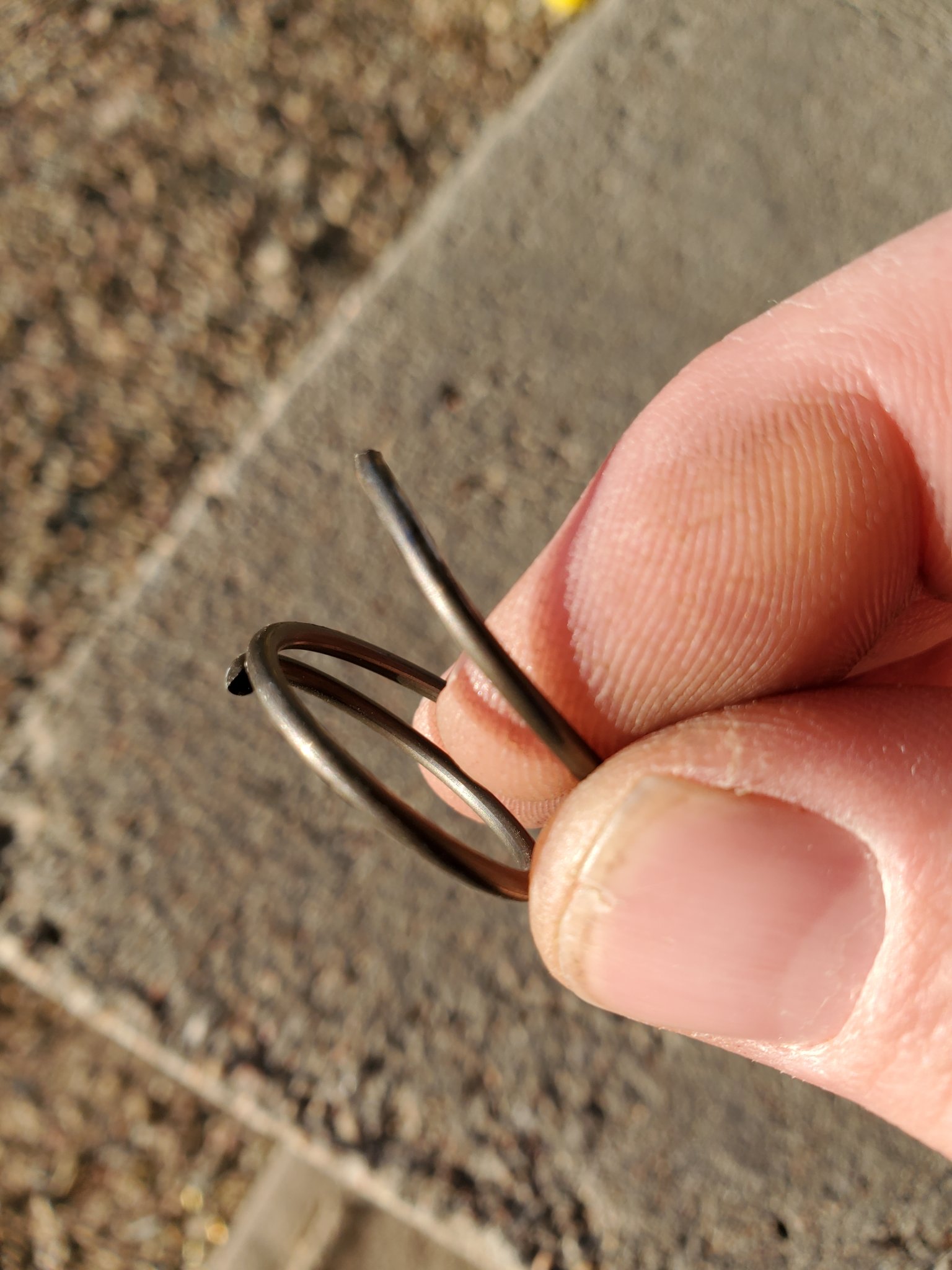

Not all action springs are created equally.
Not all LPKs are created equally. I like J&T LPKs with cadmium plated detents per the TDP, or stainless detents.
For a long time, DPMS and other small parts suppliers were selling cheap, porous, trashy LPKs with zinc-plated detents.
Doesn’t matter for the weekend plinker, but when I was shooting high-volume suppressed in the Arctic in -30˚, and my Gen 1 MIAD cracked, when I went to replace it, you could see fizzling corrosion happening in real-time on my selector detent on my RRA MLGS 16” heavy barrel carbine. I thought to myself, “Hmmm. I never saw this with M16A1s, M16A2s, M4s, or M4A1s."
