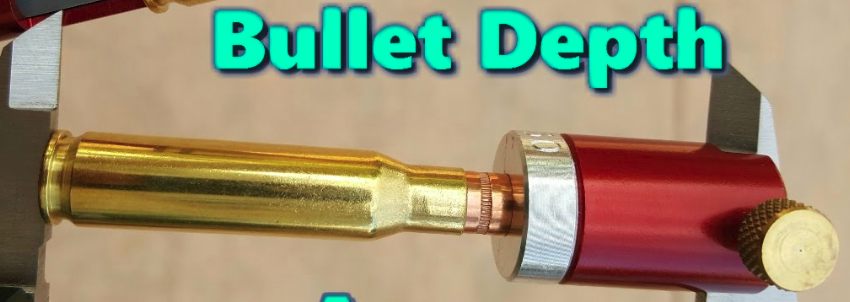

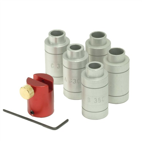

    The Hornady tools to measure headspace, base to ogive, and throat length get used a lot.

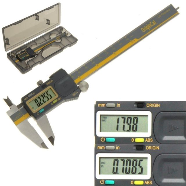

    Since you need calipers grab these igauging, better than the hornady or harbor freight calipers but not as expensive as the mitutoyos, they also offer it in 8" for 15 bucks more so that you always have something substantial to hold onto. Most people just go with the 6 though.
    https://www.amazon.com/iGaging-ABSOLUTE-Digital-Electronic-Caliper/dp/B00INL0BTS

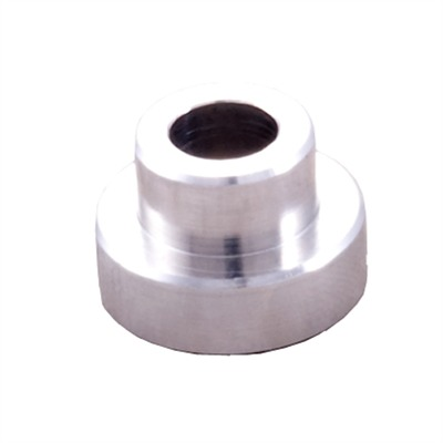

    Then the headpsace comparators that skookum mentioned are vital for precise sizing measurements.
    https://www.brownells.com/reloading...ck-n-load-headspace-gauge-tool-prod35168.aspx
    Then the bushings for the ogive bullet seating comparator. Goes in the same red body that the headspace bushings use.
    https://www.brownells.com/reloading.../lock-n-load-comparator-insert-prod32794.aspx

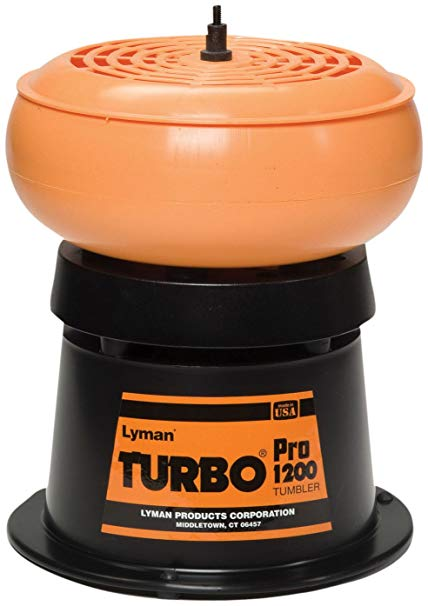

    For cleaning I just use a lyman vibratory tumbler with medium grain rice, its a bit loud but it works fine and is cheap.

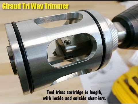

    Trimming brass is a special thing, I run a giraud bench top but thats probably hard to swallow just jumping into it again. If you arent loading for a bunch of cartridges the giraud triway or the trim it 2 are nice. They cut, chamfer and deburr which means you do three processes in one step, thats a significant amount of time savings.
    Whatever trimmer you get make sure you can chuck a drill on it, doing it by hand sucks a big one.
