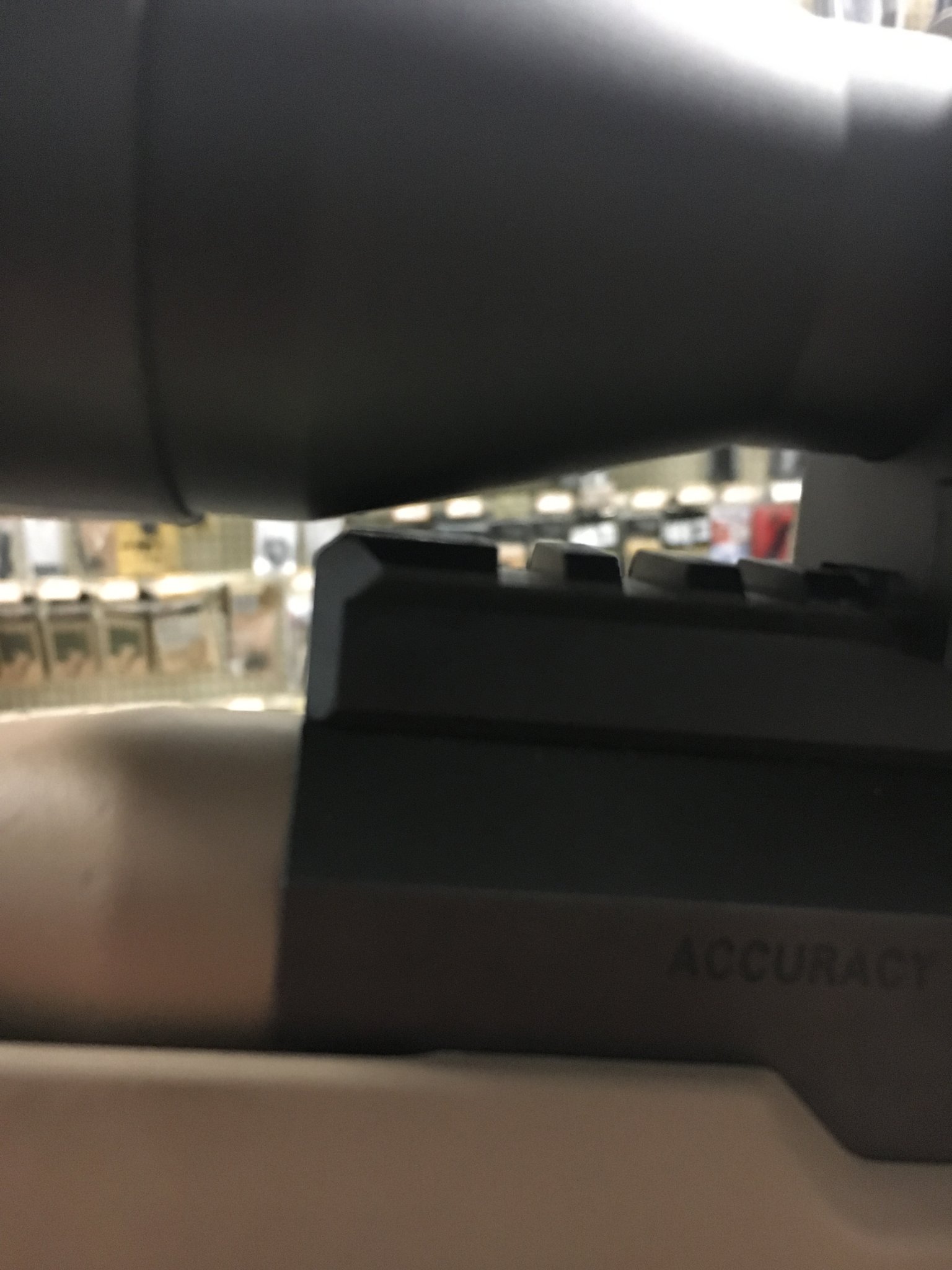

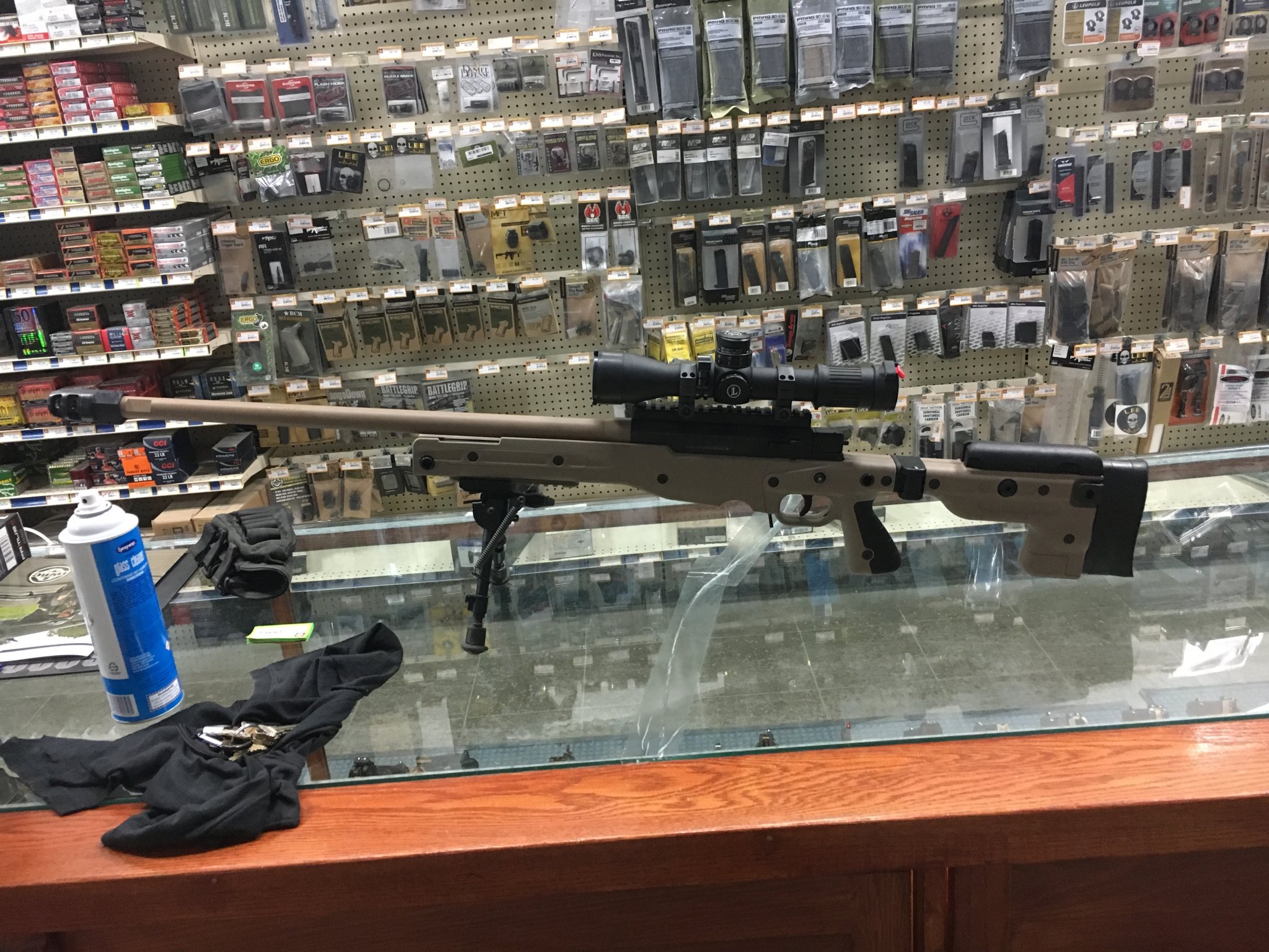

I have a NF 8-32 NXS second focal plane in mil.
I have the ability to trade for a brand new mark 6 3-18 with the h58.
I’m torn to go to the 44 from my NF, but I don’t know really anyone who wants my setup. What would you guys do? Keep the NF or go with the leupold.
I just want to get a scope I can use on more than my Sako 338.
The NF is okay but I dunno, not digging the second focal and not digging that 32 power isn’t true size.
I will probably throw it on my AI for work. 3 power would Be very handy over our NXS 5 powers. The big NF has been sitting in my closet for a while now.
I really want a S&B but this is as close as I can get for now.
Your adjustments will always match those sub tensions. The thickness of your subtentions will remain constant despite magnification. Your spotter is less likely to screw up the call. You can mil at any magnification.
Bet I can think of more once these two bottle of wine have worn off. :D

Well it’s mounted. Not sure if I like how close it is to the rail. I might have to go a little higher, thoughts?
Nice. If it clears, it clears. It's not going anywhere. I would run it if it feels good getting behind it. If you need it higher for reasons other then it being close to the rail, then that's a different situation.
Reactions: Bender
Well, it clears. Like stated above, it shouldn't be a problem. My 3-18 Gen II Razor sits that way on my AI; it's just a long rail and a short body scope. Shrug. Run it....
I’m just saying who cares what people say based on a picture. You’re the only one knows what kinda shooting you do and what your neck, cheek, head structure is like. If it fits you that high in the prone or positional who cares. ?‍♂️
Yeah you’re right. That’s why I left my work rig alone with my shit.
Sorry brah for stepping into something different. Didn’t mean to rustle your jimmies.
Looking for opinions on the setup, thanks for all your help!
I always try to run mine low. But I don’t run NV either. I think they look silly if they are too far above the barrel.
