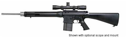

You might want to look at this one.
DPMS 308 with a 22"Shilen Match barrel. Magpul buttstock, Troy rail system, low profile gas block, JP trigger. With or without the Leatherwood M1200 scope.
