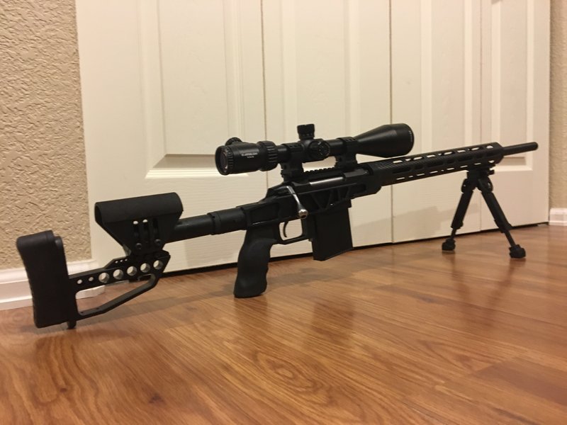

I have a TL3 in a MPA chassis. Only cost me $700 for a shouldered 223 wylde barrel and I have a 223 gun. Cheapest way to have a competition gun and training gun. And a hunting pencil barrel gun. And a f class gun. And a 2 mile single feed gun. They all cost $700. And SAME SCOPE. ULTIMATE CHEAP. just saying.

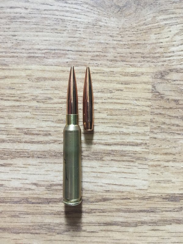

I went with the 75 amaxes as well for my tikka 223. Haven't got any time behind it yet tho.
And i I am in love with the 6x45, it's an amazing round. Not well suited for the truly heavy weight bullets but I really like the 58-75 vmax.
Sorry for the delayed reply.
It's a 90g Berger VLD. OAL is 2.680".
