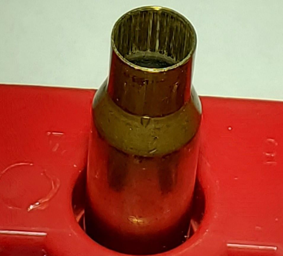

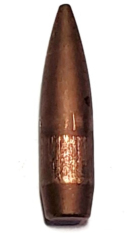

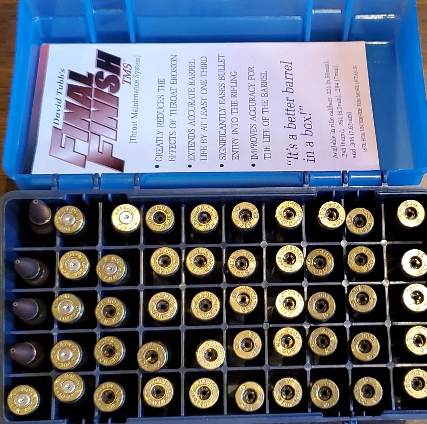

Yesterday, I took a look at the 4 remaining cartridges of Tubb's Final Finish bullets I loaded 6 1/2 years ago. Because of Tubb's coating on the bullet, not doubt it's not going to be the same as a bullet without the coating. But I was curious given the amount of time that's gone by.
There appears to be a little corrosion on the neck in the form of some whitish lines that corresponds to some whitish that can be seen just below the neck. It's something I've not seen before on cartridges I'd disassembled after several days from loading. I tried to get a good picture (see below) of that below the neck, but it just didn't show up as light as I would see it. It's not bright white, but it's there and only from the neck-shoulder junction down to the level of the powder.
Now that I think about it, I should've used my bore scope for a better picture. :rolleyes:
To removed the bullet, I put the cartridge in my seating die and pressed down to see if it would pop as an indication of it breaking free of being adhered. But, I didn't feel any of that and when I pulled the bullet with my Hornady collet puller, the bullet came out with no unusual effort. That was different from my cartridges that had sat of 6 months that had been seated in clean necks, where seating them lower did take a little extra effort, including an initial pop movement.
