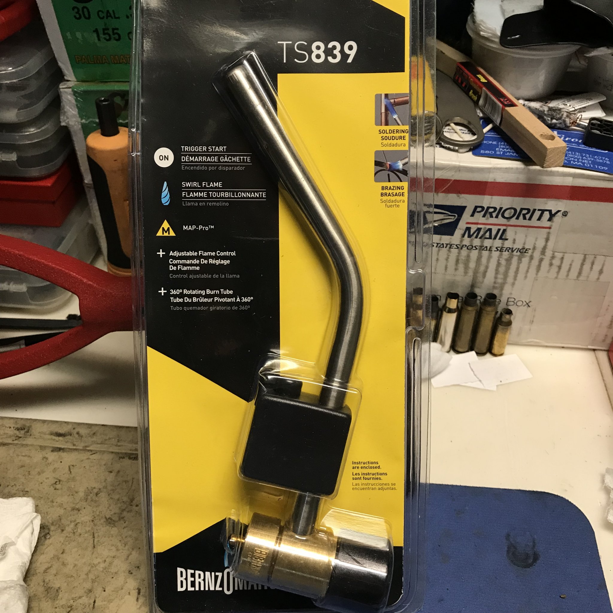

I started with the drill and socket, and migrated to a Benchsource and never looked back. Did pick up a swirl flame torch head with broader flame pattern, and only use one torch/tank for all of my work. I anneal everything I shoot now, as it takes little time, and is assurance of uniform shoulder setback and brass temper, and why wouldn’t you want an AR to shoot as well as your bolt gun? SD’s and runout have improved, almost eliminated flyers and accuracy is more consistent across the board. With chambers varying a good bit, especially in Grendel variants, pretty important to match bump to chamber, with consistent.0015-.002 bump without issues possible with proper temper. I use 750 Tempilaq as well, to establish baseline.
