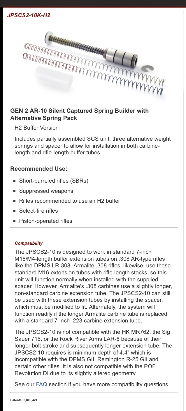

Do I have to order the Tungsten weights separately or does it come in the JPSCS builder kit ?
Not if you order the "HEAVY" version...then just buy the SCS Alternate Spring Pack AR10 seperate....
This the model I am ordering
Honestly all you need is the 10H2 SCS. But if you buy the builder kit it comes with everything you need SCS +3 springs of different weight and a spacer if using an A2 extension. I run an H2 witha Full Mass BCG and H2 Bolt. no issues ever.
One thing that is not included and is not required, is a retainer pin for the SCS system, but if you want one the part number is JPSCS-BRP
